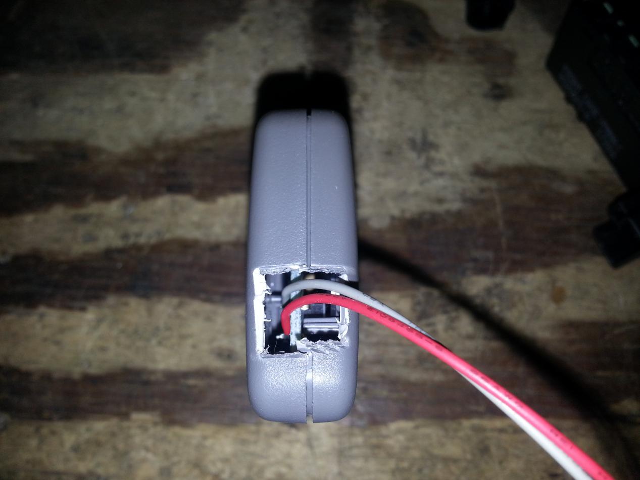

Our '04 had homelink and I didn't realize how much I hated looking at the garage door opener hanging around the car. Can't believe a $52k suv doesn't come with it but what are you gonna do? The console is in the $250 range and this cost me $10 with the switches. This was what I came up with...
1. Open up your garage door opener. You need to test and find out which contacts make a connection when you push the button. Mine is a craftsman so you could assume it is the same but test at your discretion. Now solder one wire on each contact. (Pic 1)
2. Notch the garage door opener case so the wires don't get pinched and run them out. (Pic 2) I soldered 4 wires but only took pics while doing the first set.

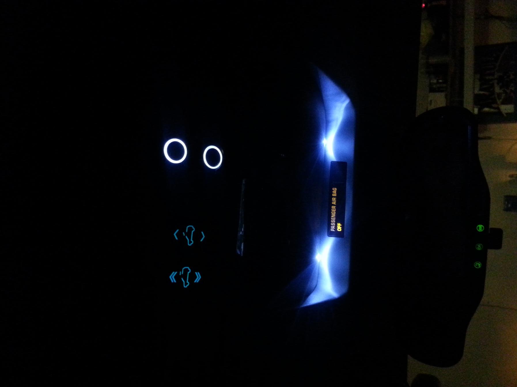

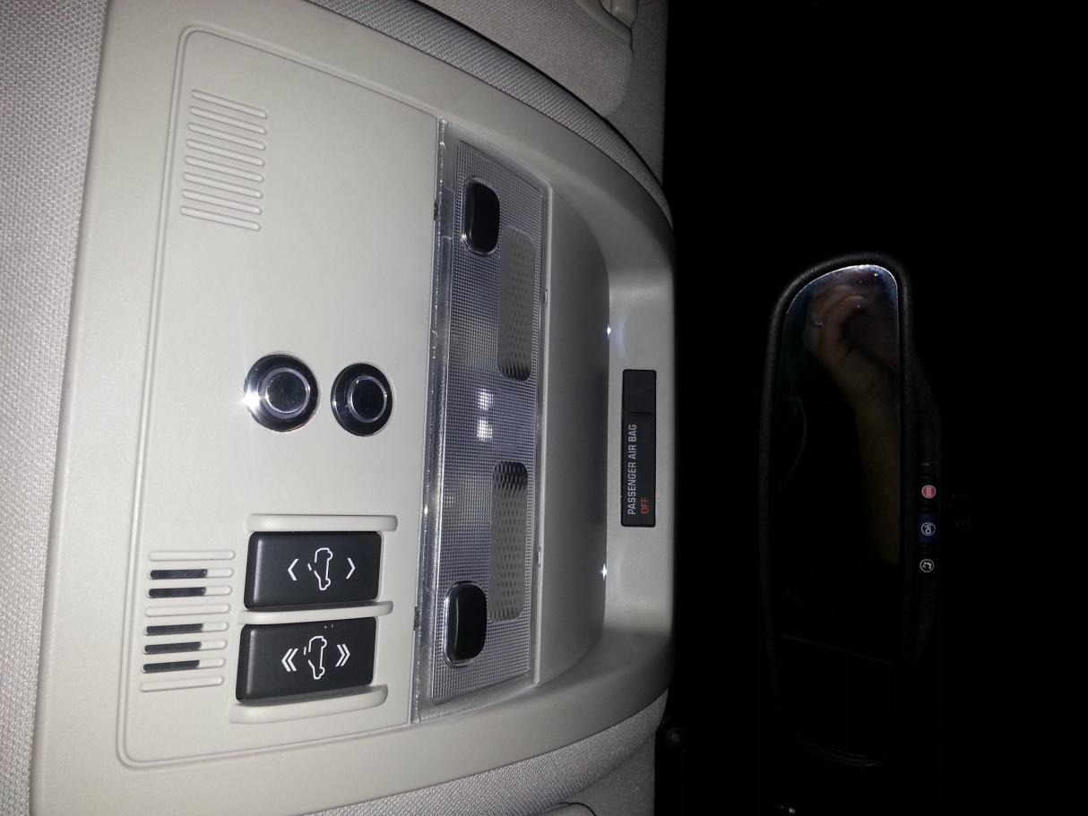

3. I used valet buttons from an alarm temporarily until my lighted switches come from China but you can use any momentary switch. (Pic 3)
4. Find a good spot to mount your switches and hook up the two wires from the garage door opener to the two contacts on your switch and tuck the whole thing in the ceiling and you now have a built in bootleg homelink. (Pic 4 + 5)

So you just stuffed the whole opener up into the console? What happens when the battery in the opener finally dies?
You take it out and replace it like you would have to anyway. It's only two screws...
Really how often do you have to change the batteries anyway?
