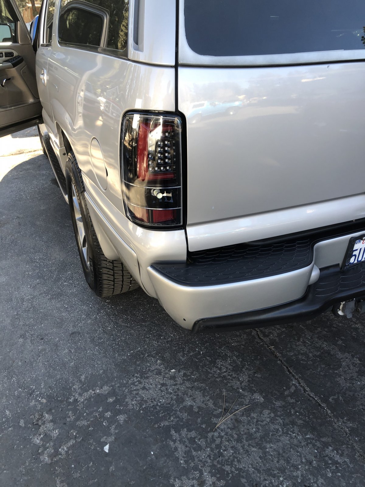

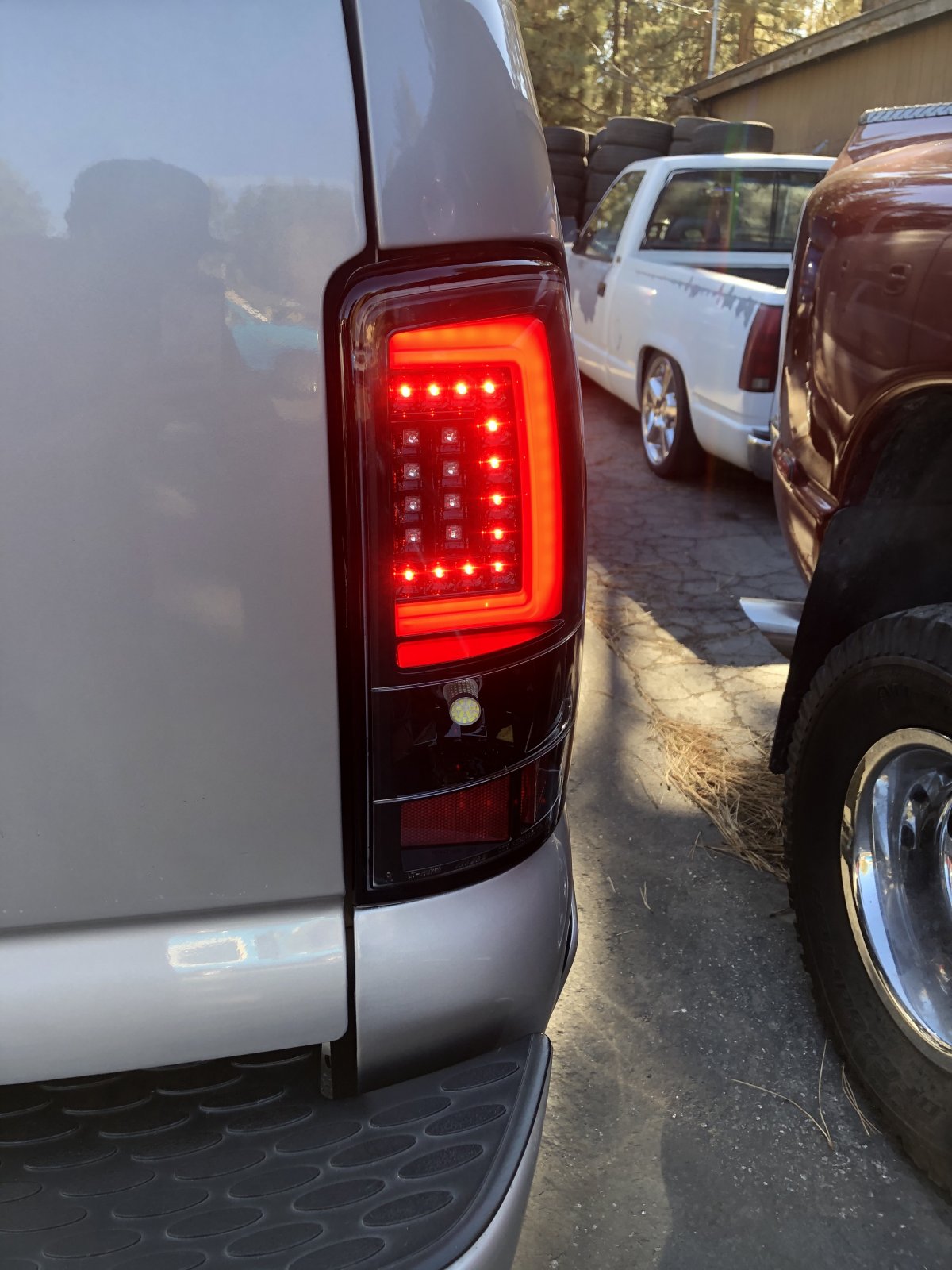

So ran these tails on the truck from November to February, but my cruise control never worked with these. I was not happy and driving from socal to Utah with no cruise control absolutely sucked....
7DCD6570-51CE-49F8-B5D9-CCB96D400269.jpeg 0615A1B2-5186-4C9F-B844-4465CBE42F18.jpeg
After I got back from that trip I messed around with resistors in all different setups and couldn’t figure it out. But I wasn’t going on my March mammoth road trip with no cruise control so I threw my original C LED tube tails back on. Been rolling around with the old chipped lense since and it’s been bugging me. Even tried another set I picked up and it was still a no go. So I sent them back and got a refund. Irritating. But I was finally able to figure out why my cruise didn’t work with the newer tails. I swapped the pigtails and plugged the brake lights into the turn signals, and turn signal/running light into brake pigtail and my cruise control WORKED! So the LED tube in these newer tails also comes on during the day as a brake light with the other C shaped set of individual LEDs that are brake lights. It dawned on me to wire in an extra set of resistors into the turn signal/night time running light pigtail. Had to figure out which of the three wires in the pigtail went to the running light and which’s as turn signal but after some google searching some schematics I learned it was potentially the brown wire, and wouldnt ya know that was the trick! Buttoned up the wires and connections and put everything back together. Stoked that I got these babies functioning all correctly cuz they look really badass! 09AE5EAF-DE28-4522-8D79-2D7B8348A84F.jpeg 413BCE3D-C78D-40BB-B36D-94A835923E70.jpeg
