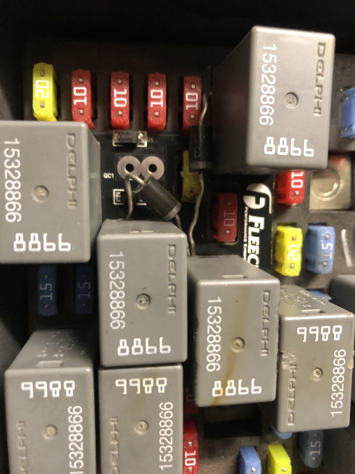

So after much dragging my feet I finally ordered a fleece module for the 4-Hi or whatever it is mod. Lol. Which I wasn’t aware that actually needed to do in order to correctly have my morimoto bi xenon projector and HIDs function correctly. But now they function correctly. I’ll admit, I wasn’t as sold on the HID and projector retrofit at first, but they perform pretty awesome at night now that I’ve gotten used to them. Also now having my fog lights on with my high beams should be nice. I still had to keep the two diodes in place between the relays to keep my DRLs on with both headlights as I have my LED running lights in the headlights tied in to the DRL but I still want them on at night. Anyways that’s all done. The headlights need to get adjusted though. I’m not impressed with anzo’s u bar headlights. Which really irritates me for how expensive these headlight housings run. Plus the inside corner of the housing is super loose and wiggles around. I can’t seem to figure out why....

For the record I peer pressured you into getting the fleece chip. I’m a bully , which is weird cause I was the one getting bullied as a kid :Wedgie:
