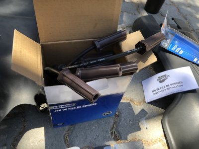

picked up ACDelco platinum plugs, and figured I should probably do new wires as well so I grabbed those from the parts store. Grabbed dialectic grease for the wires and anti-seize lubricant for the plug threads from the parts store as well and got to it today. I thought it was going to be a difficult job. It wasn’t too bad surprisingly. I was terrified of the pug on cylinder #8 as everyone says that’s the worst one. It was challenging but I actually got it out fairly easily and got the new one in as well. In my opinion, I thought cylinders #1 & #3 were actually quite a bit more difficult as they were right under the alternator bracket and the positive battery lead. Unbolted the bracket, which also is where my catch can is mounted. Moved it out of the way and got enough room to get in and get those two plugs out.

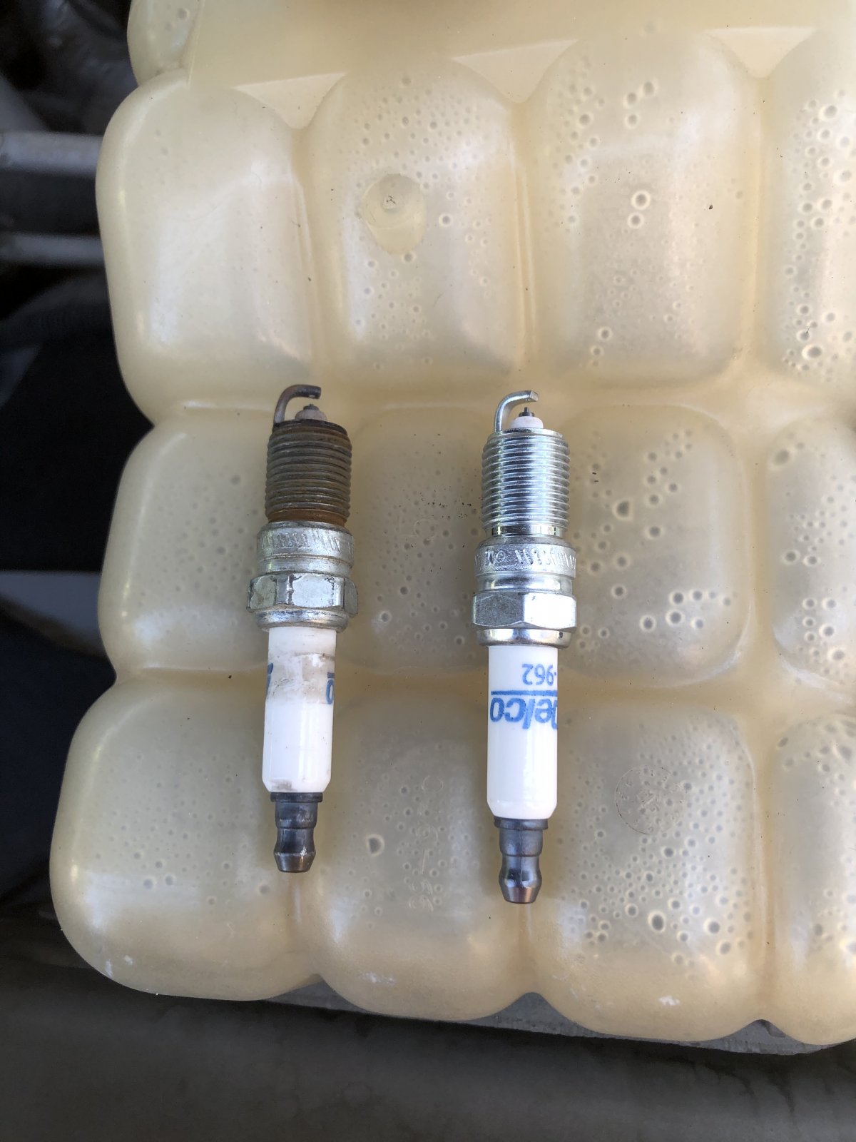

mold spark plug compared to the new one:
Not as bad as I thought it would look, especially considering I had a pretty bad oil leak last year that took a lot to get figured out. New wires: 5A00D65A-A6E6-4A82-813F-F0E649BED9AB.jpeg

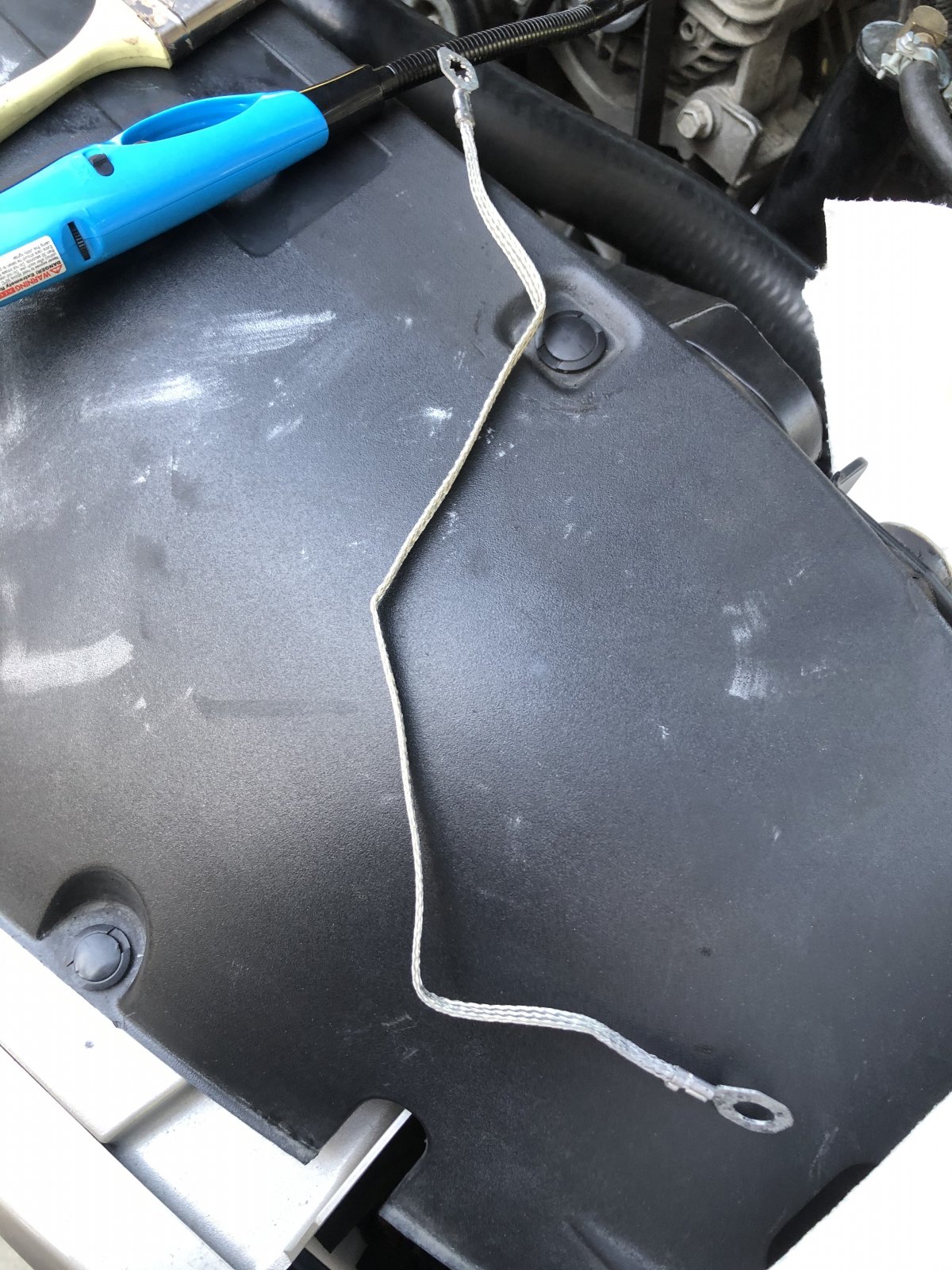

Only thing that went not according to plan, was when I went to undo the bolts holding the drivers side engine cover down, I accidentally knocked the ground cable that goes from the firewall and attached the underside of the hood. It just about disintegrated.... thankfully I was able to call the parts store and he’s like yeah I think I have one that’s long enough being yours in with you, and sure enough I got there and it was just about the same length. And mine had play in it so I knew it would work. 3FA41755-0534-421C-9498-8F87DEF7102D.jpeg
And the new one: 44ECCD06-5EE7-45E2-8419-B789B9D3F921.jpeg 12D2AD8D-545F-41A8-BB87-0AE50323C994.jpeg
Cut the factory tape insulation off of the wire loom on the old on, wiggled the new ground into the factory wire loom Andean fresh electrical tape over the split in the loom just because it satisfied my OCD. lol

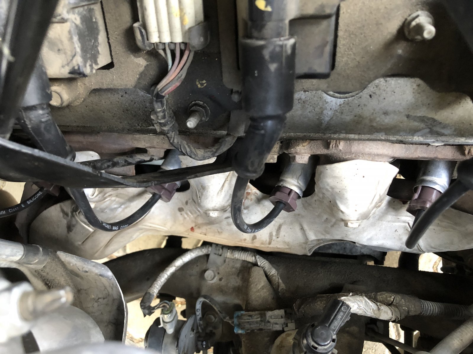

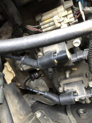

Plugs and wires all put back together, drivers side top photo, passenger on second photo
2AD56863-2938-4046-86A3-0B48F1A9E30B.jpeg 66B9A957-3DC5-441D-BDA6-A3D8ADAB0305.jpeg
I was worried about not getting the wires connected back up properly, but thankfully these rigs are pretty dummy proof when it comes to the spark plug wires. As I wiggled them back into place I felt a slight click with each one and thought that’s gotta be all the way in. Lol. When they got done the last time #8 cylinder plug didn’t get out in right and t was misfiring slightly at certain throttles and I could tell right away. Our family friend fixed it of course. So I kinda knew what to expect when I fired him up afterwards if I hadn’t done it all correctly. But thankfully, Buttoned everything back up, took him out for a quick test ride to make sure and he’s firing on all cylinders as he should be! Maintenance item handled so I’m happy. 1150 miles overdue but that’s ok. Not a big deal. Lol 2AEE6382-7016-40AB-A4A8-CE53C9D9222E.jpeg
