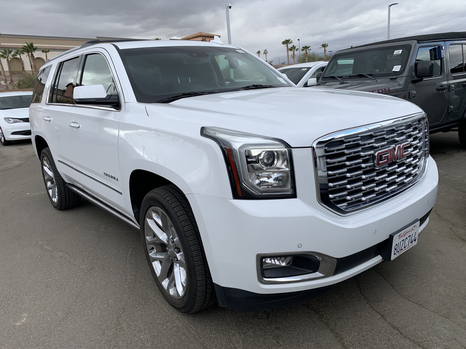

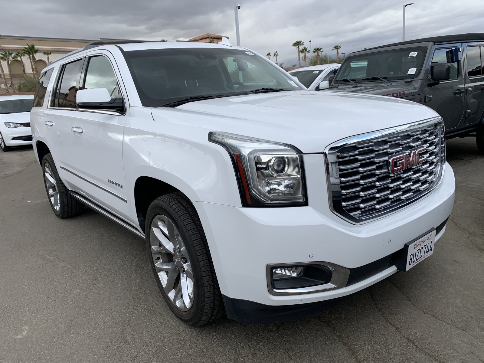

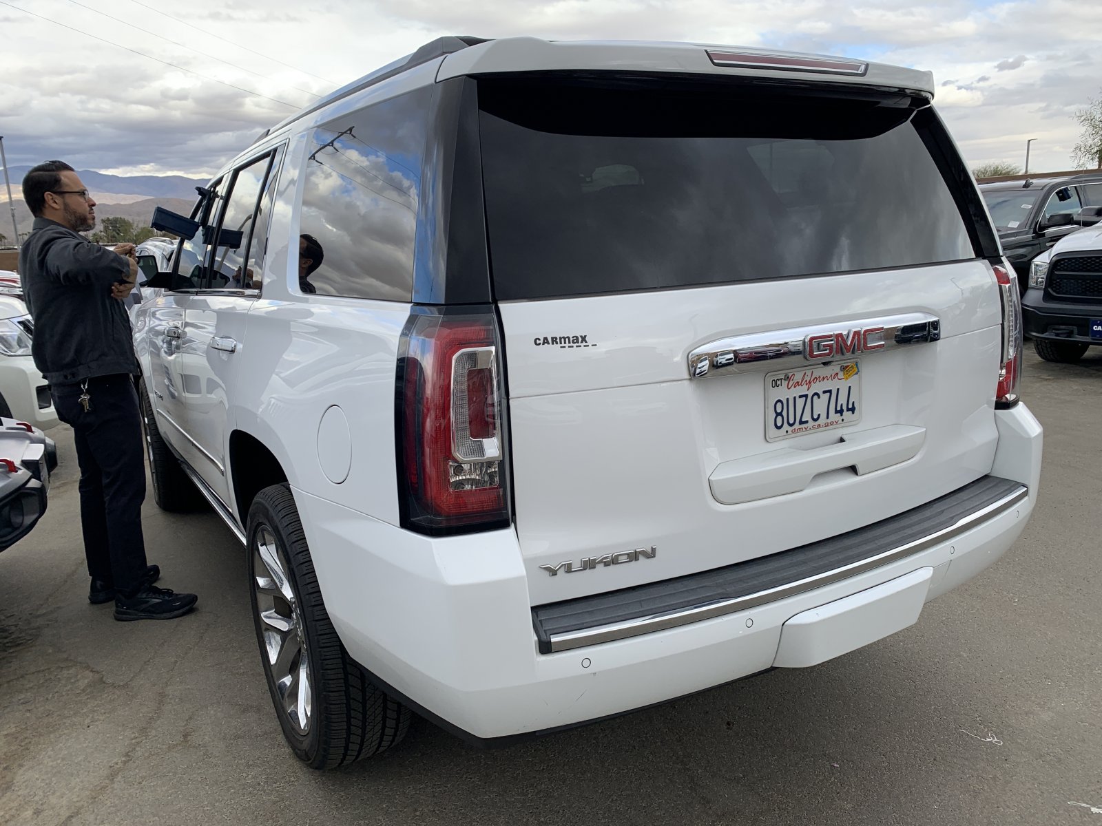

Thanks Joseph! I only have two pics of the Yukon taken on the dealer lot. I am picking it up tomorrow. On the CarMax web site for "Features" this one was rated a "10" and described as "Loaded". It seems to have about every option possible. So, I bought the full extra warranty.
