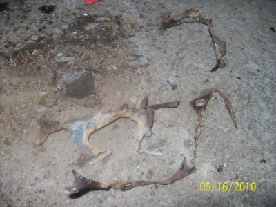

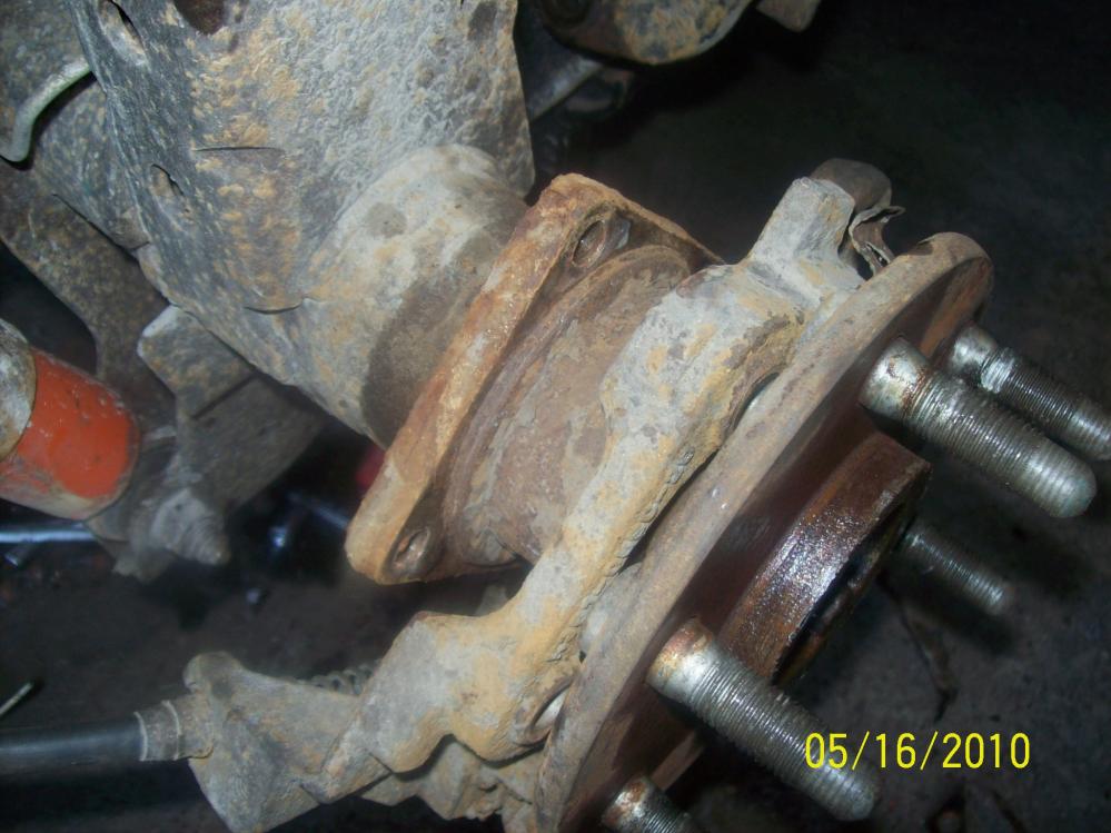

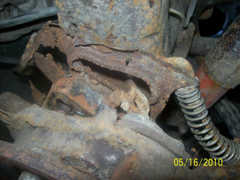

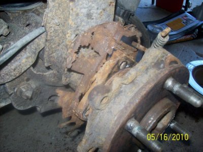

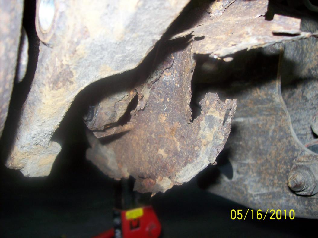

Rotted?? you haven't seen rotted!!!
I just got this vehicle about 2 months ago. I knew there would be things to do to make it a decent ride for my wife, but not this. the backing plates were non existant, as well as the parking brake shoes and all hardware were gone. both rotors are warped, and both outer wheel bearings are loose. so I started this project with the intent on just replacing wheel bearings, but will end up with new backing plates, wheel bearings, seals, parking brake shoes, hardware, and rotors...LOL bout 350.00 later, doing it myself, i should have no more rear end problems...LOL Great job with the posting on how to replace these, i found you trying to figure out how to remove the axle shafts. without your post I would be stuck at that point. so again, GREAT JOB AND THANKS ALOT. Here are some pics after some of it is apart...you can see hardly any backing plate left to speak of.!!
