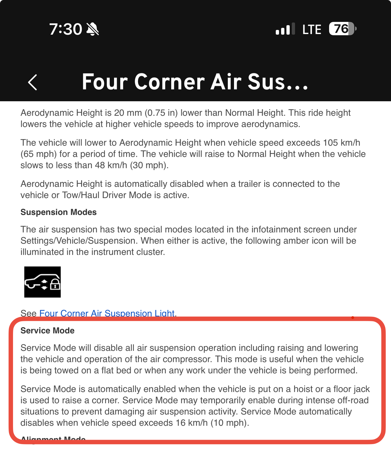

I just played with the air suspension/service mode. I put tahoe in 4 low, which allows max height, then selected service, this gives me a locked icon on the dash. I feel comfortable sliding under the truck.

I want to change the oil on my 2025 Yukon with air ride suspension. Can I raise the vehicle to the max height, put in park, then lay under it to change the oil? My concern is that it lowers itself while I'm under it and crushes me. Is there a way to do this safely without placing jack stands under the vehicle? I can't find information on the "Service Mode" in the owner manual. Would service mode be the way to go? Everything that I find on a forum search relates to service mode being used for brake pad service.
