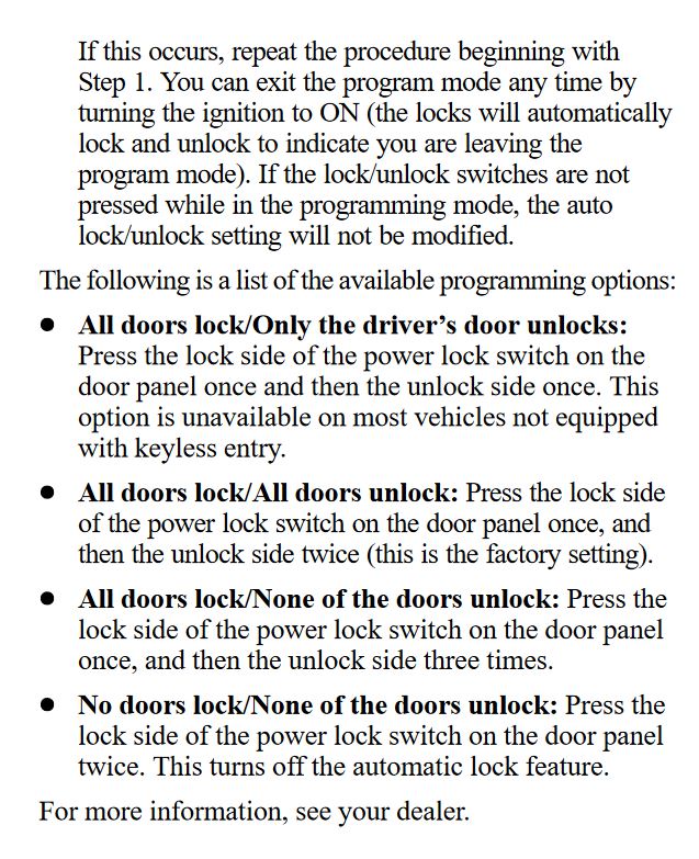

You can look at the manual online.
I read an excerpt from a silvy manual and it detailed the process but doesn’t sounds like what I’m trying to do. But it also doesn’t sound like this truck is capable of the multiple different lock and unlock scenarios like my truck is. Here’s the excerpt I read on GM-Trucks.com in a thread talking about this topic that I found searching google.
