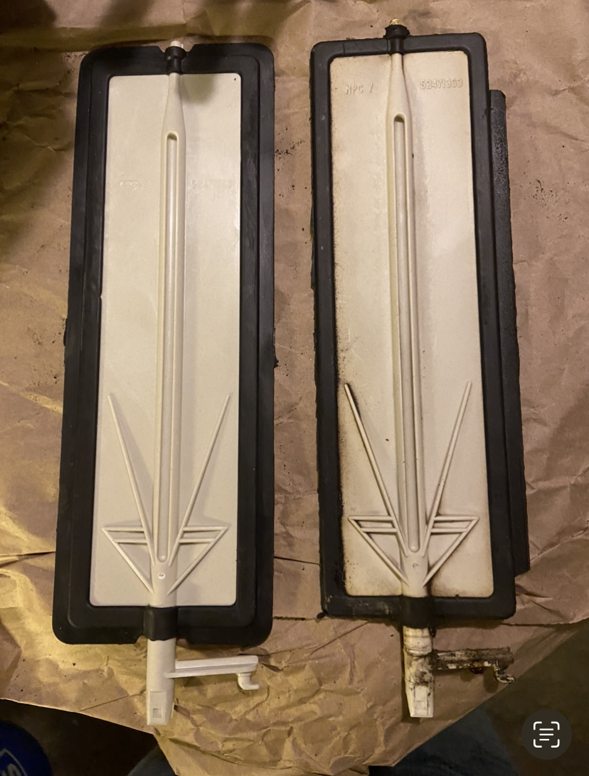

There are foam gaskets thru out the hvac and turn to dust. Air will blow or leak out at those points. Does the fan work on all speeds?
You bring up a good point about air leaks.
phatz_hatz, if the dash vents are selected does air leak out from the center floor vent? The dampers have a rubber perimeter seal that eventually rots away and causes air to leak out. That definitely decreases air flow from the dash vents.
The picture below is one of them - the new GM part is on the left and the original on the right.
this is I’m not to sure about I’d have to check if i recall from last time i was in it i think it’s fairly faint but does come out the middle with dash vents only on
