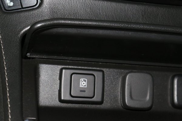

I have a 2017 Denali which comes as standard with a "cooler" in the center console - which is great and is activated by a push button switch.
The problem I face is that I have to remember to switch the cooler on every time I want the "cooler" to work, this is especially frustrating when I'm on a road trip when I stop the car to sightsee etc. I have to remember to push the switch again every time I get back in the car.
Is there a way of "reverse wiring" the push switch so that it is "on" everytime the ignition is on and "off" when the switch is pushed.
That way the cooler will be on all the time - which is what I want as I only use it for drinks as it gets pretty hot here in Abu Dhabi and I'm getting bored of hot "cold" drinks.

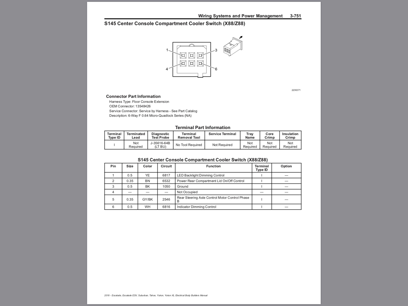

should..... be fairly simple, first you need to access the back of the switch used to turn it on, then you need to determine if it is a just a ground bump (like the tow/haul function) or it if requires voltage to activate, if it requires voltage connect a relay and toggle switch so you can turn it off when not in use or switch it back to normal mode, if it takes a ground bump you still run constant power (also with a toggle switch) and just hit the button to activate it one time and your good till you turn it off or toggle the switch back to normal.
even if this worked you may still run into to issue's where a vehicle start drops the voltage too much and it shuts off anyway

Here’s the pin out for the connector to the center console cooler switch.

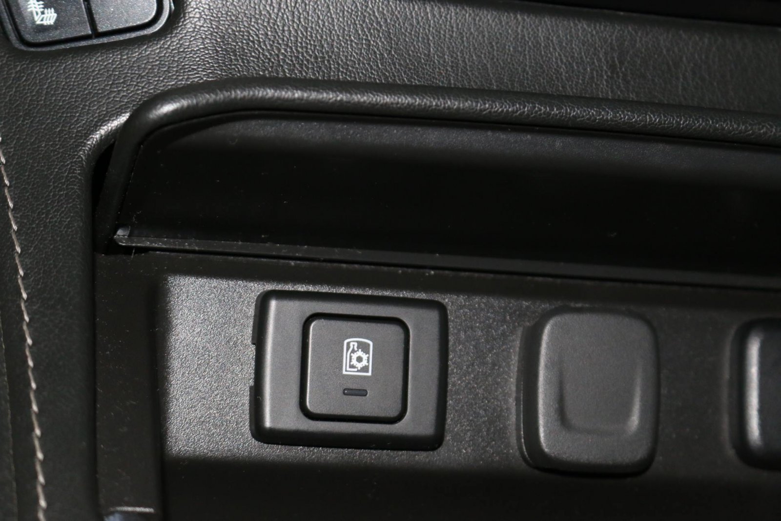

I recently purchased a Pre-Owned 2019 Tahoe Premier and there's a Center Console Cooler. I switched it on (the light on the switch comes ON) but even after 30 minutes I can hardly find any cooling. Only the metal plate on the inner wall inside feels mild cold. I had tested it multiple times and I found the same result everytime.
Just curious, if this is the same that you experience or you really get things cold inside?
The manual says don't expect any chilling, but I was expecting atleast moderate cooling.
Any response will be appreciated.
