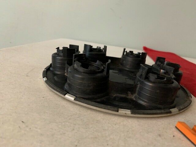

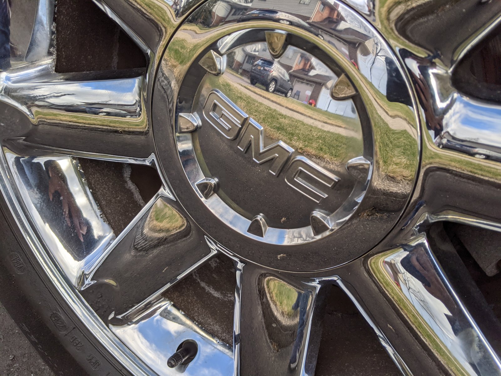

It somehow did fit 2 of the wheels. So I've attached a picture of what it's supposed to look like and then the one where it doesn't fit.

Yup,... when you have the center cap style wheels, you have to use the UNcapped
lug nuts
Those cosmetic "capped" or enclosed lugnuts just won't work under
that center cap...
They make just a plain jane 'open' lug ... that is what you need
I wouldn't put on any of the center caps until you correct this, otherwise
you'll prob lose the center caps

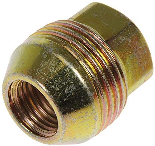

They can also be individual caps like these that thread over the lug nut and then the stock wheel will have a smaller center cap that does not cover the lug nuts. The pic that @Fless posted is a design that IMO is a PITA to work with. I dealt with these on my vehicles and in my shops and more than once came close to throwing them against the wall.

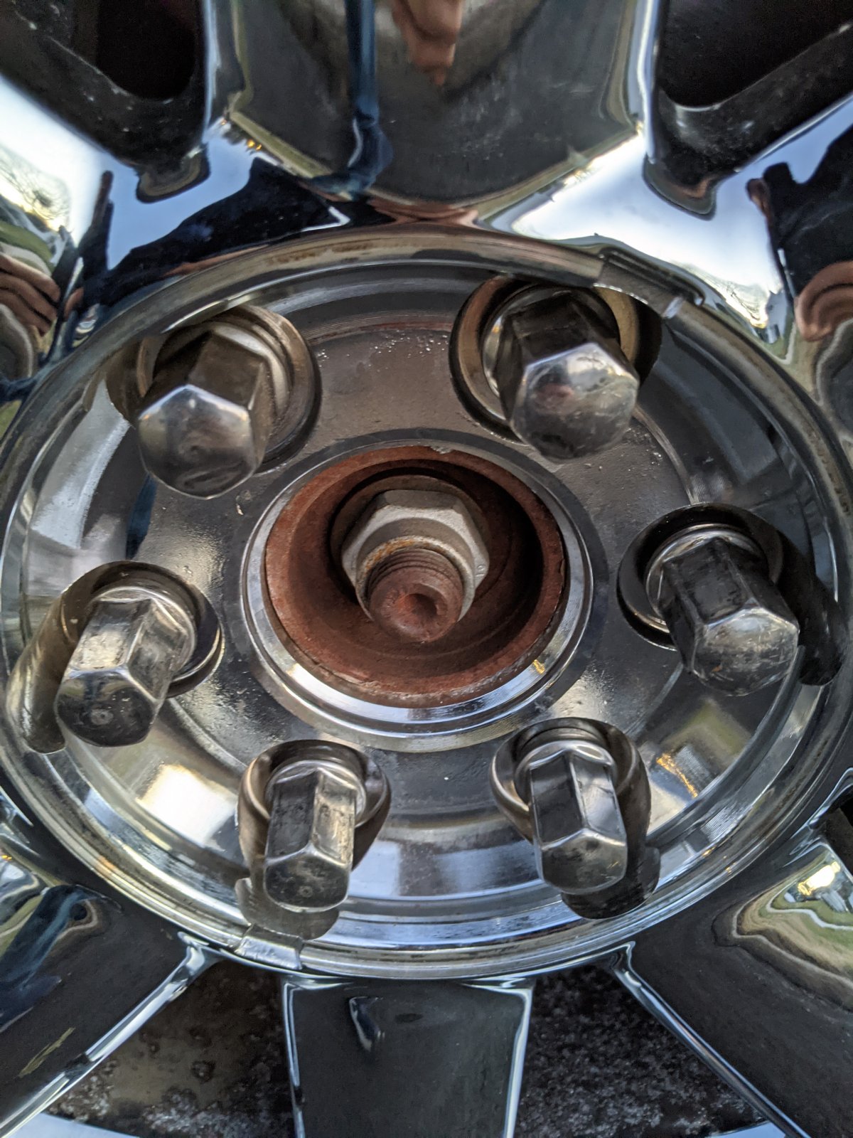

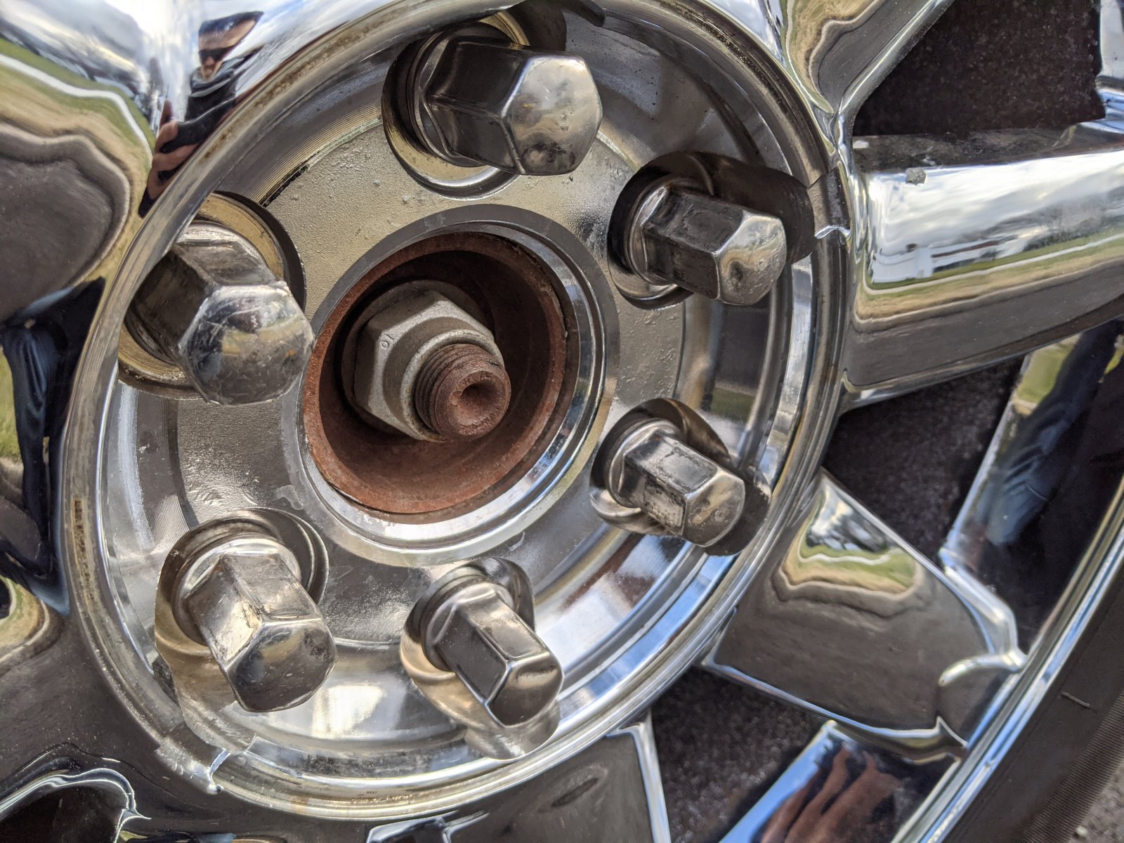

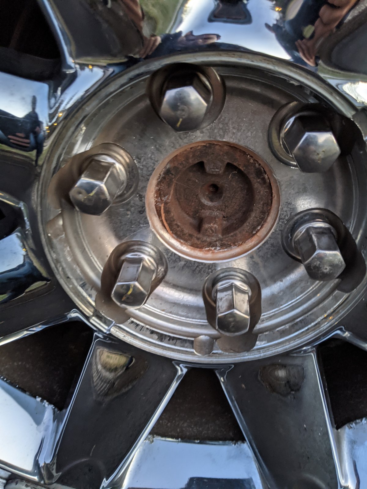

As the caps are off, I am taking a look. My rear wheels don't have a center bolt and the front do. What is that?

The front is the threaded stub of the outer cv joint that is sticking thru the front hub bearing and the nut is there to hold it all tight. There is a shaft and an inner cv joint that splines into the front differential gears. That means you have 4wd. At the rear you are seeing the center cap area of the rear axle flange and there is no cv joint there but the other end of the axle is splined inside the rear gears.
