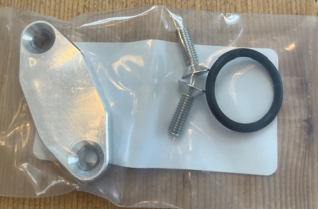

Someone suggested one of the AL machined plate setups. This showed up today.
I'll install when it stops raining.

View attachment 421697View attachment 421698View attachment 421698
I took the OEM plate off today. Noticed a nick in the gasket, maybe that is why the leak.
I installed the new billet AL plate but used the original bolts. The supplied bolts/screws had 1/2 the threads. Not good. I'm also not sure about the volume of the cavity for the O-ring but it went together and felt like it bolted flat. Considering the short bolts I would not give this kit a high grade.

The one on your engine has the boss for a manual gage line. None of the plates leak with correct gasket in good condition.
I'm now thinking these AL aftermarket plates might affect oil flow in a negative way. As you suggest a new gasket using the existing stock part is probably what I will do.

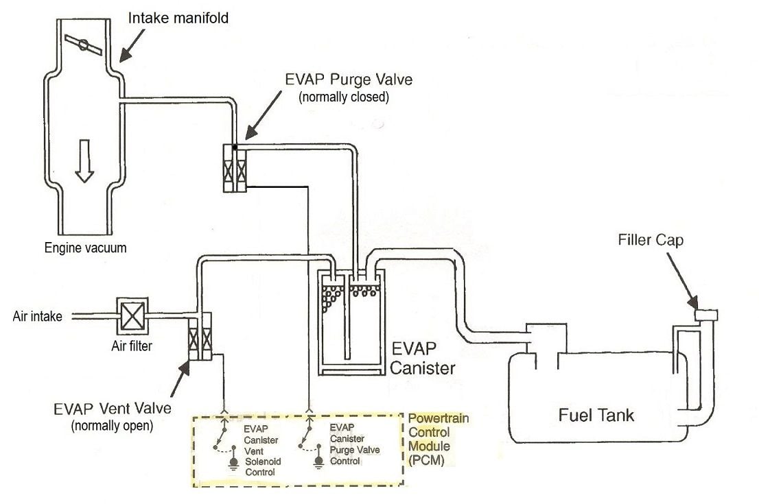

More on this - What does a purge/seal test do?
Essentially it tests how tight the evap system is.
First, it closes the evap system (including the vent valve, fuel tank, canister, evap lines, etc.) except for the purge valve on the engine. With the engine running the purge valve opens to allow engine vacuum to draw down the pressure (pull a vacuum) on the closed system.
At that point a system without big leaks should cause the fuel tank (or system) pressure sensor to sense the pressure change (going negative as vacuum) and report it to the engine computer, and vacuum should continue to build.
Once the purge valve is commanded to "seal," the entire system should be closed, and only a small bit of vacuum decay should happen over a little time. The changes to the negative system pressure (e.g., decreasing vacuum) should be reported by the fuel tank pressure sensor.

For general reference... I think our layout is something like this.

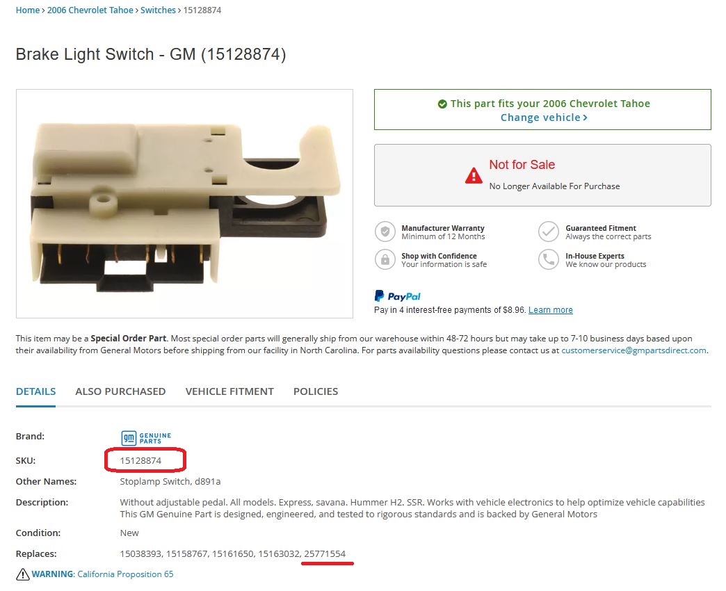

Minor update. I'm still waiting for the EVAP drive cycle(s) to complete. I don't see any new codes. Today I replaced the brake light switch with a new one (not OEM) it looks like they are NLA.
I used a new 2007+ clip to hold in the switch. That clip has a feature that might help get it off next time around. Until you get the hang of it - getting that clip off is a PITA.
