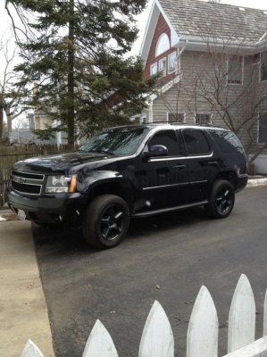

Just finished the install of the CCM 2.5/1". Got some 285/55/20 toyo open country at II extreme's coming on Monday. ImageUploadedByTapatalk1361037618.714832.jpg

Got the tires put on on Saturday. Slight rubbing issue on the passenger side, nothing minor trimming shouldnt take care of.

I like those...but I would chew their tails for putting the weights on the outside!!!

With these guys, I'd be knocking heads if my wheels had hammer on weights on them...and on the outside, buh-bye wheel finish.

yeah I was not happy when I saw the weights on the outside. I asked them to put weights on inside but they said they couldnt for some reason. So now I get to repaint this weekend.

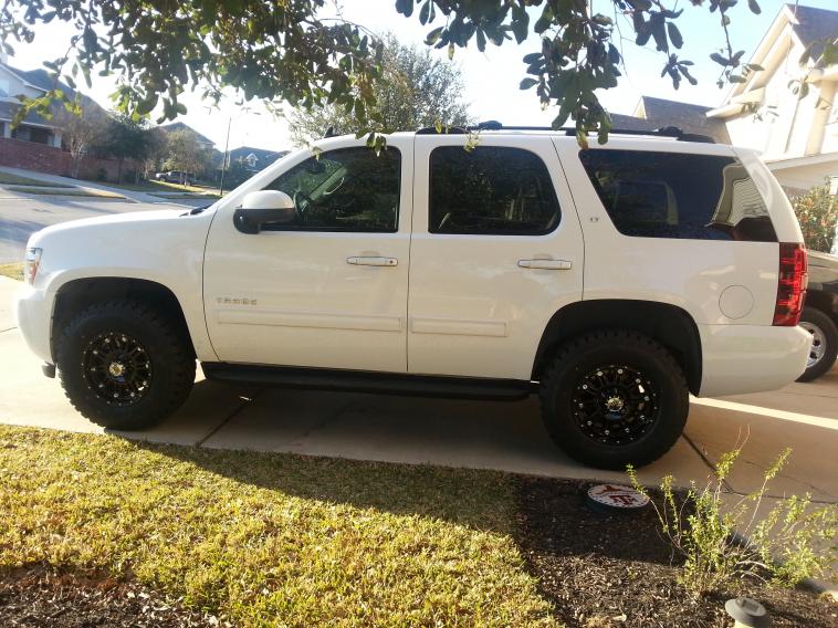

Looks good...
Just got the CCM 2.5"F, 1.5"R leveling kit installed with 285-70-17 pro comp and XD Hoss.

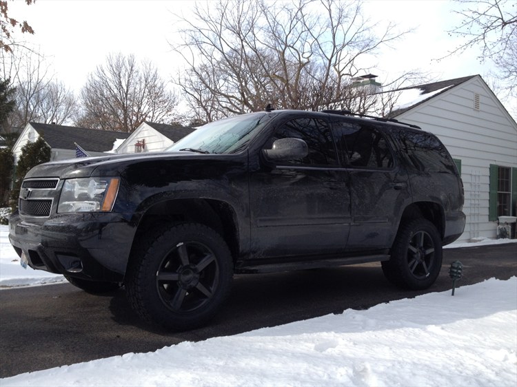

Looking good. What does everyone think of taking the side steps off?

I took mine off my avalanche after adding the leveling kit/tires and it looks much better. It gives it the illusion that it's higher up too.
