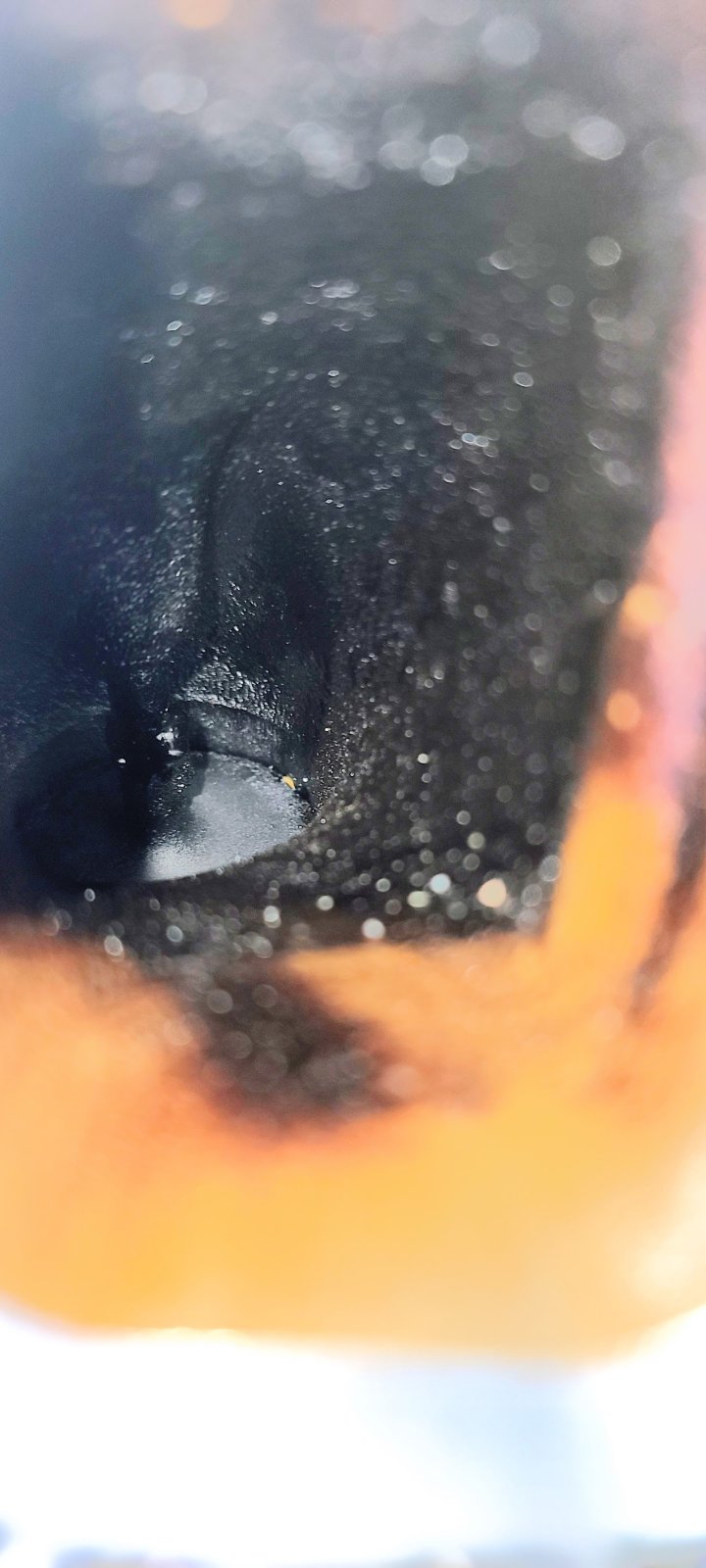

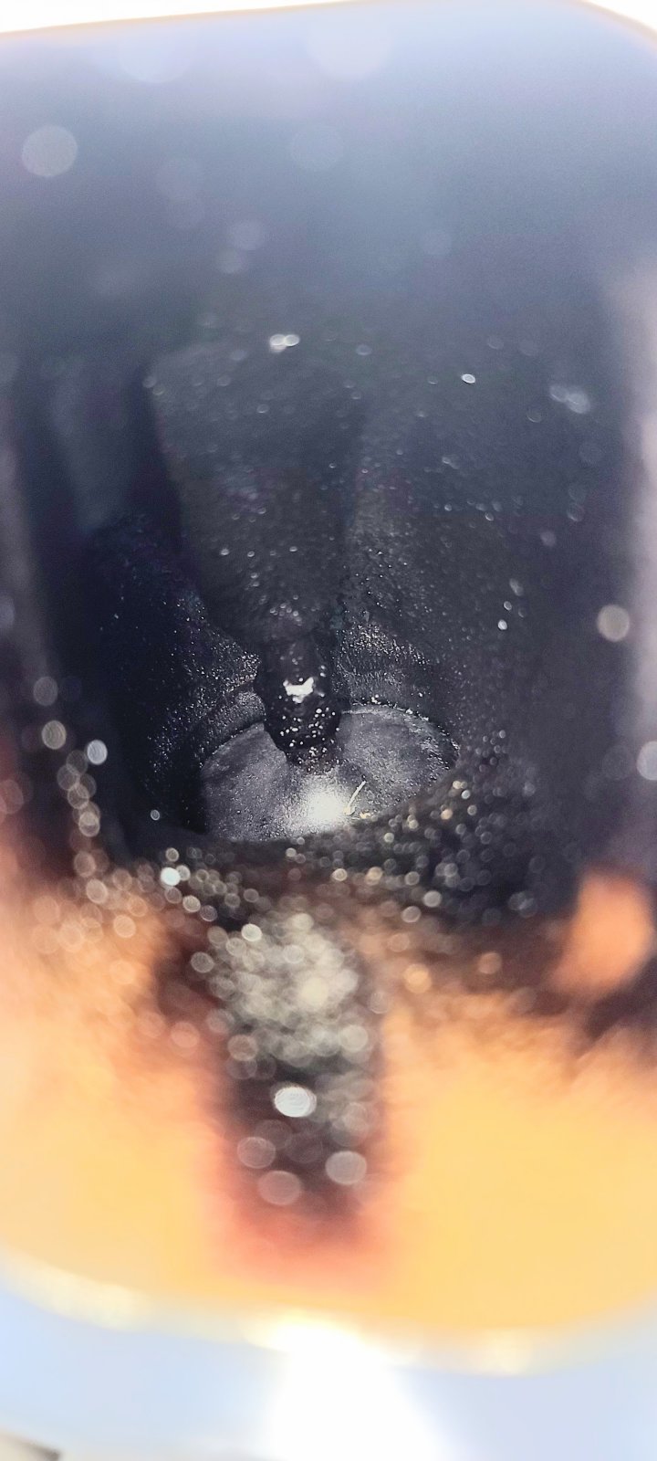

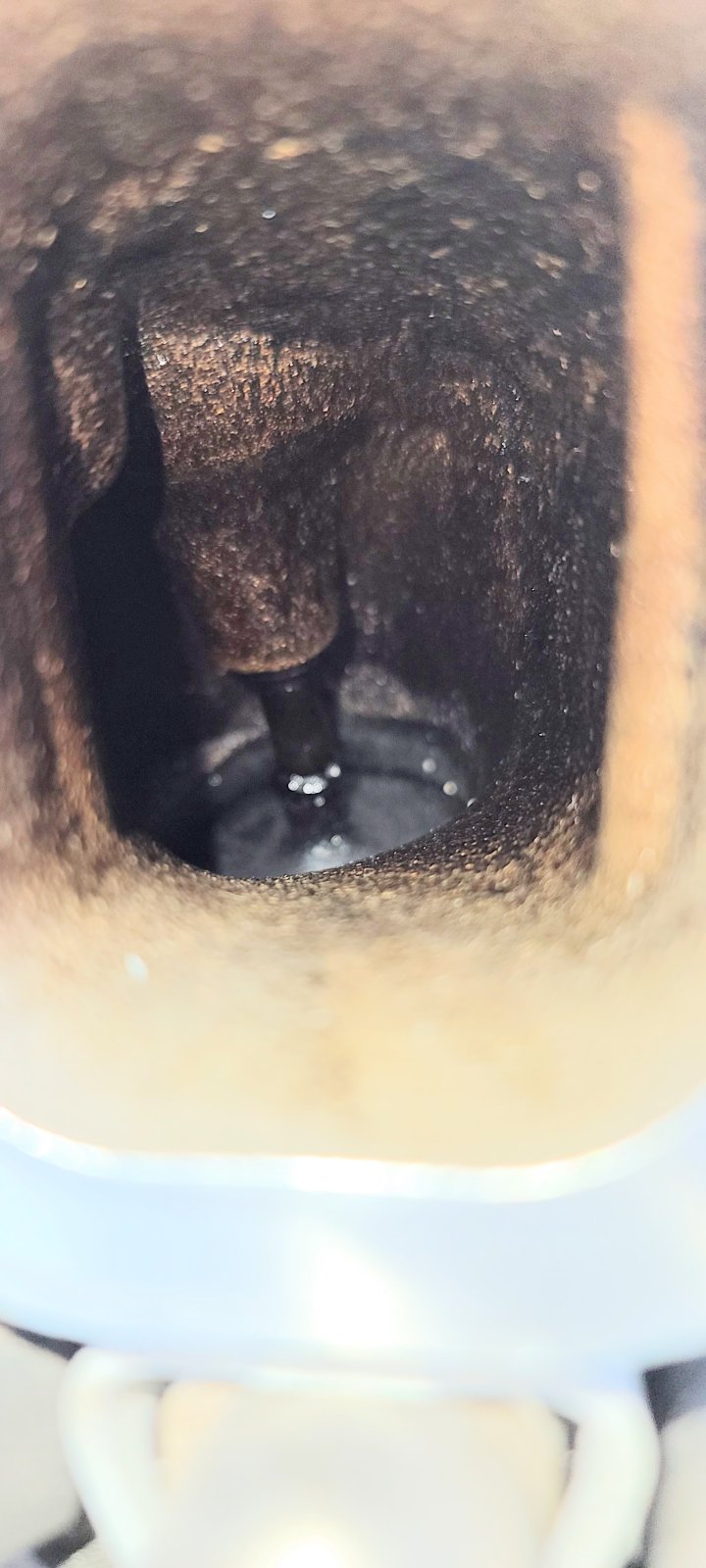

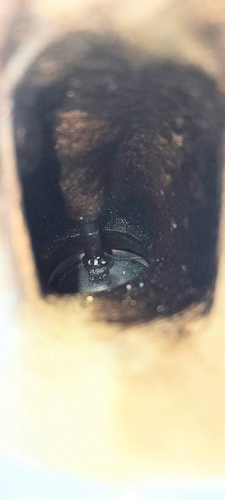

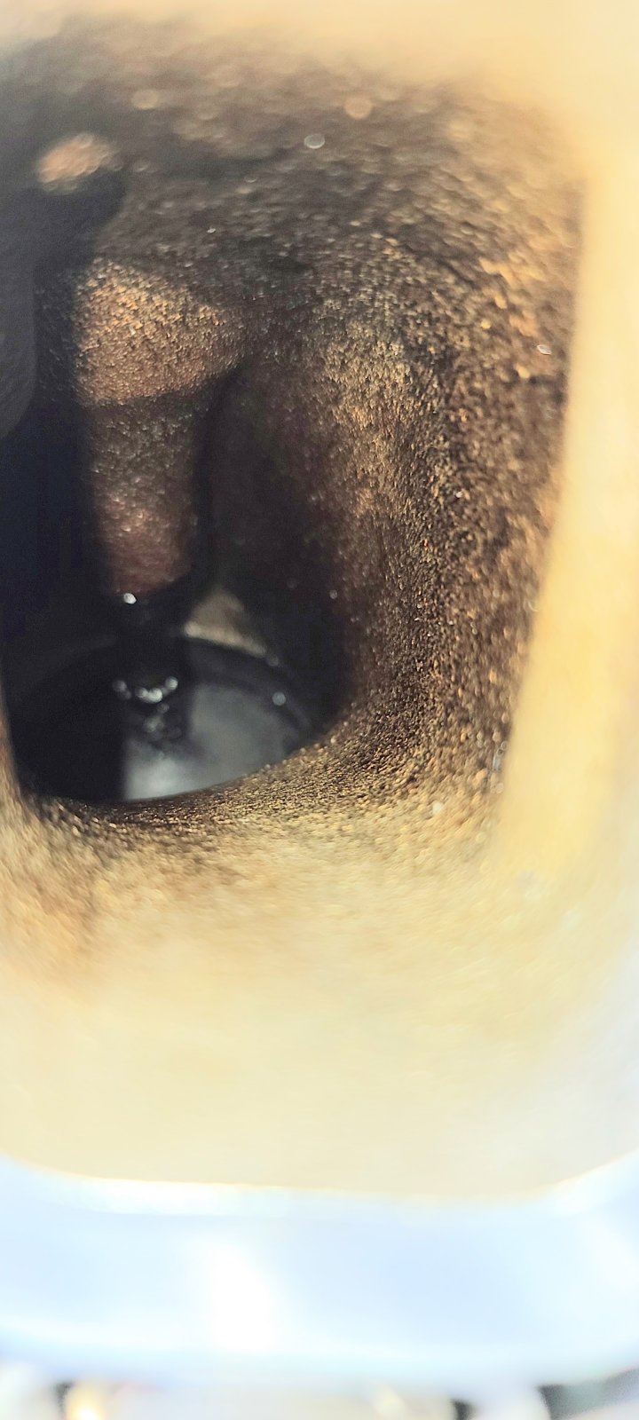

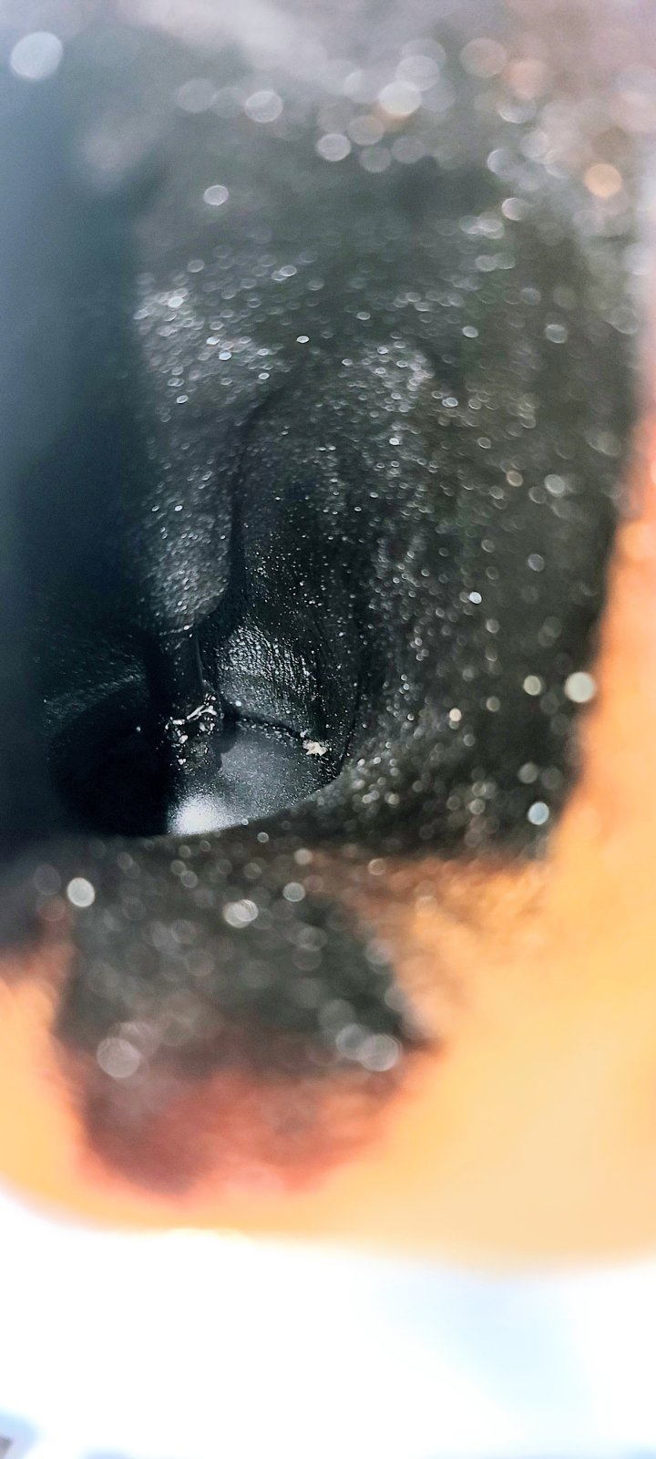

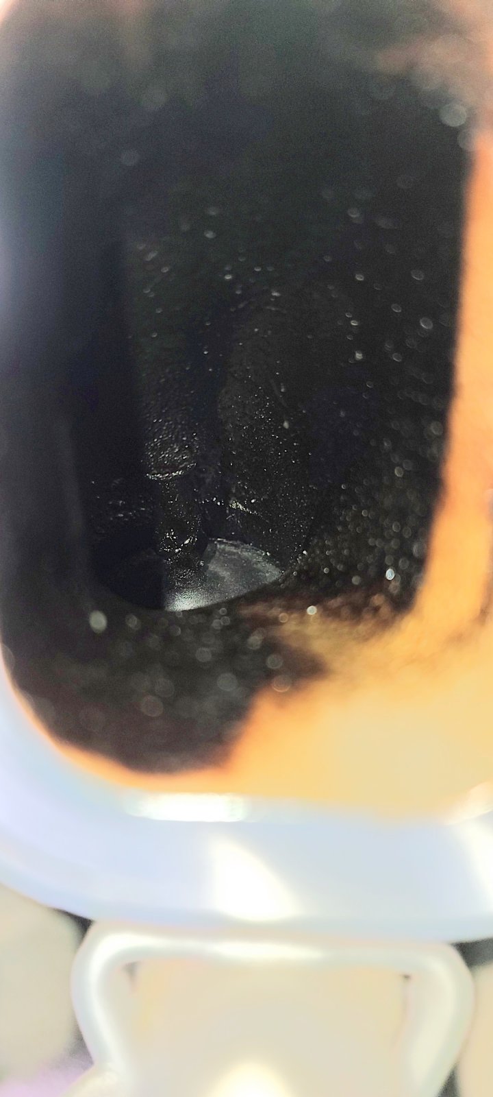

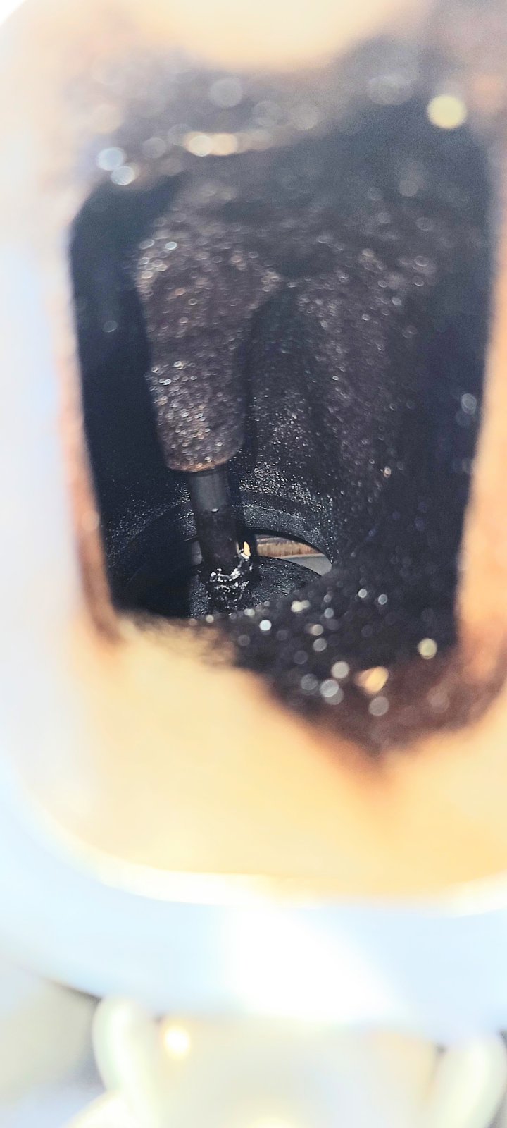

Hey guys. I wanted to share some information on the beloved catch can topic... nothing scientific just a real-world sample.
So I put an Elite Engineering E2-X catch can on my 2016 L86 Yukon XL Denali when I bought it new... can went on around 300miles in. I did not install the clean side separator. I used Mobil1 0w20 Annual Performance and M1-113A filter... changed the oil and filter every 4k miles (don't flame me for wasting money). I've recently switched over to Amsoil Signature full synthetic 0w20 and Amsoil filter as well. Should also note, I've been running a tune and have had DOD disabled from day 1.

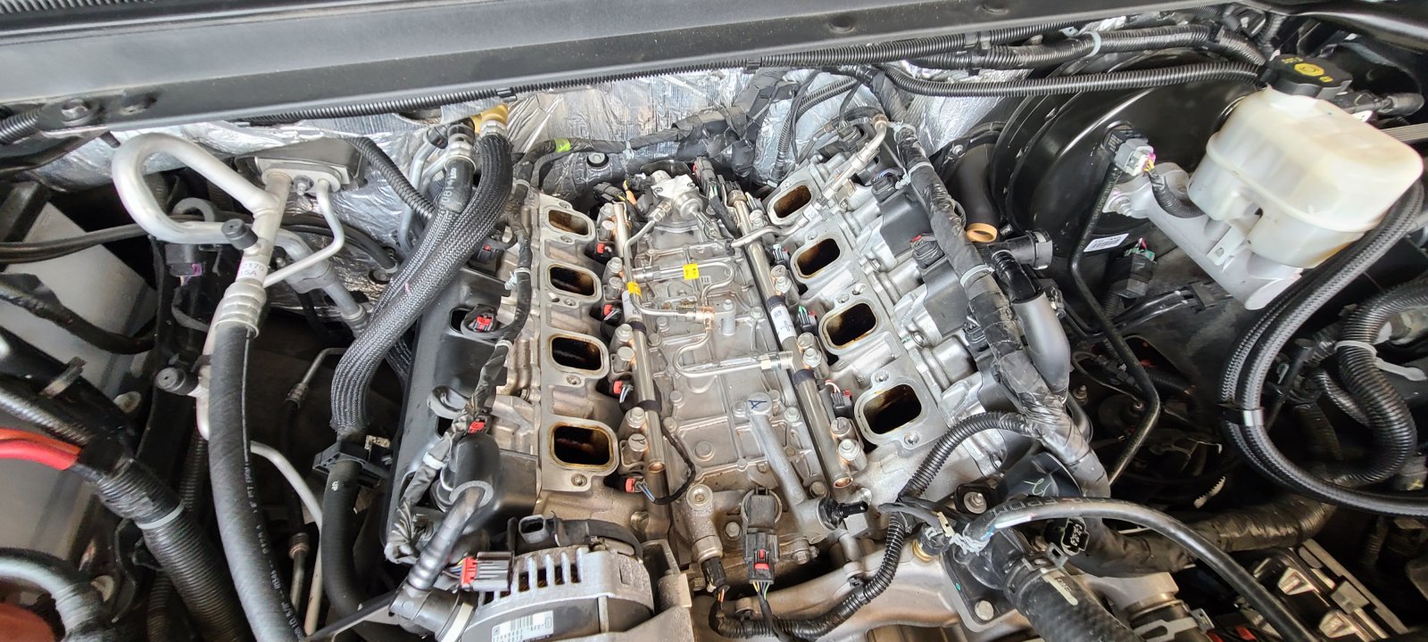

Okay, details out of the way, I took my intake manifold off this past weekend as the curiosity got the best of me and I wanted to see what the valves looked like. Behold the results. Note, the valves got cleaner as you worked you way to the rear of the engine. I should confirm, I'm right at 54,500 miles. Curious what you all think. Just wanted to share this use case from a vehicle that has basically had a can on it from the start as the only owner. I was pretty tired from the gymnastics session in and out of the engine bay so apologies the pictures aren't professional. was having trouble holding a light, my phone and not end up falling out on to the garage floor :)

I did the same experiment on the first catch can I bought and had similar results as you. I have then changed out the catch can to the RacerX catch can with an oil separator and hope to get better results.

Love seeing tests with real-world results like this. I'm surprised It's so dirty in there, especially with such a nice can.

I'd be curious to see what the valves looked like on a similar vintage and mileage without a catch can.
This is one reason Ford introduced two sets of injectors on their Ecoboost, one set for direct injection, the other before the valves. One of the main reasons for this is that there is no safe way to clean the valves on an Ecoboost without tearing the engine apart. At least on ours we can run some cleaner through the intake to clean that stuff up if necessary.

Man I just put mine on at 66,000 miles and I'm starting to wonder if it was even worth it...those are DIRTY!

It's definitely not cosmetic and the issue is real. I do plan to clean my valves at some point in the near future as I plan to keep the vehicle. I should clarify, I do not have any drivability issues and she still runs really smooth and gas mileage is still good. If the carbon deposits get bad enough then yes, you'll have codes and drivability issues, etc.
I tend to keep vehicles longer and perform above the required maintenance to try and get the most life out of them. If you're leasing or don't plan to keep a vehicle for an extended period of time then don't worry about any of this and drive it like you stole it. lol

Let me know if you need any tips or tricks on getting the manifold off when you decide to do so. It's really not that difficult but slow and steady is key... even with getting the harness removed from the back of the manifold cover shield. The biggest frustration I had was how I felt the next day from lying across the engine bay. It sucks that my brain still thinks I'm in my 20's :cool: Gearhead for life! :head3:

I am amazed how much oil is on those valves. :confused:o_O
