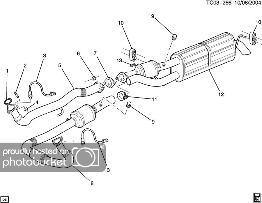

It may not matter other than the positioning of the converters being different distances from the engine. Like I said it is about 20" difference. I guess I was wondering if the distance may effect temperatures and if someone had experience with this system. The 2500 Yukons & Burbs do have a different exhaust. I believe it is the same exhaust as the 8.1 2500 Yukons & Burbs. I could be wrong, but I havent been able to locate replacement exhaust components or too many aftermarket options.

It may not matter other than the positioning of the converters being different distances from the engine. Like I said it is about 20" difference. I guess I was wondering if the distance may effect temperatures and if someone had experience with this system. The 2500 Yukons & Burbs do have a different exhaust. I believe it is the same exhaust as the 8.1 2500 Yukons & Burbs. I could be wrong, but I havent been able to locate replacement exhaust components or too many aftermarket options. View attachment 211425
You sure those aren't resonators. They are design to reduce exhaust drone in the cabin. That's pretty far back for catalytic converters. Stock cats are pretty close to the exhaust manifolds. One reason people turn off the rear 02 sensors with longtube headers is it moves the cats further back and they don't heat up as much and throw error codes..
Sent from my SAMSUNG-SM-T377A using Tapatalk
Definitely cats, Right bank is near the rear of the passenger door, like the pic above. Its actually part of the muffler.

I think the difference in placement is due to the pipe length. the drivers bank is "closer" because it has that extra series of bends up front, moving the cat up may have the same overall pipe distance compared to the passenger side.
Makes sense, Only indicating more that there might be a problems since the temps read differently from each other.
All I know is there should not be a problem with longtube headers based on how far back your cats are from the manifold. That's a long way to heat them up properly or maybe that was the intent.
