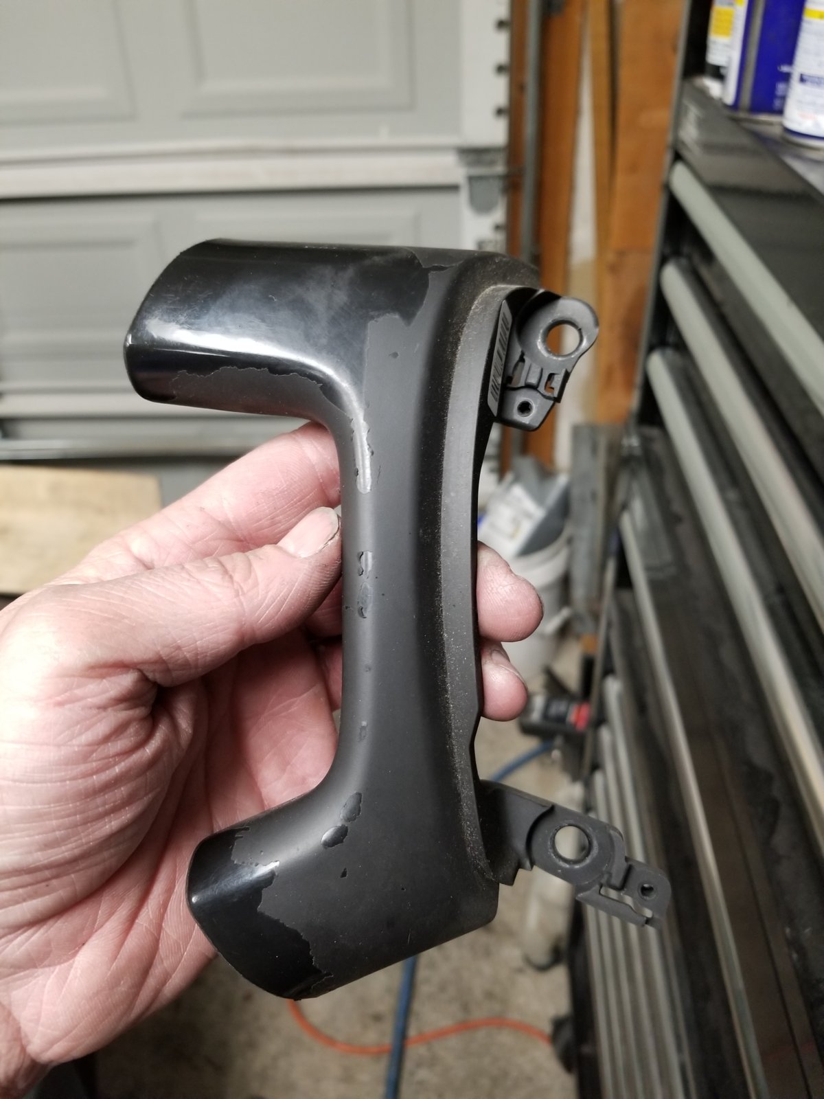

My steering wheel looks like crap so I'm attempting to do a real carbon fiber overlay with resin to make it look nice. If it turns out good I might do the rest of the pieces.

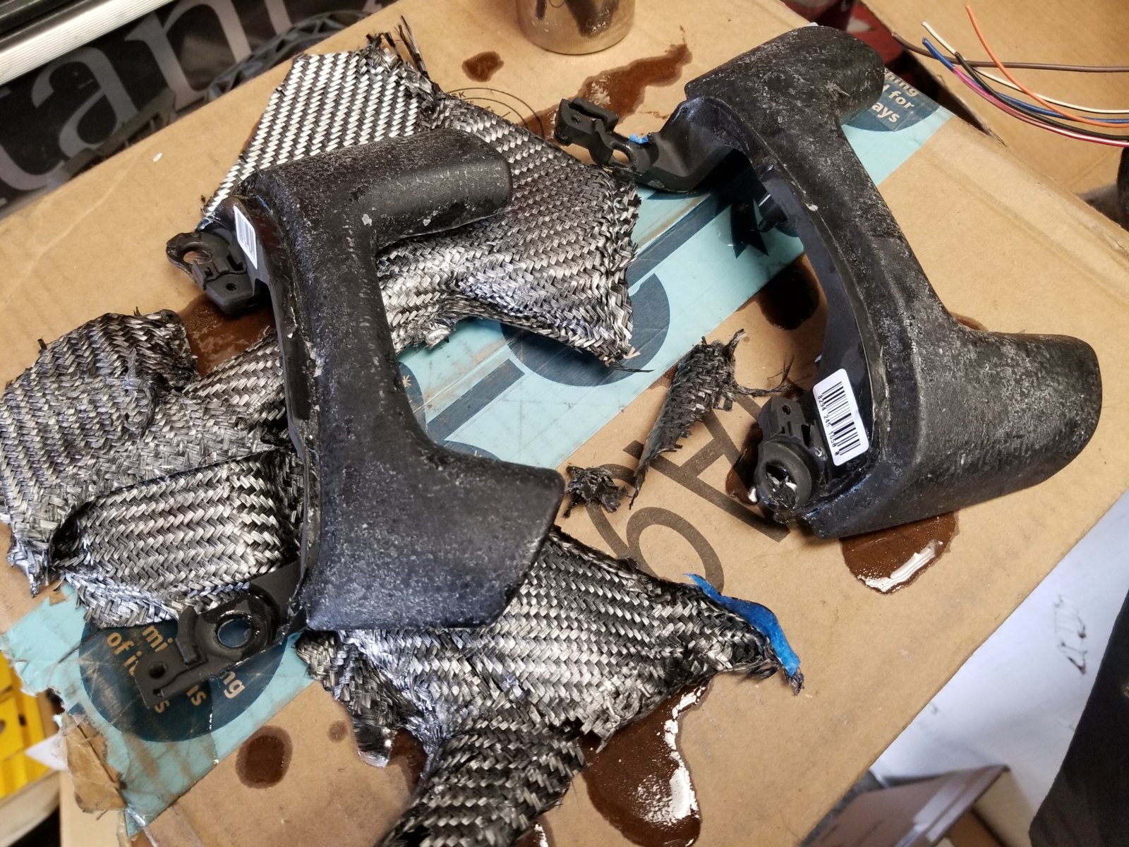

First attempt = fail
Material lifted.

Damn.
How'd you prep and apply it?

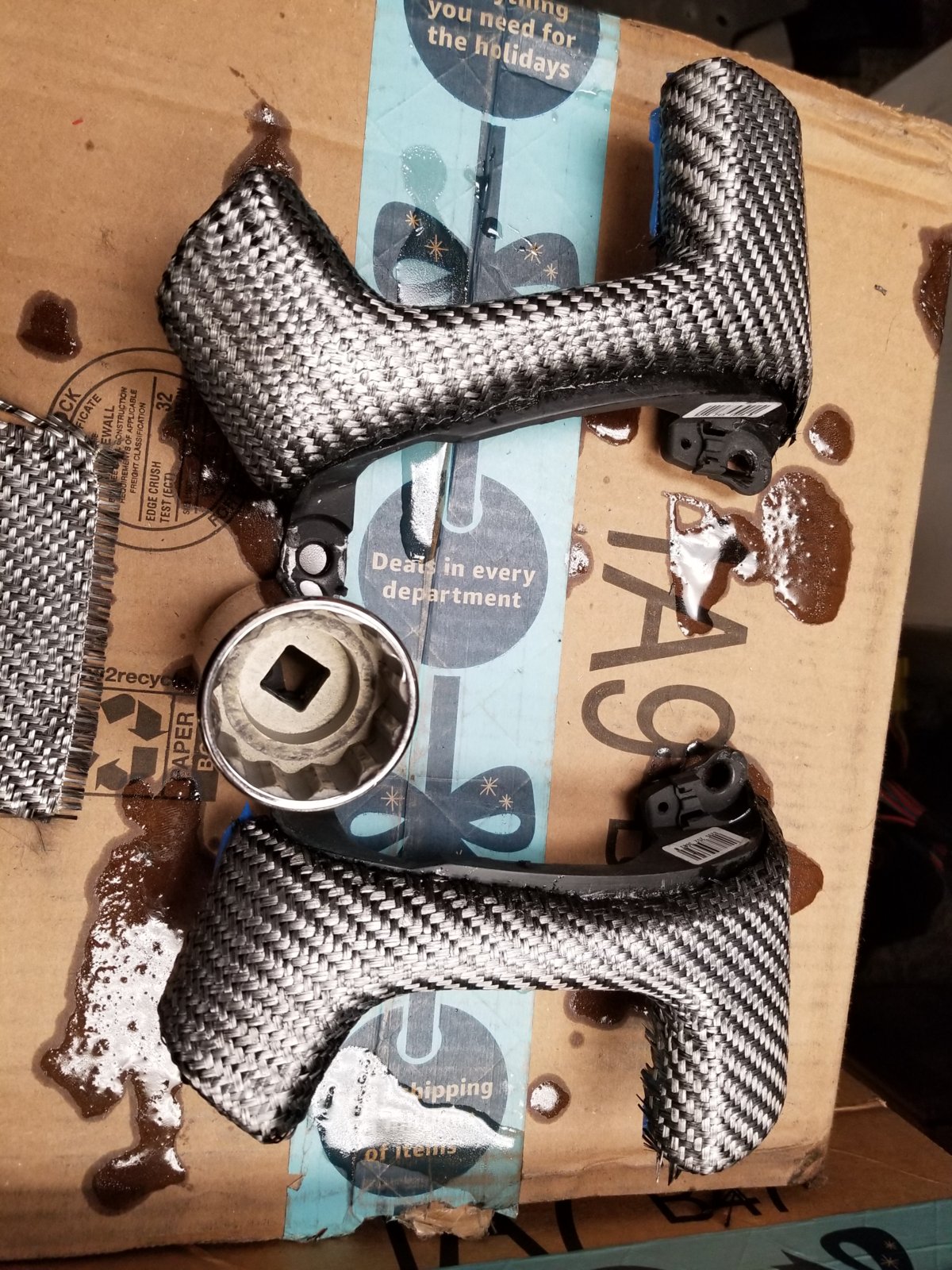

I sanded it and used 3m spray glue to apply the cloth. Then coated out in resin. Turns out the resin makes the spray glue not hold.
Second attempt I put a coating of resin on the parts and after a few hours when it's tacky I'll apply the cloth. Then vacuum the pieces and see if it holds
Gotcha. With the small amount of experience I have using resin and glass, I had the best results applying the resin to both pieces and waiting for them to get tacky, then applying.
Vacuuming them together, man now your stepping it up another notch haha.
I'm feeling good about this one haha.

I’ve aleays applied resin and cloth at the same time the few times Ive done fiberglass work. But I never tried to attach it to anything other than more fiberglass.

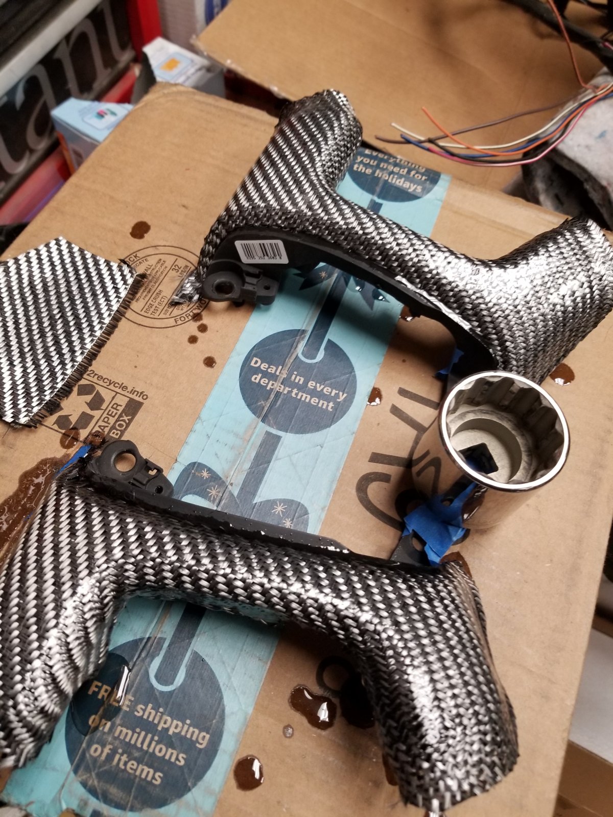

Yes I did. 220 I think
I may need to find a thicker resin so I don't have to do 20 coats. The stuff I have is thin for using in vacuum molds

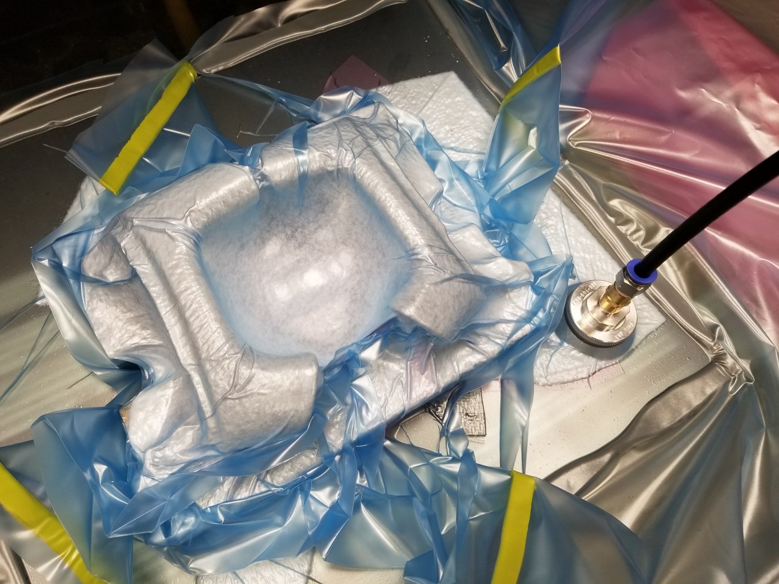

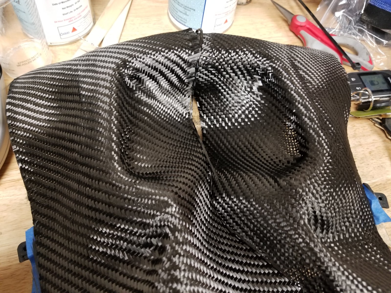

I abandoned the silver looking carbon because it looked crappy after the weave moved from wrapping. Trying out regular twill weave carbon.
Attempt 3:

How big of a station is that vacuum set up?
Did the weave move from the vacuum process?
How did you remove it?
Where do you get it from?
Love the look of carbon.
It's not really a station, just a car window.
the weave has to move to wrap around contours.

I figured it would move but, didn't think it would move that much. Maybe the radius was too much.
