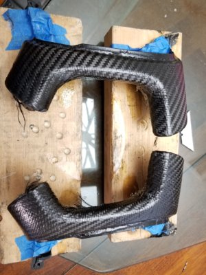

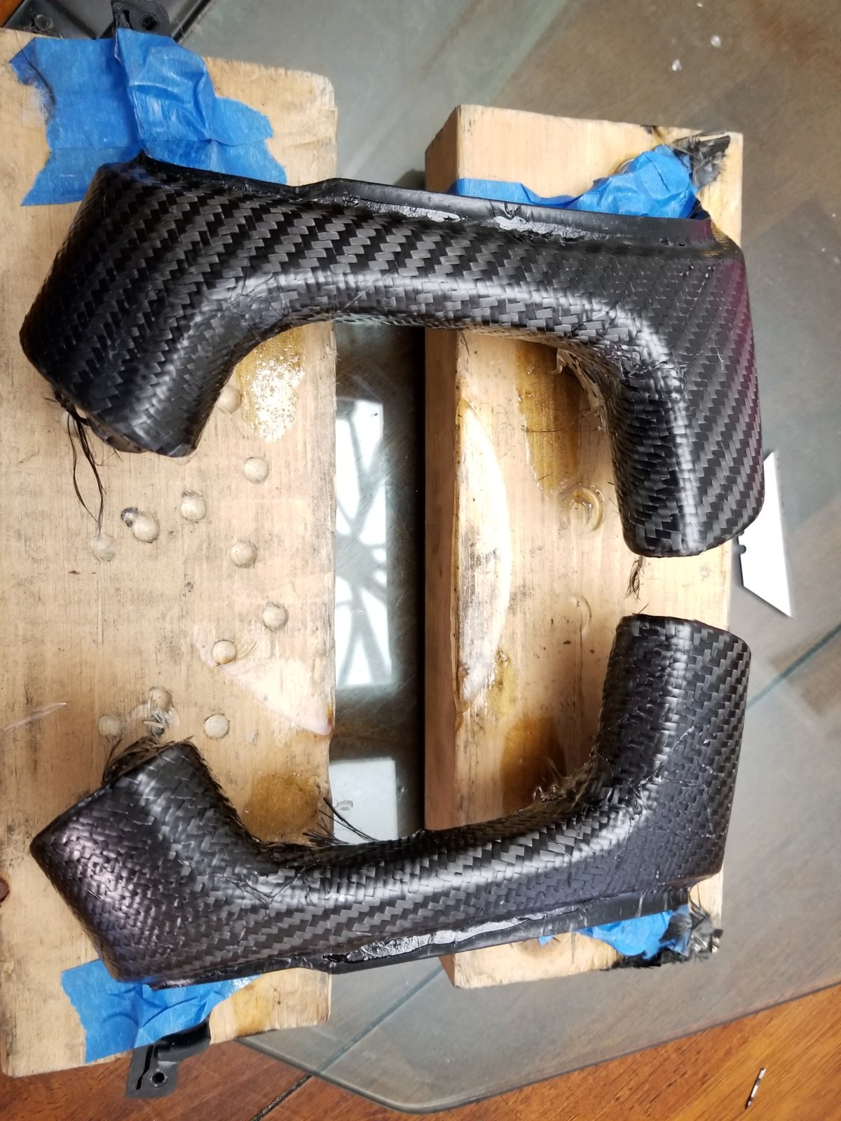

This is looking a lot better. Nice and tight. Now I just need to put about 5 costs of epoxy on top, wet sand, buff and polish. I now know why real carbon fiber stuff is so expensive

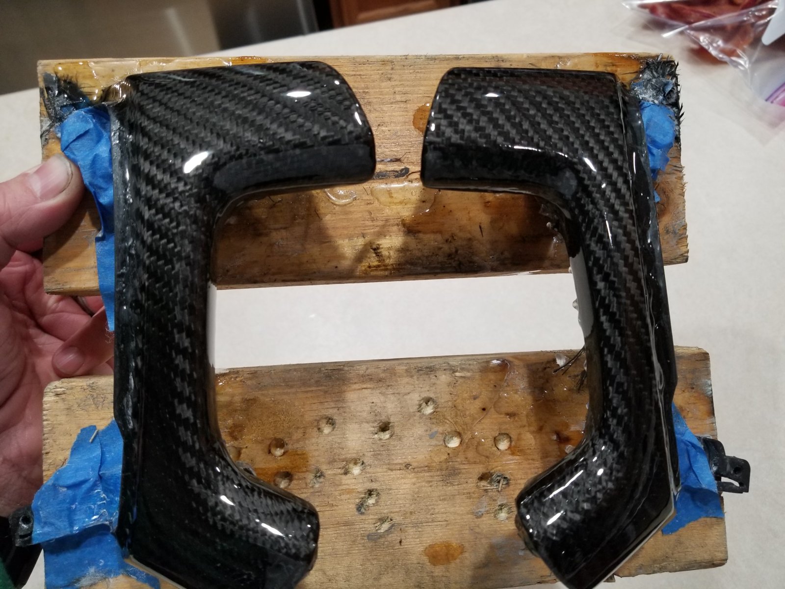

So here's 3 coats and a wet sand before the third coat. Has a few bubbles so I'm going to sand and coat one more time. I'm happy with this now, I just want to see how nice I can get it.

When you lay down a coat of the clear, go over it with a heat gun or hair dryer to pop the bubbles.
But yeah, like the others are saying, that's looking nice! Where can I send the panels off our wheel to get done? ;)

Haha I don't think anyone would want to pay what I'd have to charge for it. It's literally taking me weeks to do. If I can get the technique down, maybe.
Last night I spent an hour trimming the excess resin and fibers from the edges, wet sanding with 600, 1000, 2000 grit paper, then used rubbing compound, and polishing compound. But there are still small scratches so I'll have to wet sand again I think.
