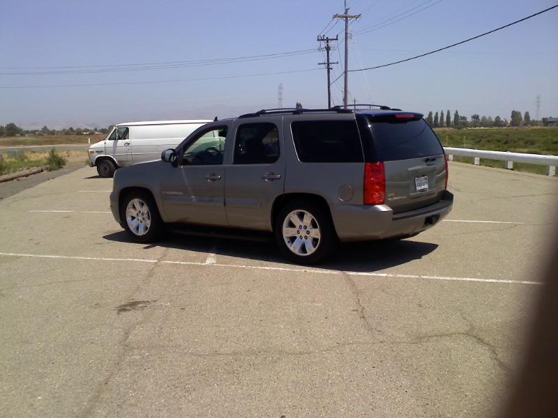

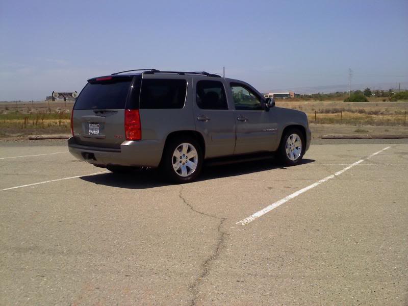

R.Beezy
Costco Member
May 10, 2009
334
Bay Area 510
R. Beezy do you have pics of your Yukon with the drop kit that you can post? Your 2/3 drop looks lower than many other 2/3 drop kits; I really like what I can see on your signature. Sorry for getting a little off topic.
i will post recent pics of my truck sometime tomorrow. my signature pic is an old pic of my truck before i added the Belltech Drop Struts, so now my recent pics will show the front of my truck being even lower since the Drop Struts are adjustable.
but ya, i'll get back to you tomorrow with some pics of my truck.....
R.Beezy
Costco Member
May 10, 2009
334
Bay Area 510
aye John, here's the pics i promised you...
