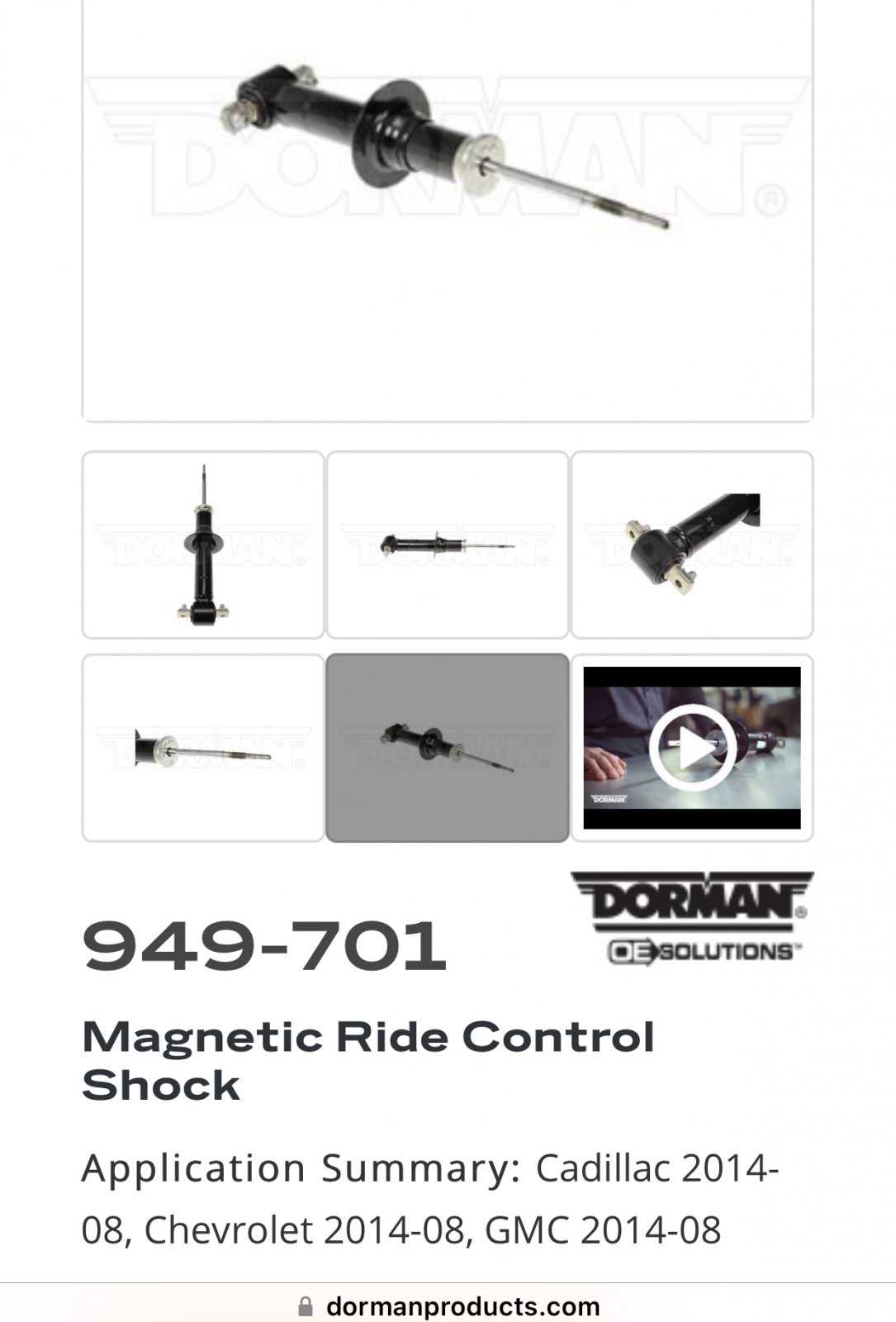

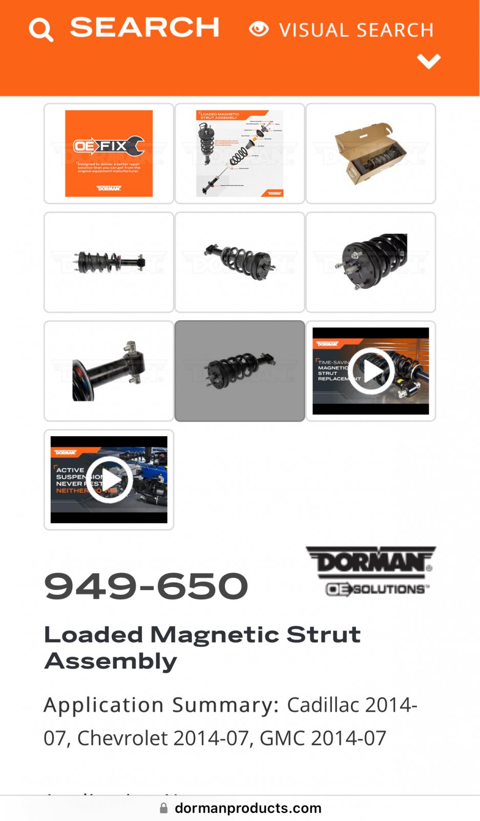

Rears are air ride, so far, aftermarket holds. New shocks with bags and compressor. I got Dorman magneride new shocks in the front and they suck big time. Way too soft. Way. So plan is to kill magneride in the front and put in KYBs. But then I need to cancel magneride sensors. Hence the question.

It’s an 07 Tahoe LT with autoride, right? That means it has the struts filled with hydraulic fluid that are semi active or bi-state. Did you purchase the MagFluid replacements for the 09+ Esky that won’t work with the Autoride module?

Just FYI, Doorman struts leaked out after 3600 miles. I had them replaced today with KYB strut plus. PERFECT!
