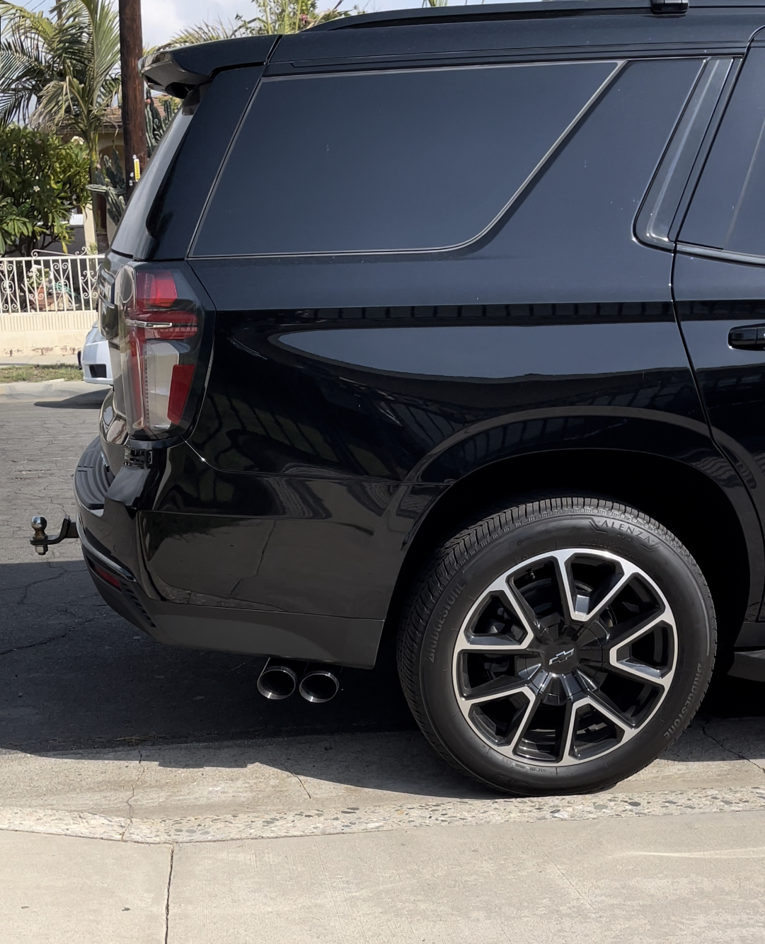

Did they say why it cannot or is the wrong system? Personally for that price i would just return everything and simply change out the muffler. Take it back if you want the dual set up keep the valence only and for under $500 you should be able to find a good muffler only and could be installed by a muffler shop. Corsa is another cat back id consider over the GM exhaust.
On my RST I chose not to go dual so kept tips on one side.

Thanks for the reply. They said it didnt have the right flanges to be mounted properly.
That looks nice. Which exhaust is that?

This is the borla S Type.
I got the muffler on but they also have the full catback system not sure if it a direct fit but should be able to be modified by a shop.
