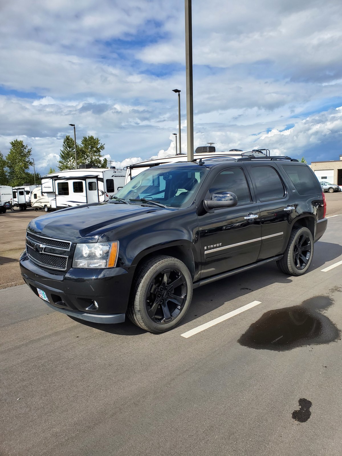

Yay, a fellow 09 6.2 Tahoe owner!! I have one too, and ordered a cam like yours, also have ARH longtubes being delivered tomorrow.
Got any pictures of your ride?
Nice! Its cool to see another rig like mine.
This is the only pic I have since I put on the black grille.
