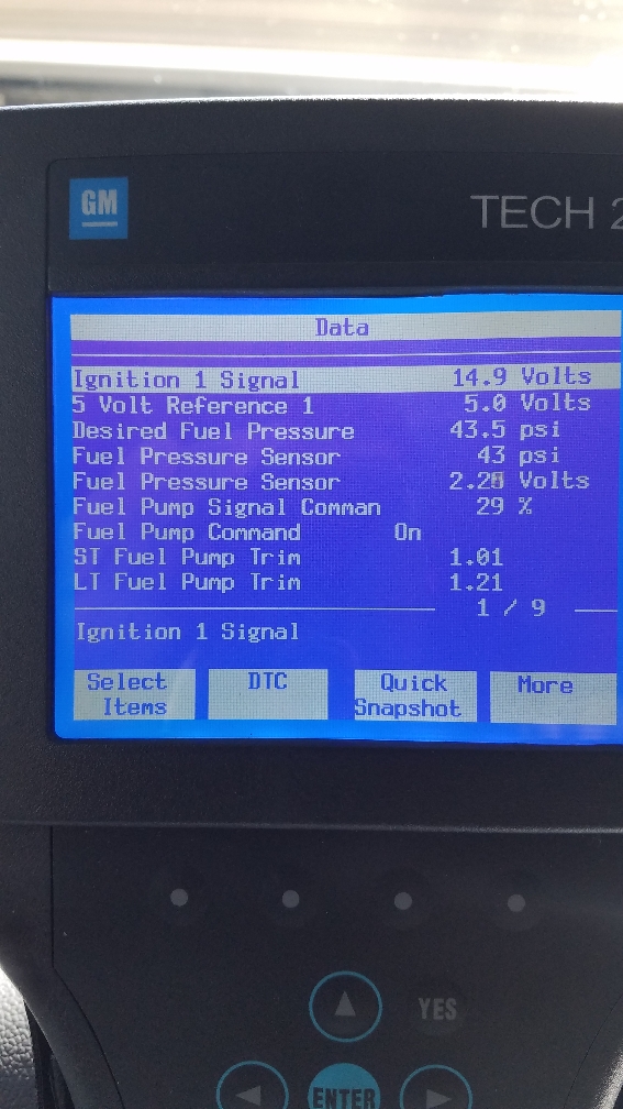

    For those of you that can see your Fuel Pump Module, what are your Fuel Pump trims?
    Mine started off at about 1.25 three years ago and is now at 1.54. Is this a sign of the pump's health? And if so, how high means it is time to replace?

    What are fuel pump trims? What do they indicate?

    Not really sure Steve. I'm speculating that they operate like the motor, adding or taking away pump power to meet the desired output. If the computer commands 33% so it delivers X amount of pressure or volume and 40% is required then that makes sense to me as I write it out here.

    Where would this be found in the Tech2?
    I'm off today (holiday), and don't plan on going anywhere, but I can get a reading later with it idling in the garage.
    I know years ago, at least on my 5.0 mustang, it used a fuel pressure regulator that operated via vacuum. Then on the 4.6 mustang like my wife's, it uses a FPDM modual to raise/lower fuel pump voltage to increase/decrease pressure as the motor needed it.

    On mine it's in the Engine Control Module and in there it has its own heading, under the engine and above the Transfer Case and Transmission. My brain cannot remember the exact terms used right now.

    hmm, interesting, I will have to check mine I have had suspicion that some of my poor fuel mileage has to do with low fuel pressure, my fuel pressure runs at 45 with the engine running which seems to be the bare minimum required. I see some reporting 50-55 but mostly on the nbs's, the fuel pumps on the nbs's are rated for 100k the dealer told me the nnbs pumps go farther but i never got a official rating. mine has 125k on it as far as I know.
    pre-start mine will be 65lbs
    running it is only 45lbs
