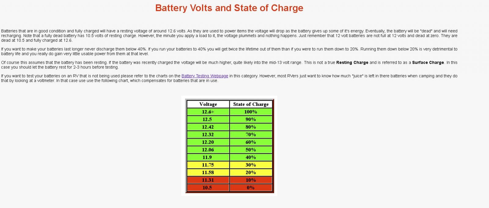

Did this test tonight. Both "State of Charge" and "Start State of Charge" are showing at 70% and it says "NO" in the "Low State of Charge" field. Still suspect a problem with the battery, or are the DIC messages coming from something else?
what I do to check mine is use a volt meter on the battery terminals after it has been sitting at least overnight before the vehicle is started.
Idealy you want 80% or better
10.8 volt's is the number that GM uses as "dead" at 10.8v it might not even start
