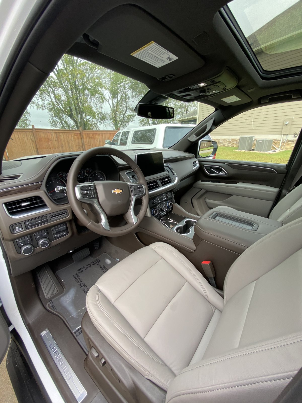

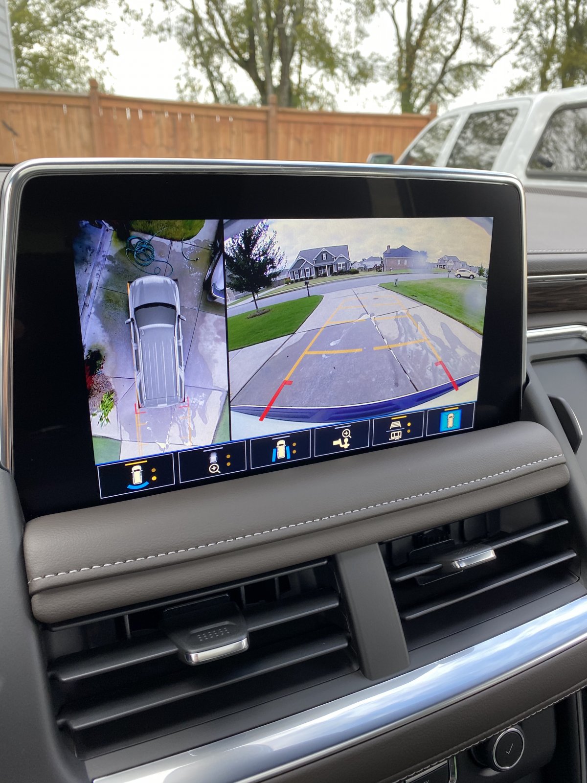

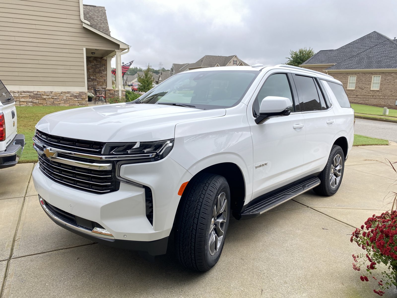

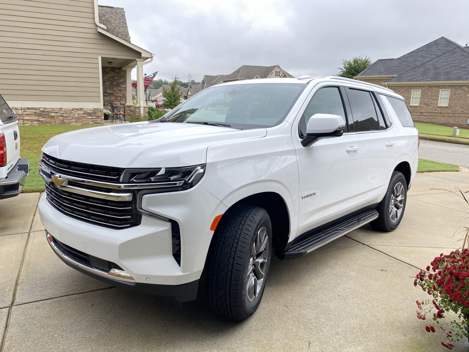

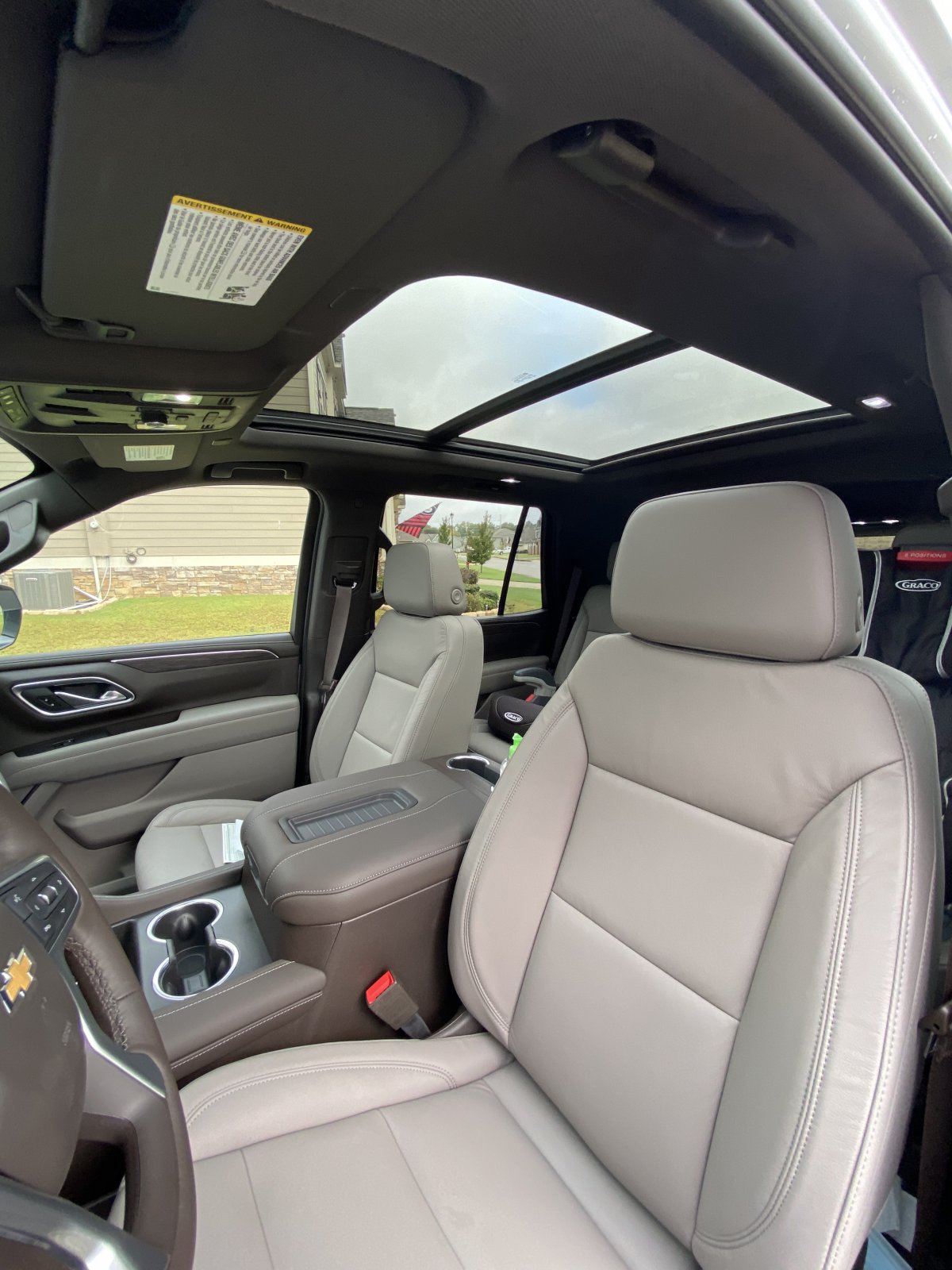

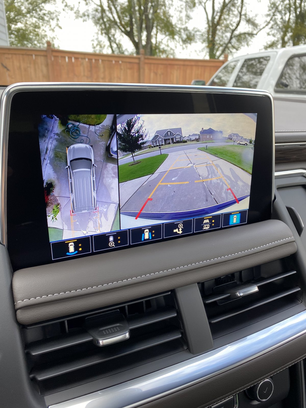

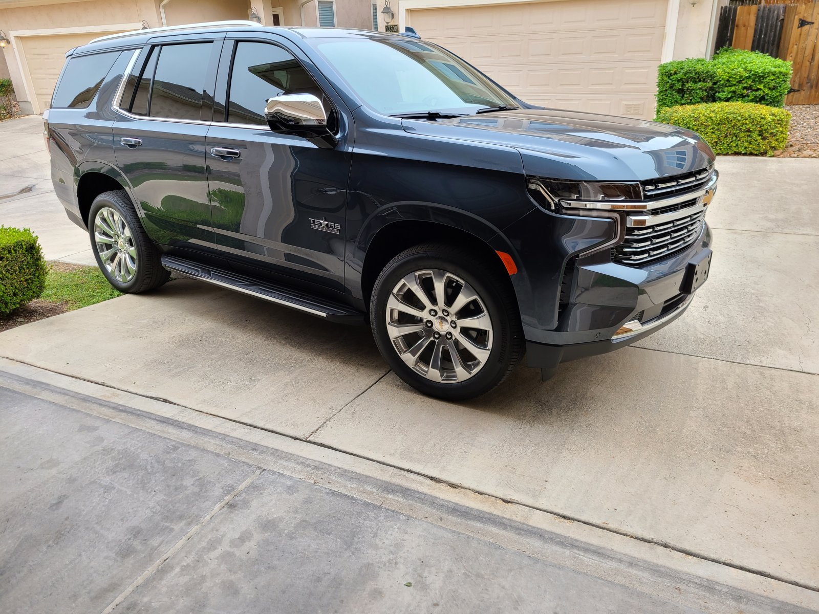

Thanks for the welcome and here is a pic. I really love this shadow grey metallic color
