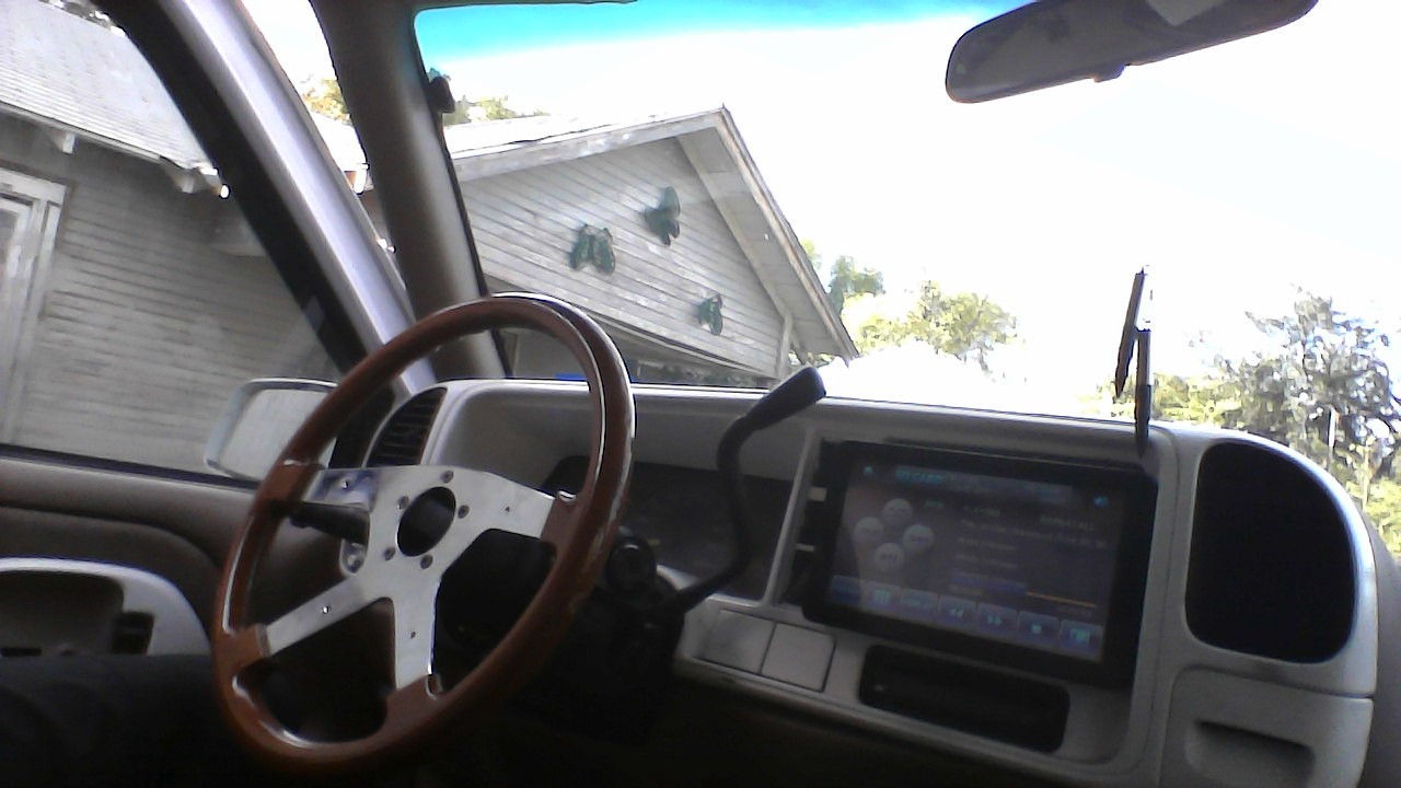

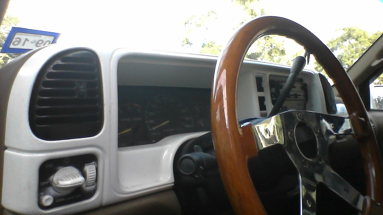

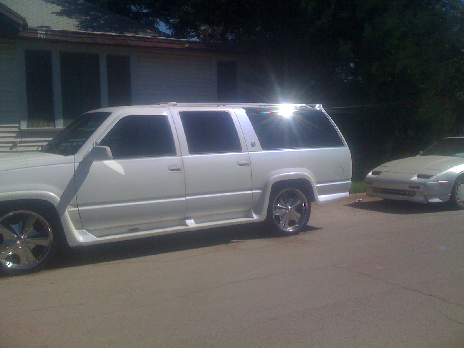

Hello Chevy world from Texas. I own a 1995 Chevy Suburban C1500 with a 99-00 Cadillac Escalade front clip and Cadillac De Ville tailights.
What can i do with my dash as far as swaps? Dash swaps? Or updated gauge swaps?
I need a new front bumper cover for the Escalade front clip. Do i have to buy the kit parts? Or can i buy just the oem Cadillac Escalade Bumper cover???

I am really interested in Dash swap possibilities. Does anyone know anything? i would really like to use something from Cadillac Escalade if possible

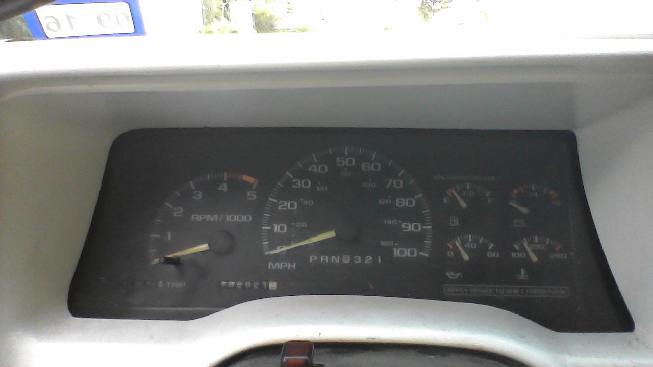

Ok Very informative and very specific. Thank you very much.What about gauge swaps? How would i interface with original gauge wires?
I really would like to put a set of Cadillac Escalade gauges and dash with Touchscreen navigation unit or something similar

Two ways of going about this. You can use your own/custom aftermarket gauges. or you can get ht pcm out of the donor vehicle and splice your existing signals from the original ecu/pcu/tcu/bcm to that of the donor.
youll need the PCM, the complete wiring harness from the donor, applicable control modules from the donor, and the instrument cluster
you are only using the donors ecu/tcu/pcu/bcm for the gauges and not anything else. it will throw codes unless you have an appropriate flash/programming or you'll need a stand-alone program to translate different manufacturer's code so they can communicate. IIRC.
