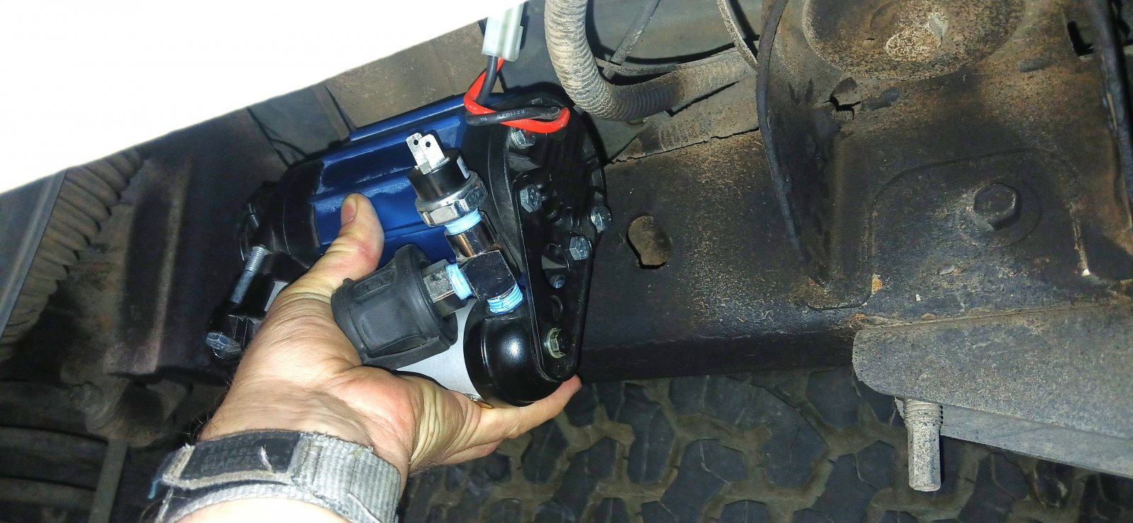

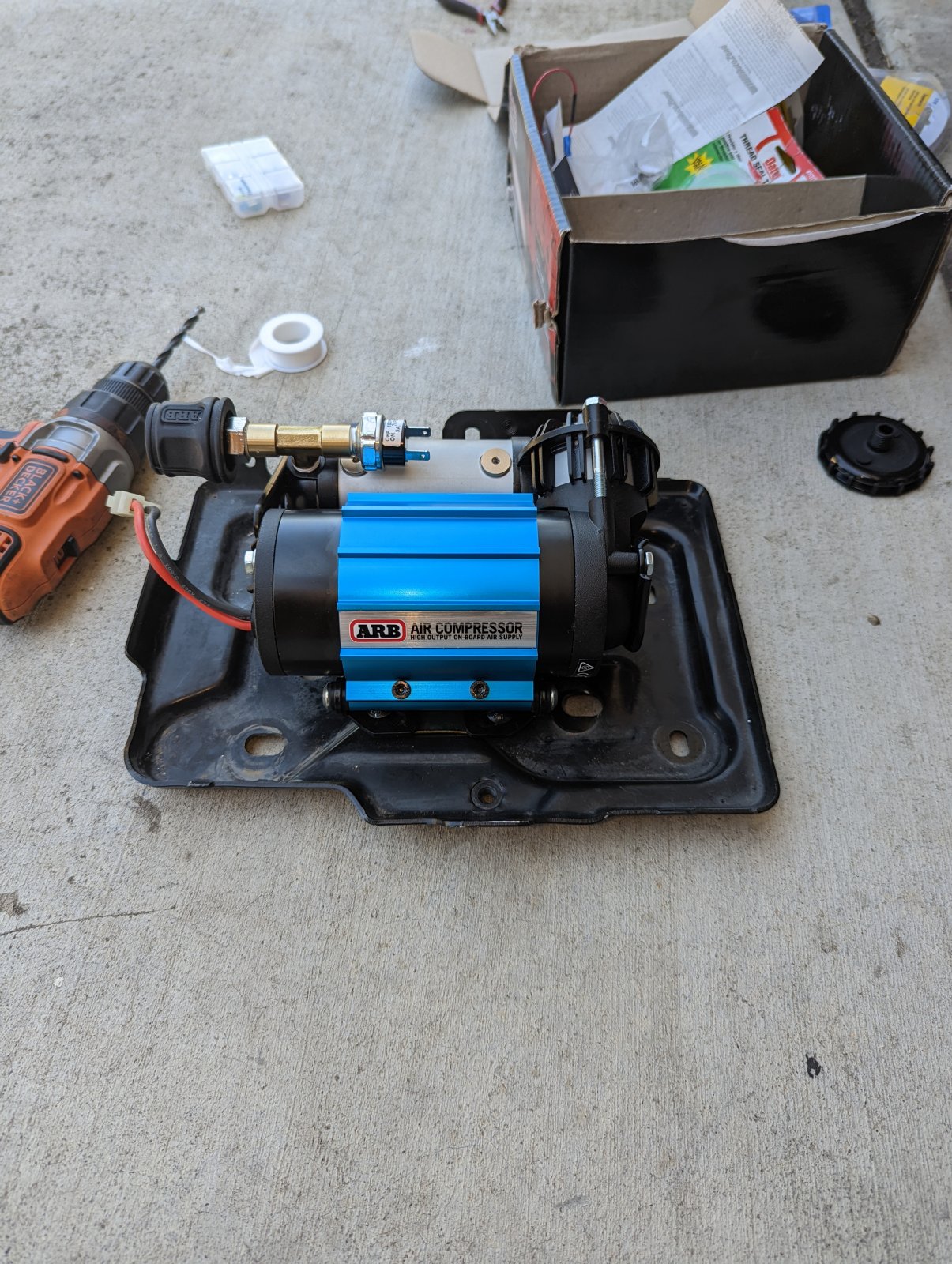

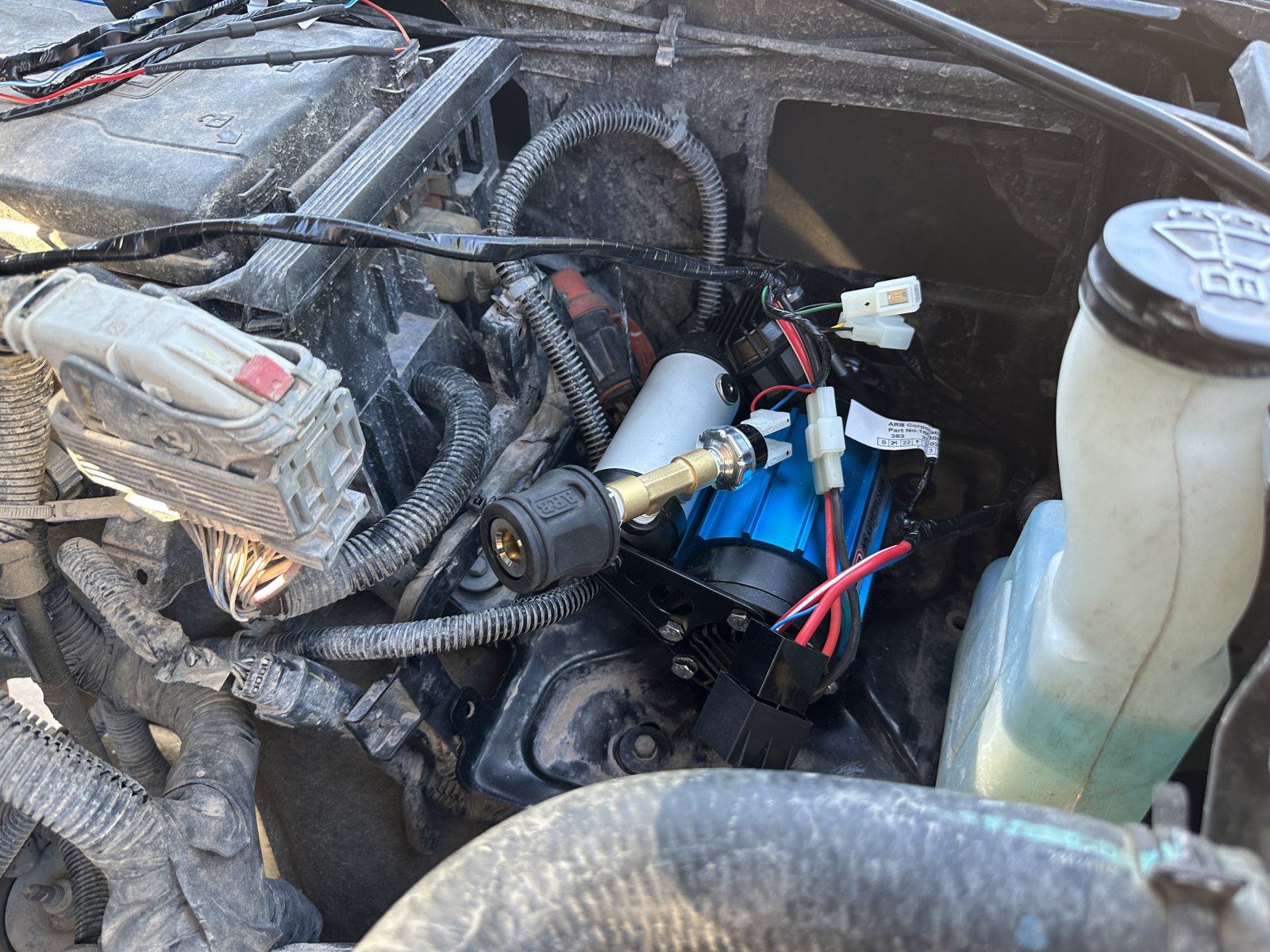

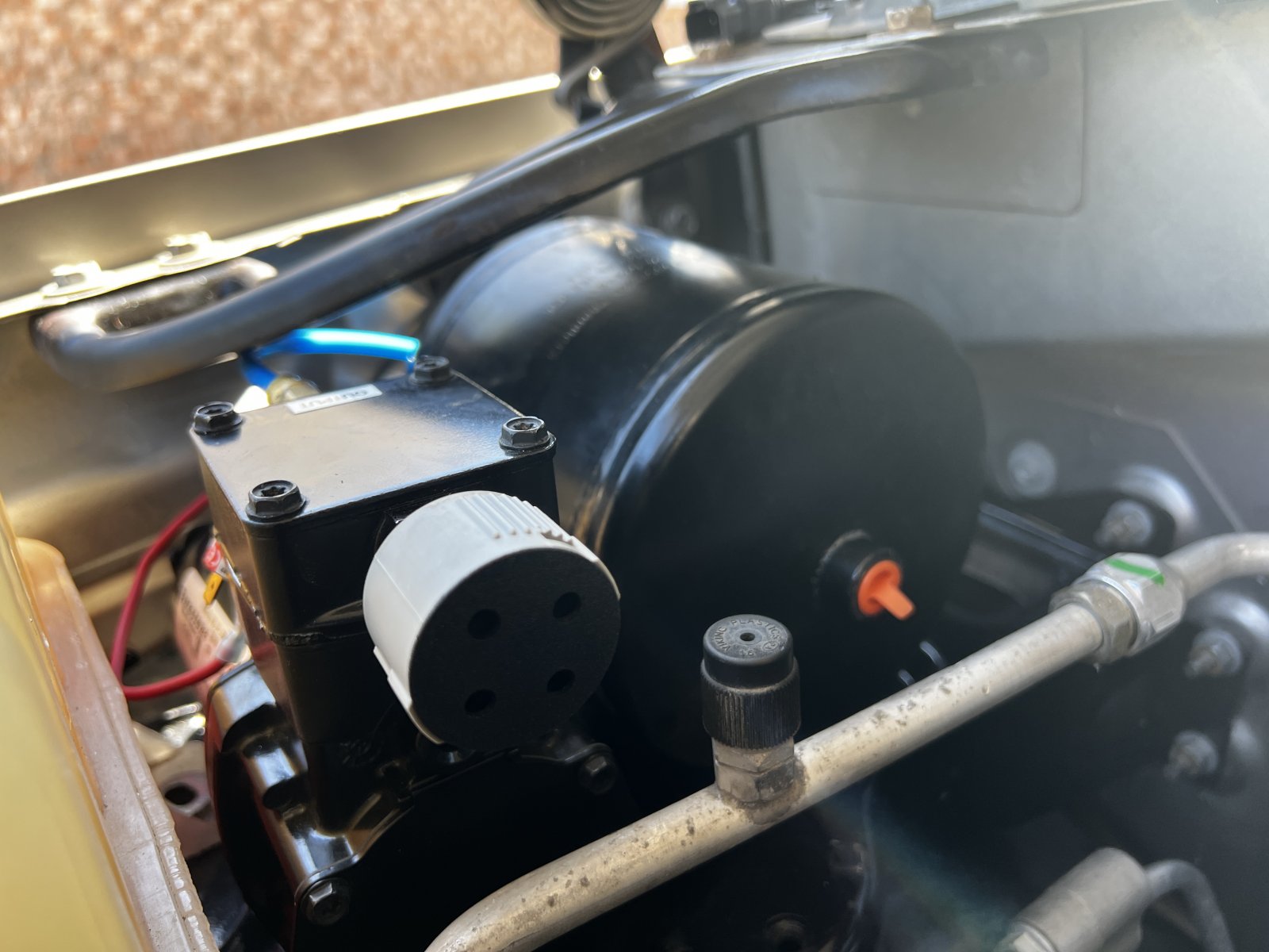

I mounted the same compressor in the second battery tray in thethirdtwin.
Before that I was using Viair 88P, just keeping it from touching anything after use was a pain.

Oh cool. I have the 88p myself. I love it but it's just floating in back of my truck. I want to install something built in now. I like that second battery tray idea! Maybe I could put mine where the air pump goes (my truck doesn't have the smog pump). Great idea! Thanks!

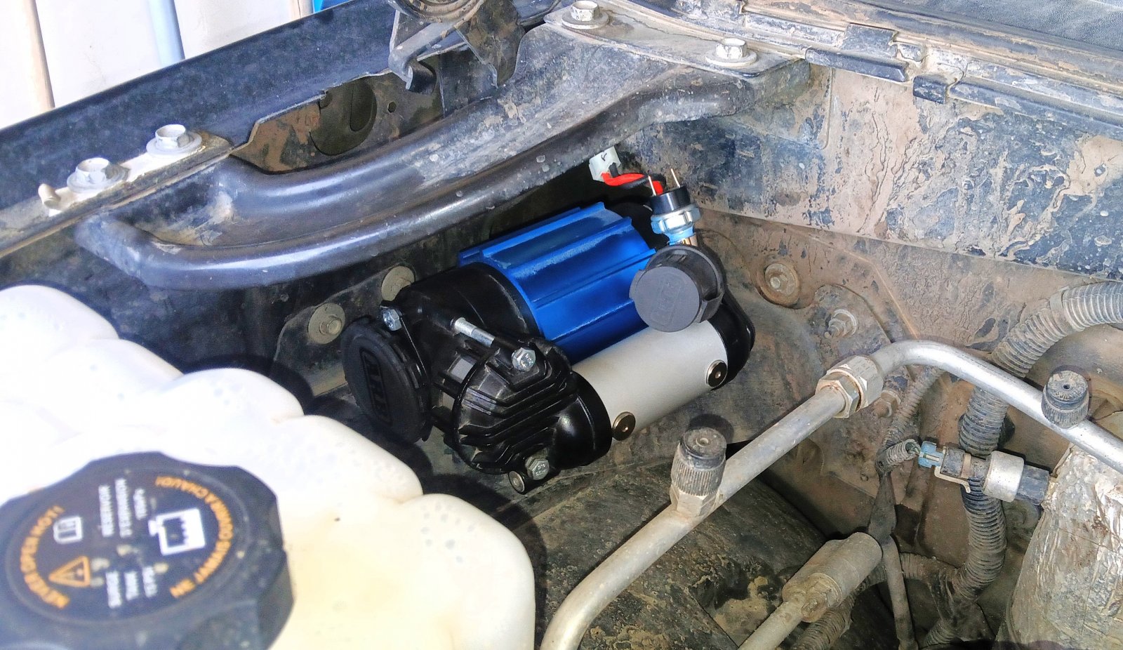

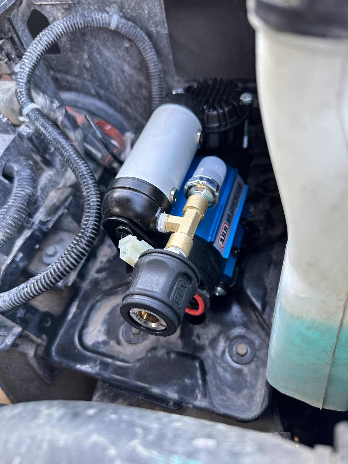

Got the ARB CKMA12. Specifically didn't want a knock off and was lucky to find a deal for used one on eBay, came in at $150 shipped. The harness needs some modification to fit my truck. Couple questions there...

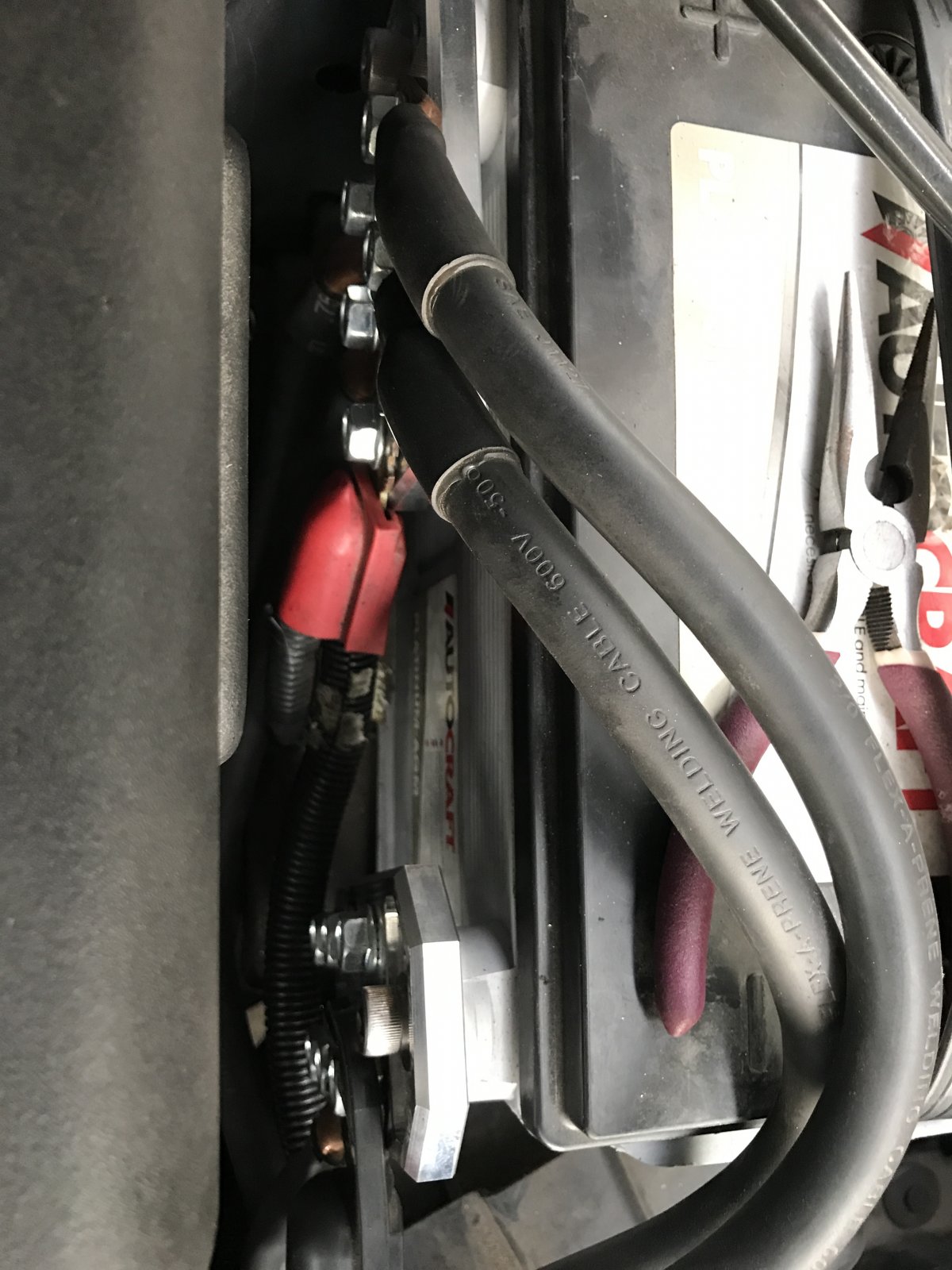

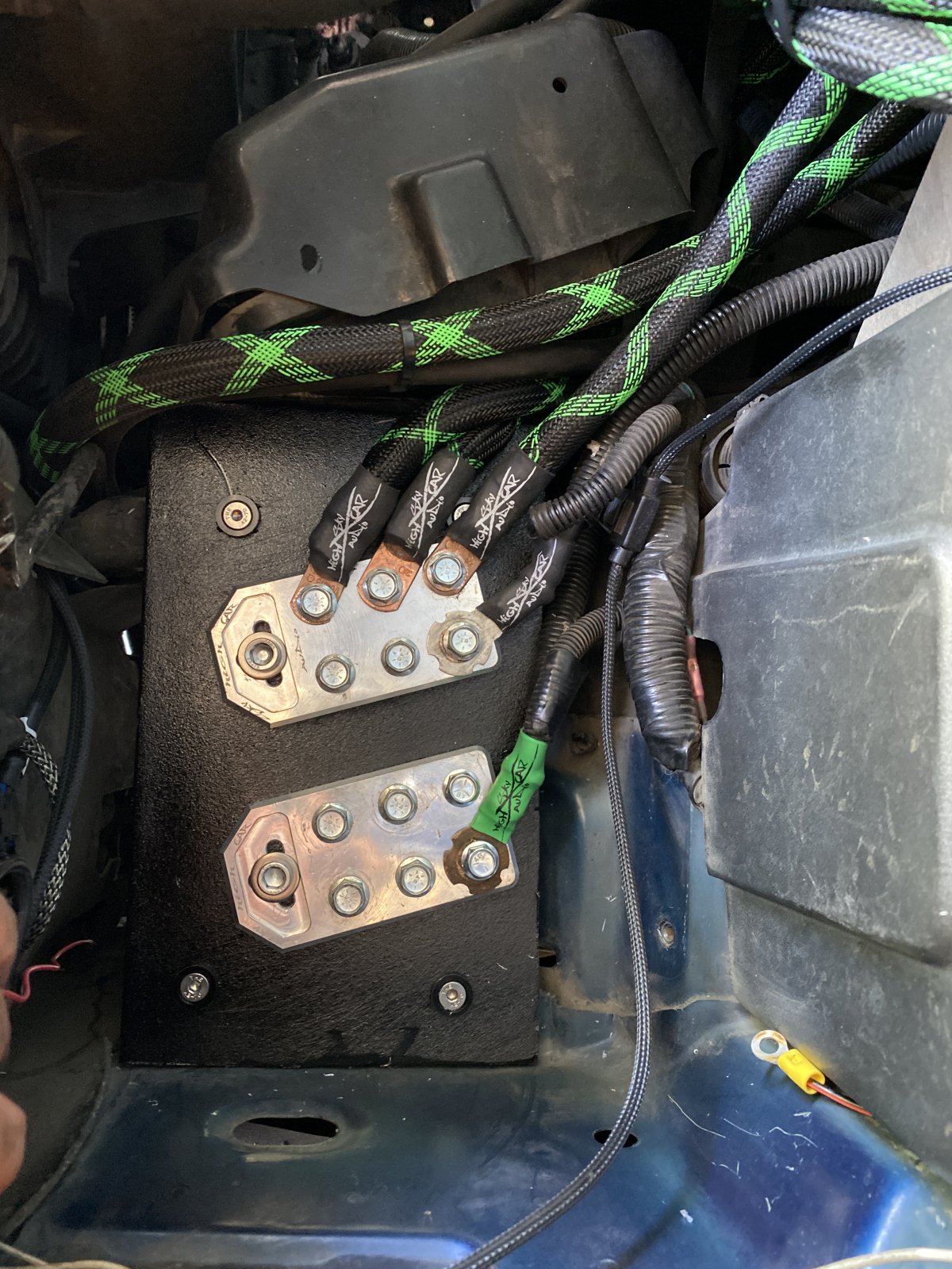

Battery terminal block: I have several modifications that tap into my battery, it's getting to be a mess as I've just screwed them into the battery terminal. I need to mount a terminal block somewhere with battery positive lugs. I did try the ones off the under hood fuse block but that blows the fuses on the fuse block. Would be ideal if I had a terminal block for battery positive with say 40 amp fuse on it then I could remove some of the inline fuses. Any suggestions?
Wire Spec: I'm thinking a 6 gauge wire for power would be good. That should handle 40 to 50 amps (pump is fused at 40). I will get copper wire, however, my head spins beyond that. I want high temp rated, and none of that edible stuff made from soy or whatever that the rodents eat. Anybody know the wire type?
Above is where it probably should go and will go. It fits very well where the factory smog pump would be if I had one.
Otherwise, the factory auto ride pump goes where I have it below. I'd really like to put it there but keeping it out of water, mud, etc would be quite hard there. Also easy for somebody to steal it there.

Ever see those cars with big mega watt stereos? I've seen them use these big block type things on top of the positive lug on the battery--the exact name escapes me. Know what I'm talking about? I bet that would solve your issue. Hopefully @Thatsquishykid717 will chime in. He has a megawatt system in his Tahoe.

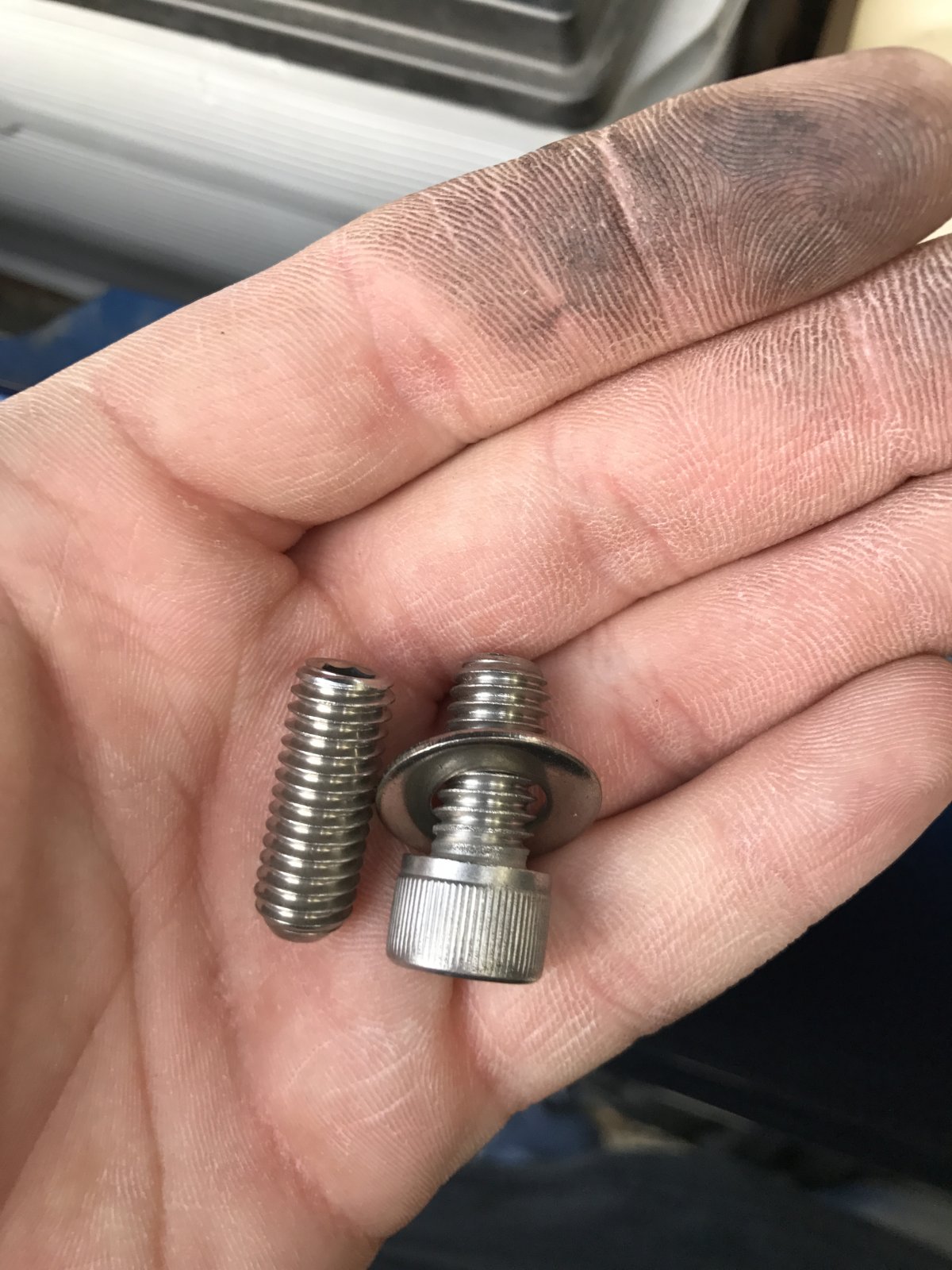

Yes I posted about this in my build thread! you can get some flat 4 or 6 spot terminals for the side post battery. Mine were from sky high car audio. I used 3/8-16 Allen bolts iirc. Worked great.

Find a local welding supply place and get some weld cable. they should have it on spools. Or you can order it online as well.

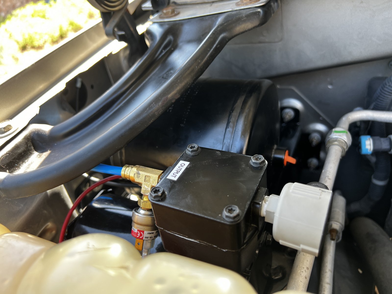

Anybody have the smog pump in their truck? I'm curious how they mount that... I may take a little inspiration from that to mount the compressor.
