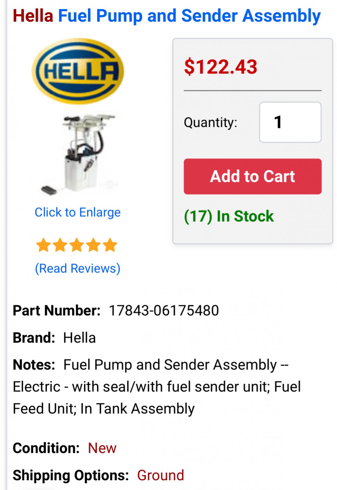

Parts Geek (Delphi, AC Delco & Hella aka: Continental/and Amazon (bosch) had the least expensive pumps for the 07-14 series.
These are all the companies that GM sources their OEM pumps from globally and then pays the to put their GM logo on the part and sometimes triple the price. DO NOT get any other brand or you’ll pay almost exactly when the generic warranty expires and (BAM) then again for labor.
Check out those two places for your earlier year truck and have a good Indi shop, preferably a diesel shop install it. It’s commonplace for them to drop a GM tank and no biggie. Non diesel shops will whine about it and probably charge double because they don’t like doing it.
petethepug
Michael
May 4, 2016
3,792
4,362
SoCal
A quick look shows Parts Geek the least expensive and Amazon has the Delphi & Bosch for about $60 more. Verify you also get a new fuel level sender.
