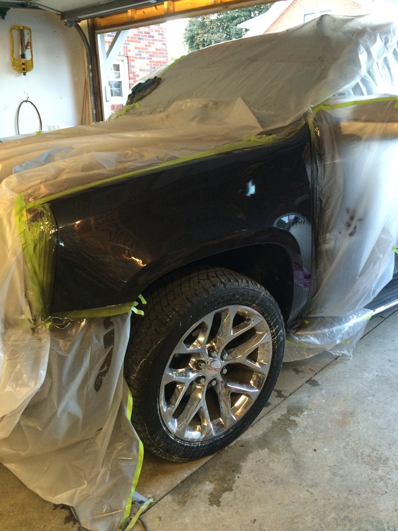

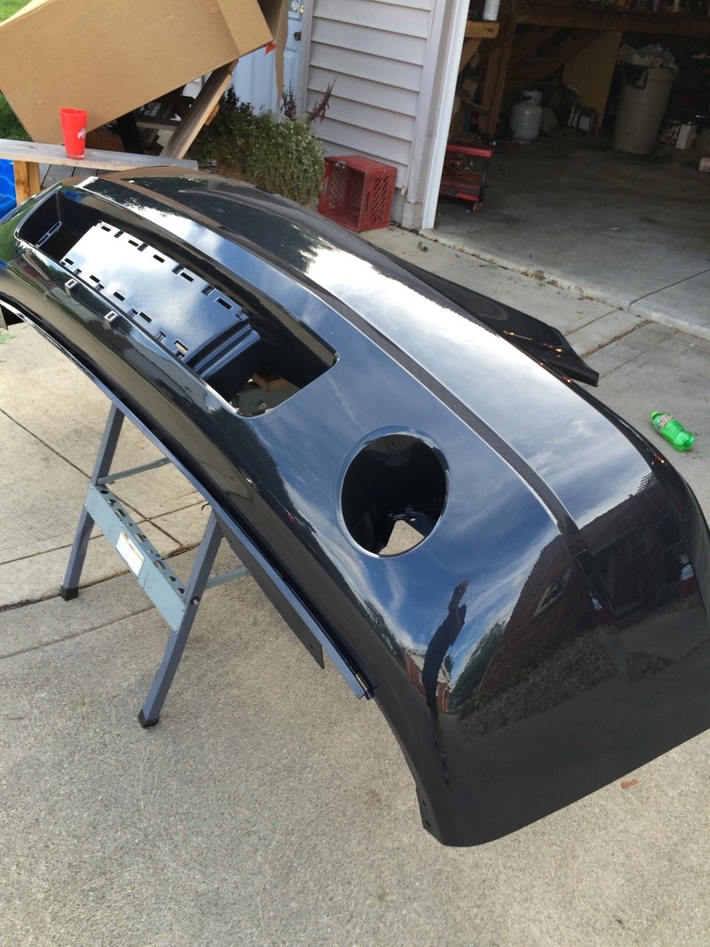

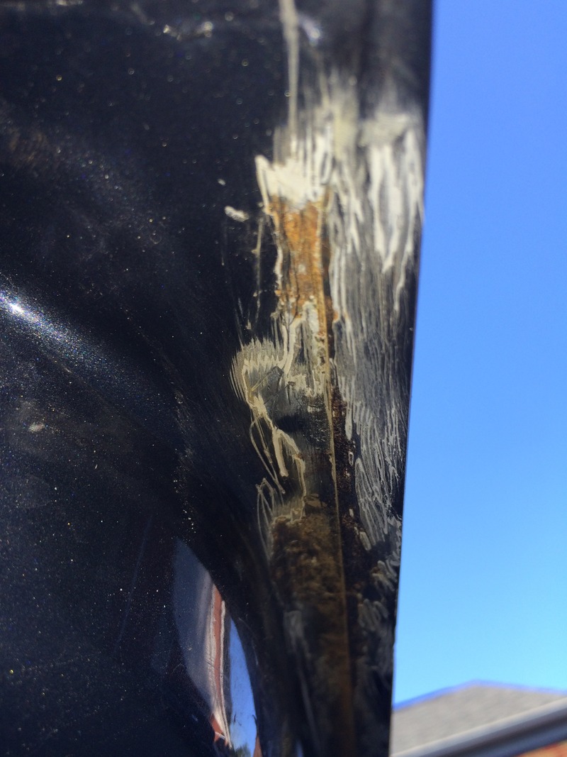

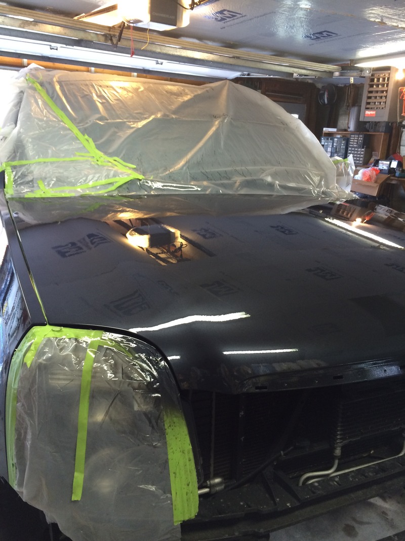

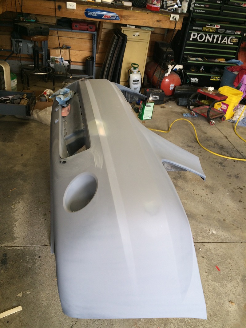

The luxury of having a high mileage vehicle in Ohio has caught up to me. When I bought it, I knew there was a little paint work done to the front. Looks like the PO bumped something and someone half-assed the repair to the bumper cover. That also caused the paint to crack at the spot where the fender/bumper meet and was rusting. I cleaned all that up, repaired a ding on the hood, and repaired the door edges and seam sealed them. Ended up basically spraying the whole from clip lol.

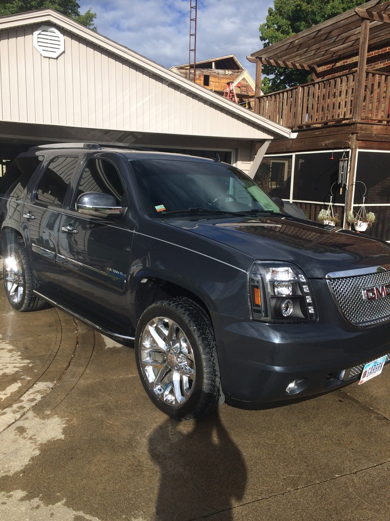

Looks great! Is that stealth gray? I think mine is the same color. Also, how do you like your headlights?

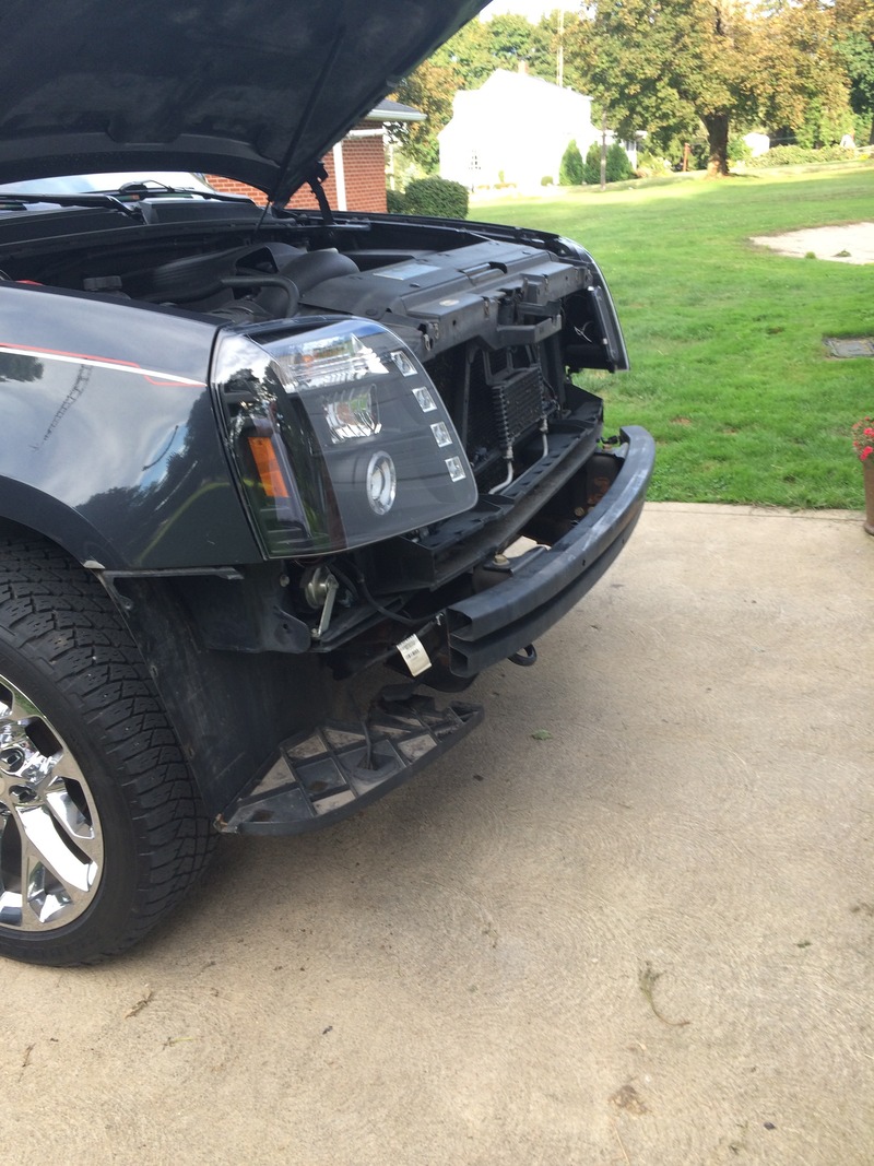

Yes it is. I love these lights. I also have LEDs for the low beams and it is a vast improvement over the oem setup. Biggest issue was aiming because I couldn't use an aiming machine and the adjustment screws aren't in an area to access them without removing the assemblies.
