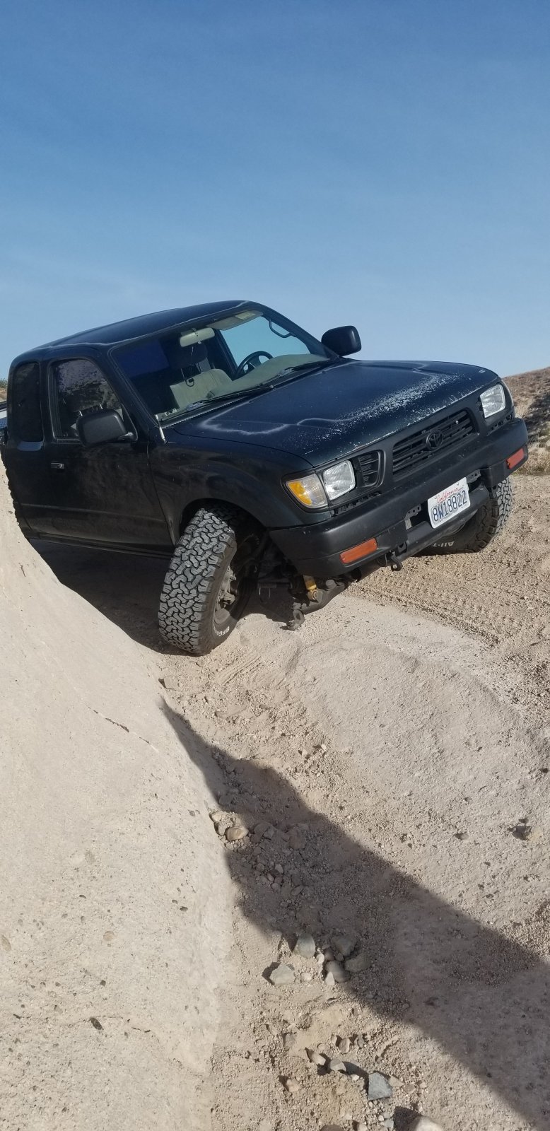

Yea trying to prevent this! Especially out in the sticks. He also broke font cv shaft. Told my wife it's to prevent future costs!
