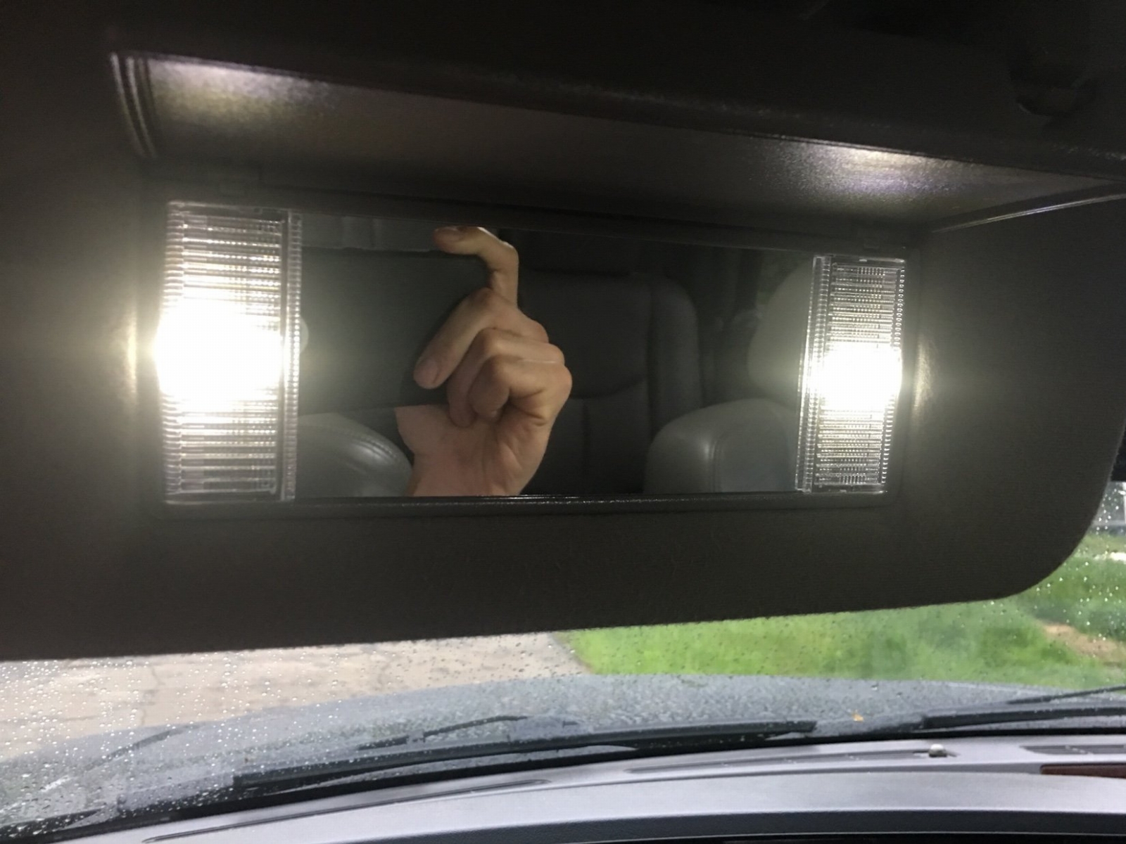

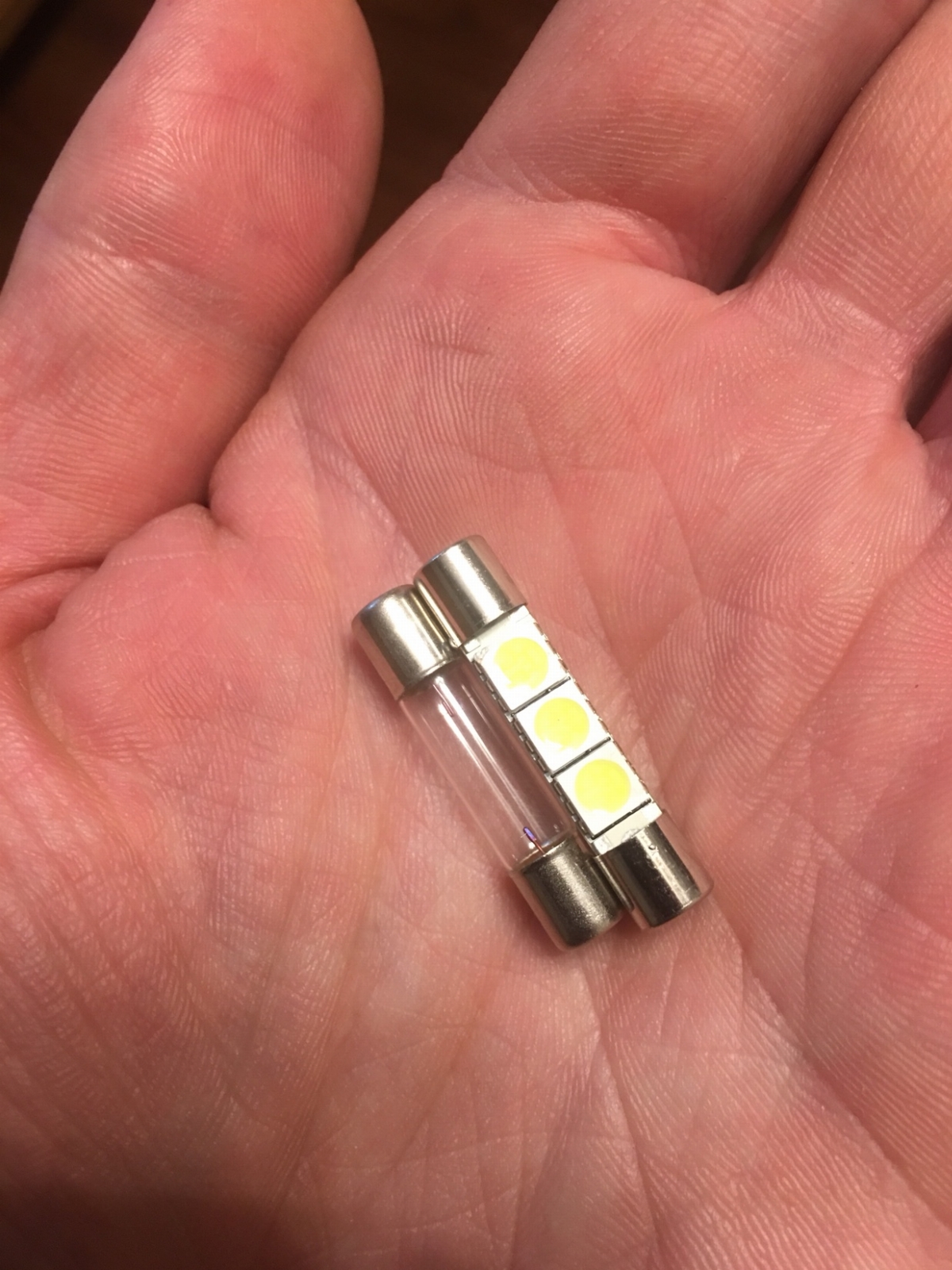

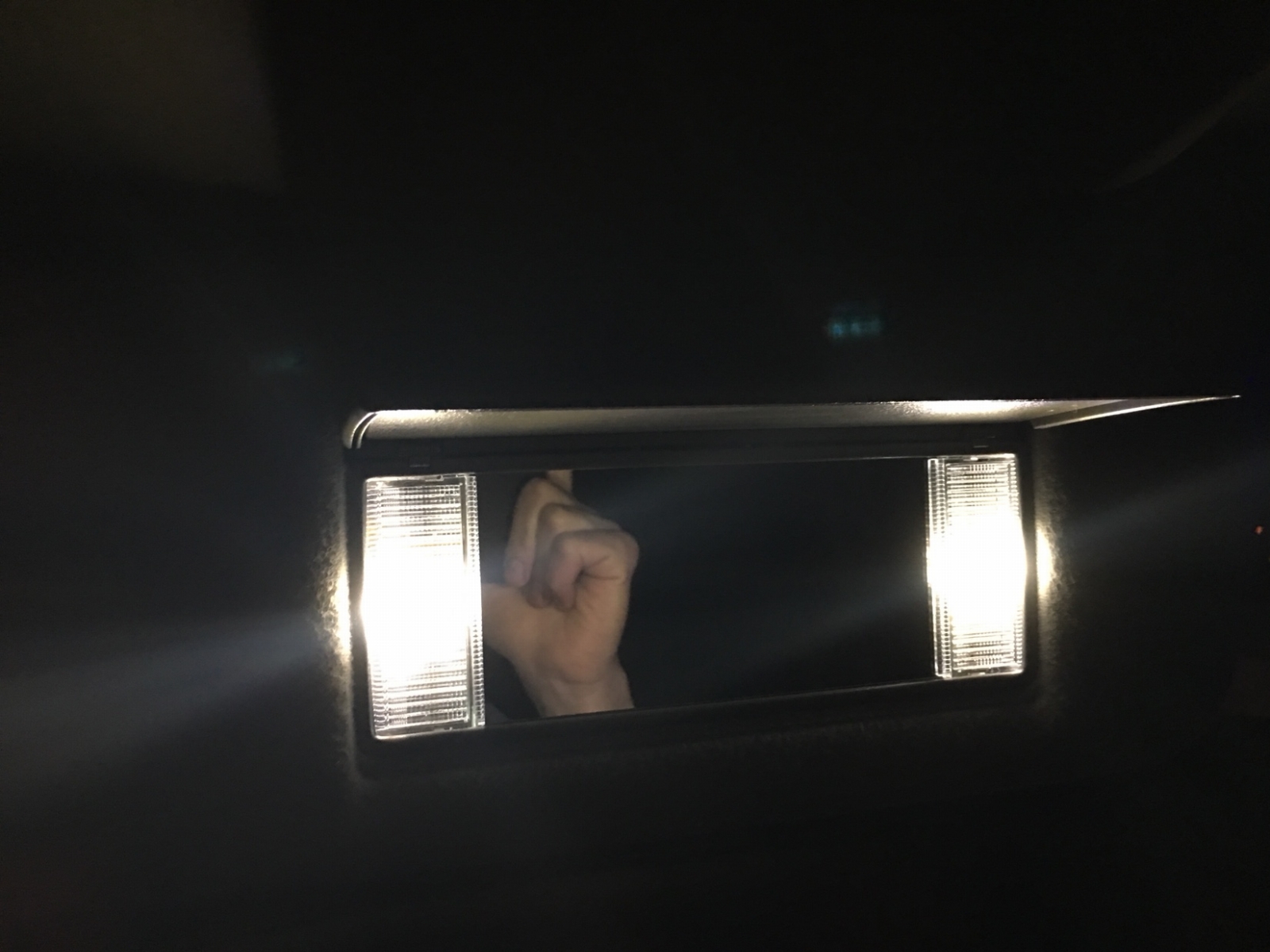

I installed some LED’s in the vanity lights, they are slightly bigger then the stock bulbs but fit perfectly.

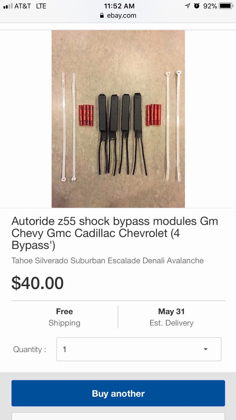

Ordered some resistors for deleting the Autoride, I’m most likely going to get 2” lowering springs for the rear to get it to sit level, turn the front keys down a hair since the front will sit a half an inch higher depending on how much is left in the keys I might have to get lowering keys, going to go with Bilstein 4600 shocks or Belltech, don’t want to go crazy low due to it being my DD and dealing with snow during the winter.

Night shot of the LED’s in the vanity lights

Visor LEDs look good.

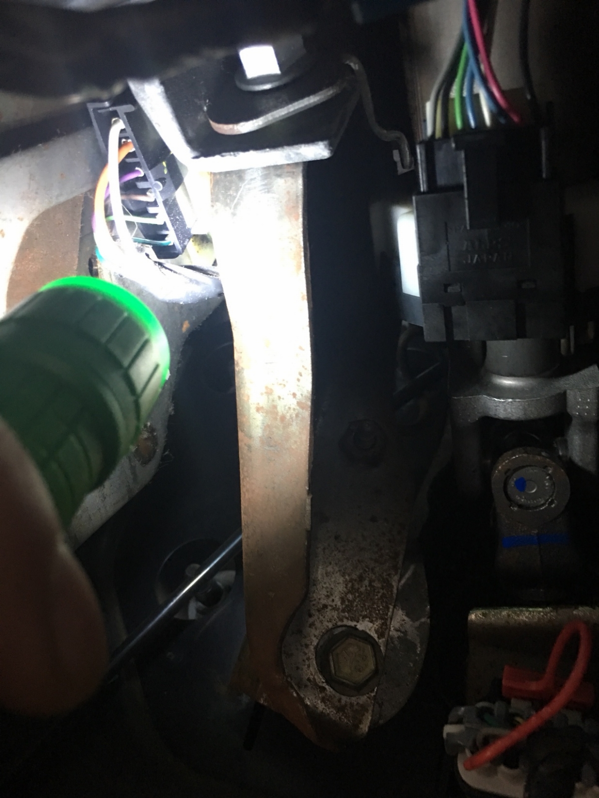

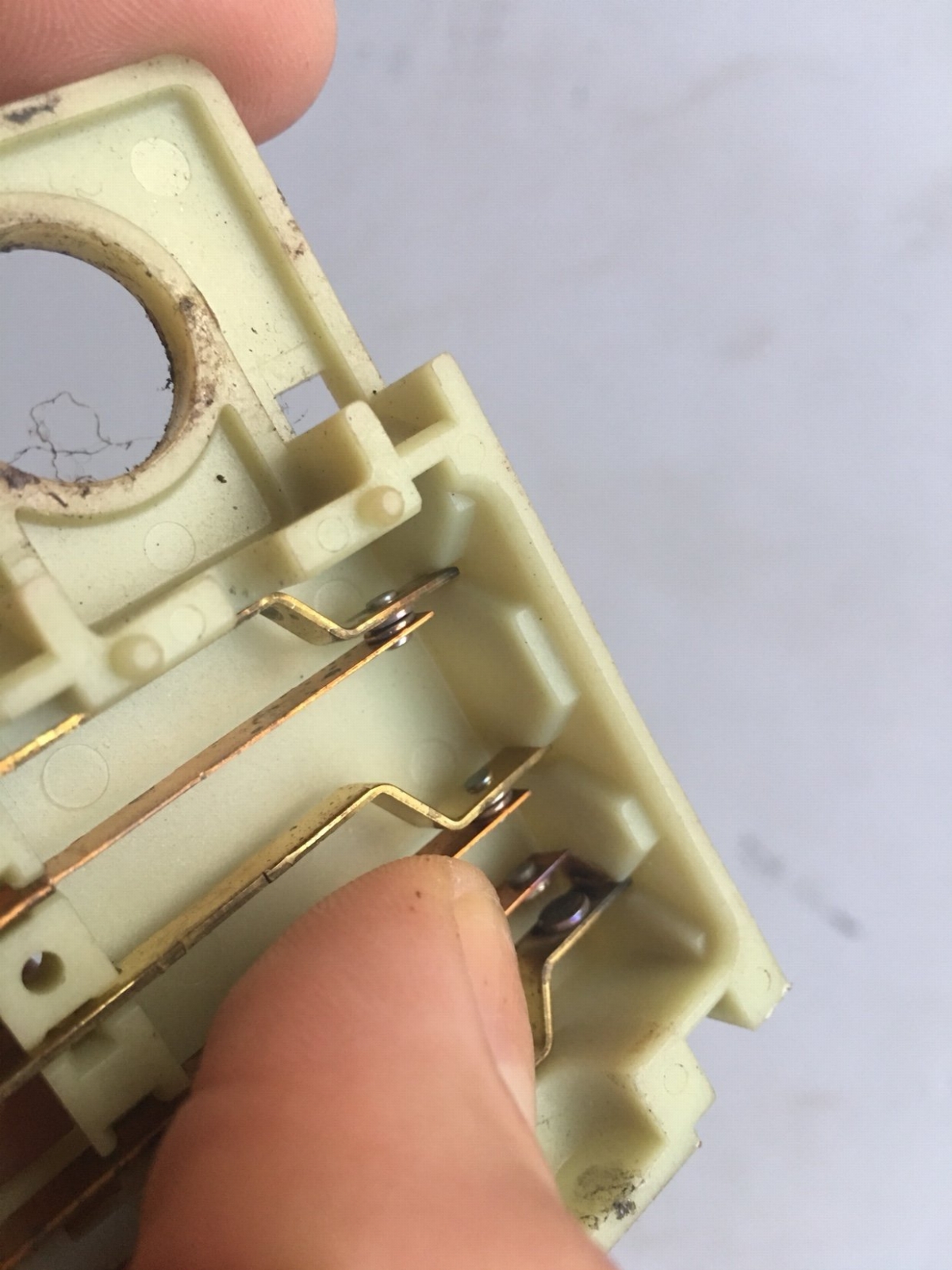

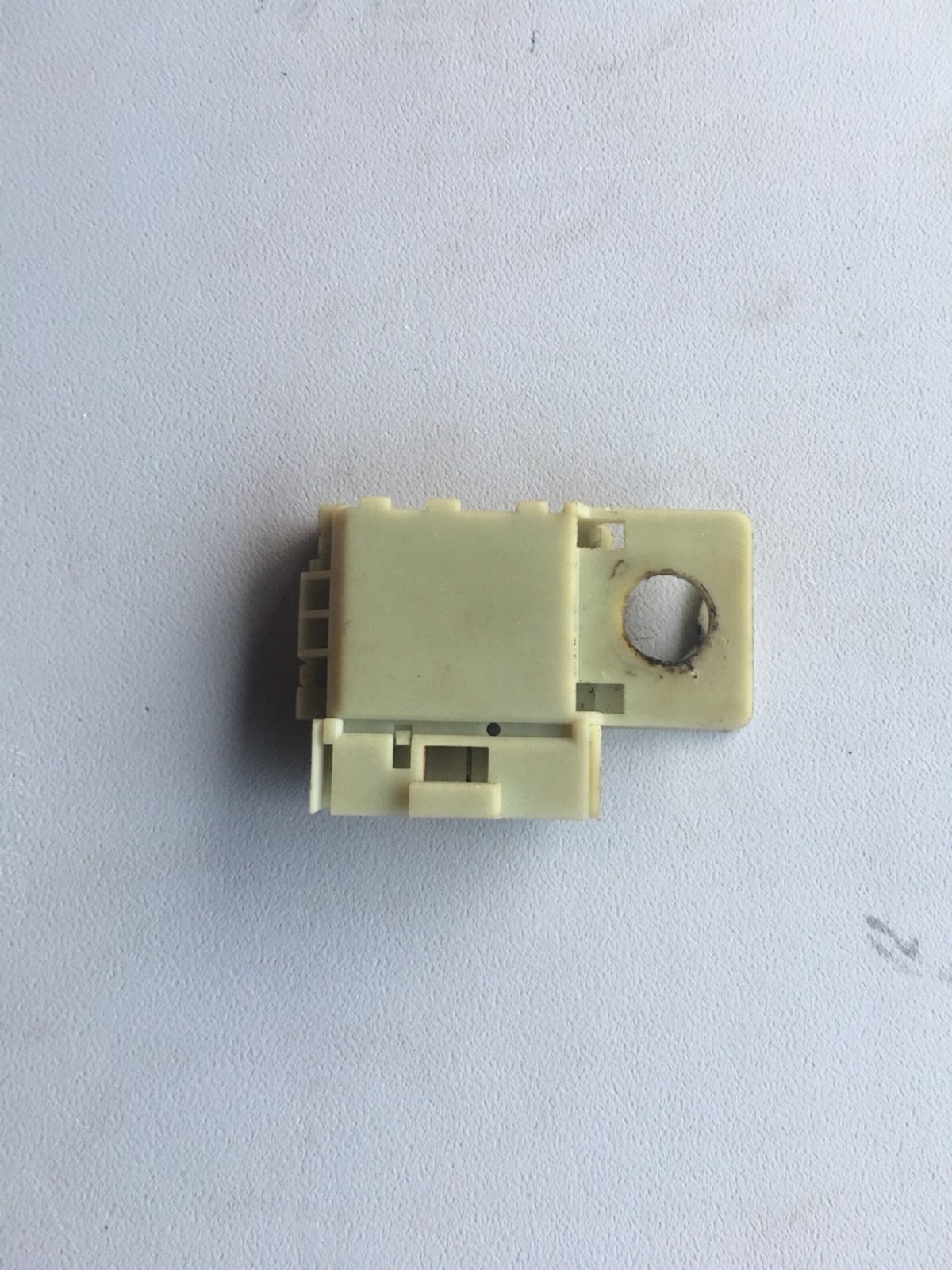

Coming home from work today this kid in a nice old late 70’s Chevy pickup is trying to get my attention at the stoplight, so I roll down the window he mentions that he didn’t see my brake lights come on when I stopped, so I get home and check them and yup they are out, I checked some fuses they were all good so I pulled the brake light switch and it’s bad so ordered an AC Delco off Amazon should have the Escalade back on the road Thursday night, with the adjustable pedals it’s a pain to get at.

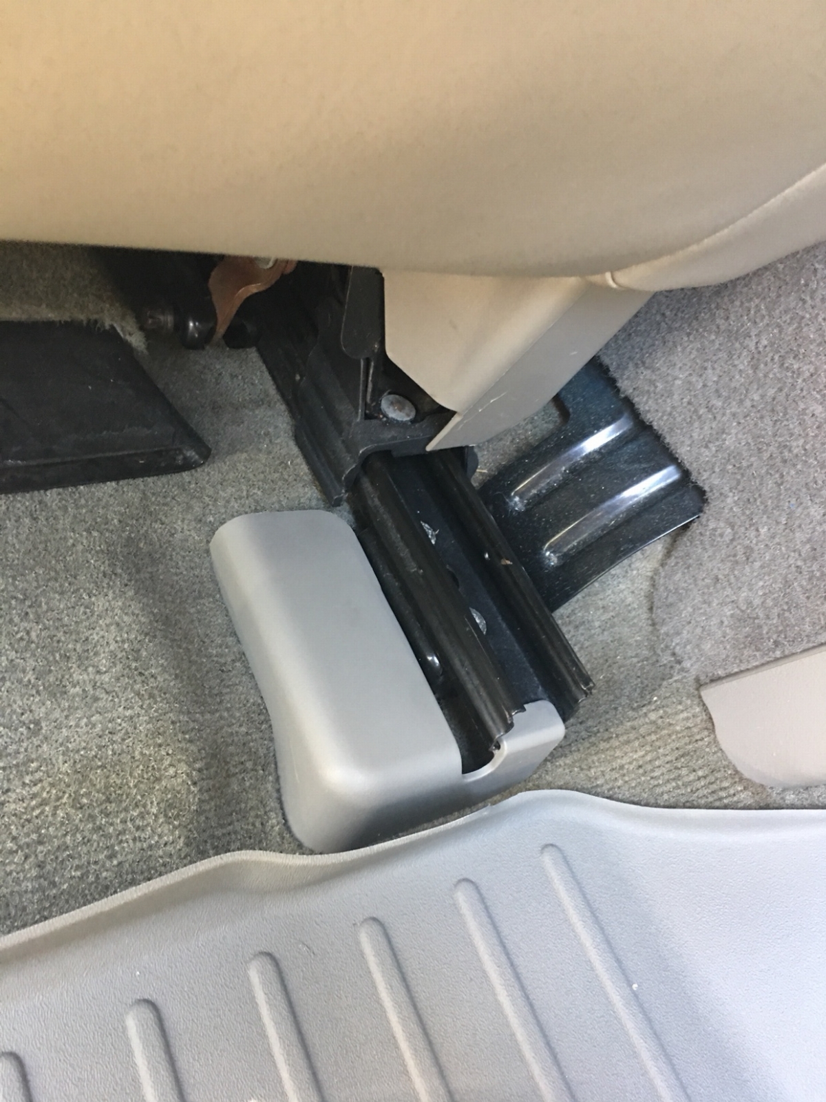

Found this missing piece of seat trim
