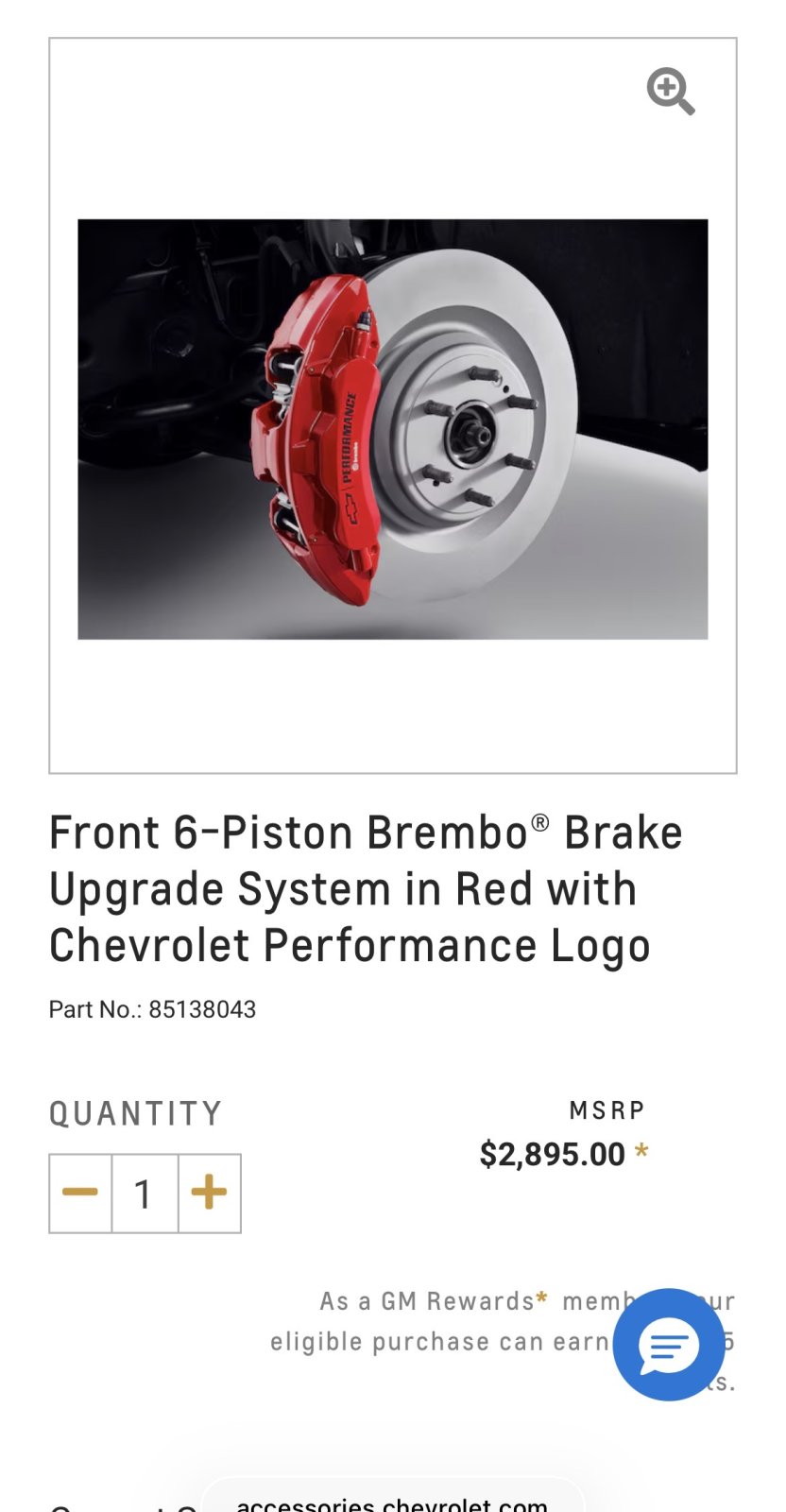

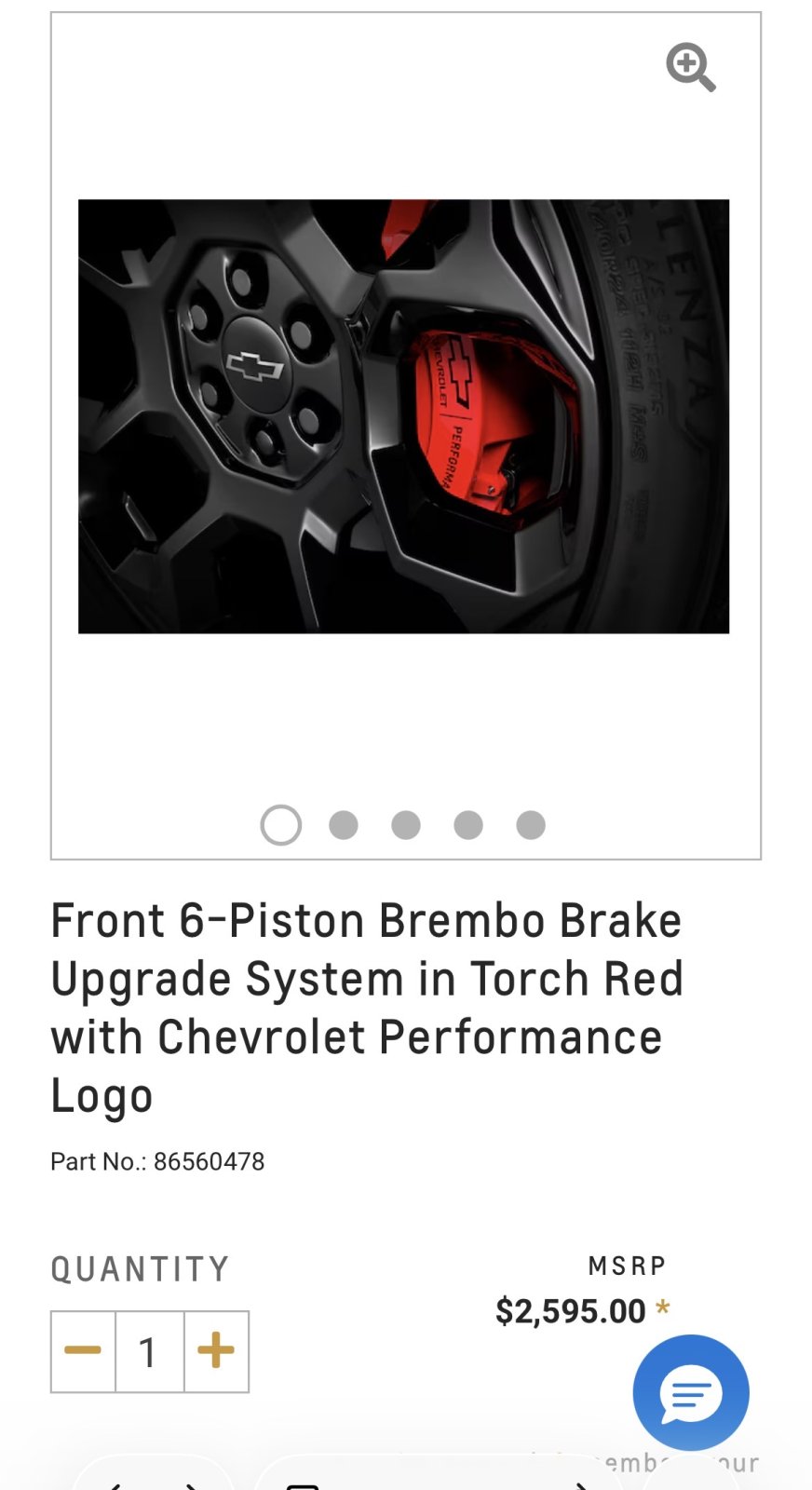

Another interesting thing is that GM makes 2 Front Performance Brake kits.
The description sounds identical, 6 piston Brembo torch red etc.
The one kit is $2500 and when you pull it up on the GM site it says “does not fit 2024 Tahoe”.
The other is $2800 exactly same description and it says it “fits 2024 Tahoe”
From the official GM site.

The expensive one is correct fit for my High Country
I did get 20% off a “winter sale” and some extra off with GM points and I ended up paying just over $2100

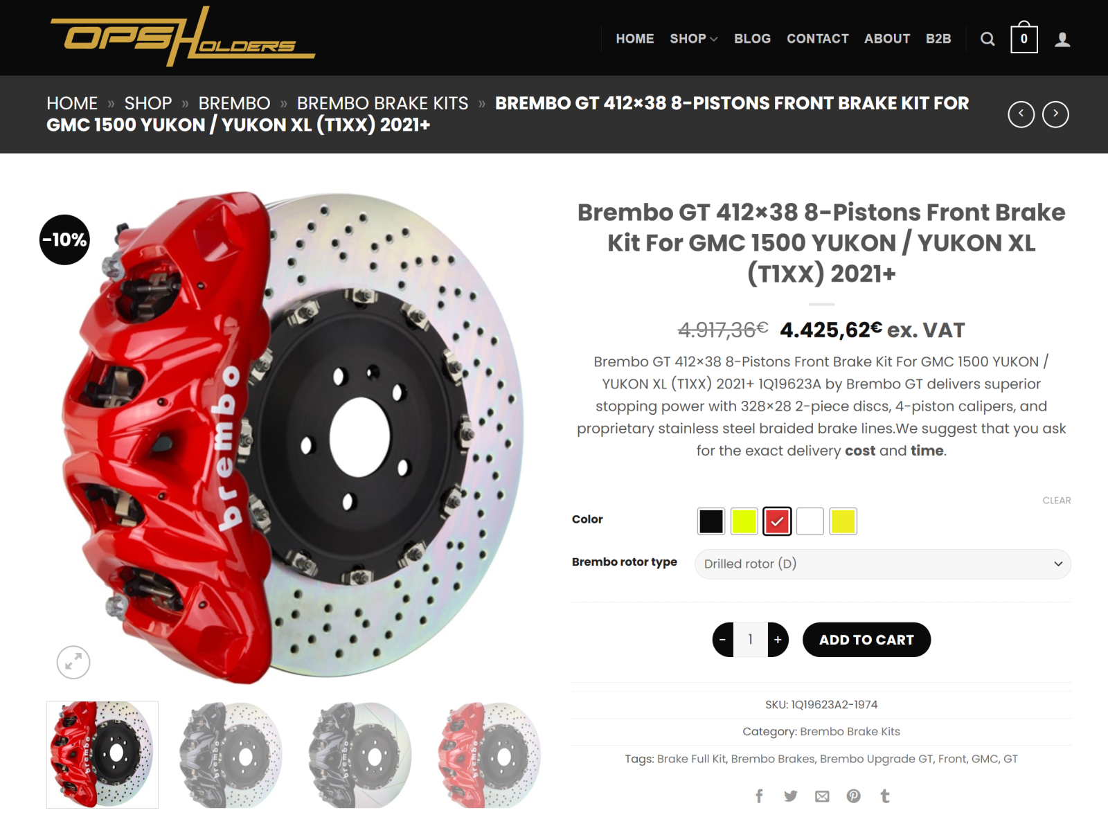

No, it does not show 100%. That percentage gradually decreases over time. Back when I bought my Yukon AT4, I took it a step further with the brake upgrade kit and went directly to Brembo. It wasn't offered at the time when I bought the truck, but at the same time, the factory Brembo kit was a bit too small for my taste. 3 months later I bought Brembo's 8-pot kit. Bigger rotors, bigger calipers. Mind you, I also had bigger wheels to accommodate that setup. The stock wheels can still fit (barely), but the center hub will need to be bored out slightly.

To be on the safe side, 22's would fit comfortably without any issue - provided you have enough offset to clear the calipers. Last year I tried putting my stock 20's back on, and there were only millimeters of space between the calipers and the wheel barrel. The problem with these Brembo 8-pot brakes is the center hub. The two-piece rotor hub is slightly larger than the OE, so you'd have to bore out your factory wheel a little to get them to fit or buy an aftermarket wheel like I did. Otherwise, it's a magnificent brake setup to have.

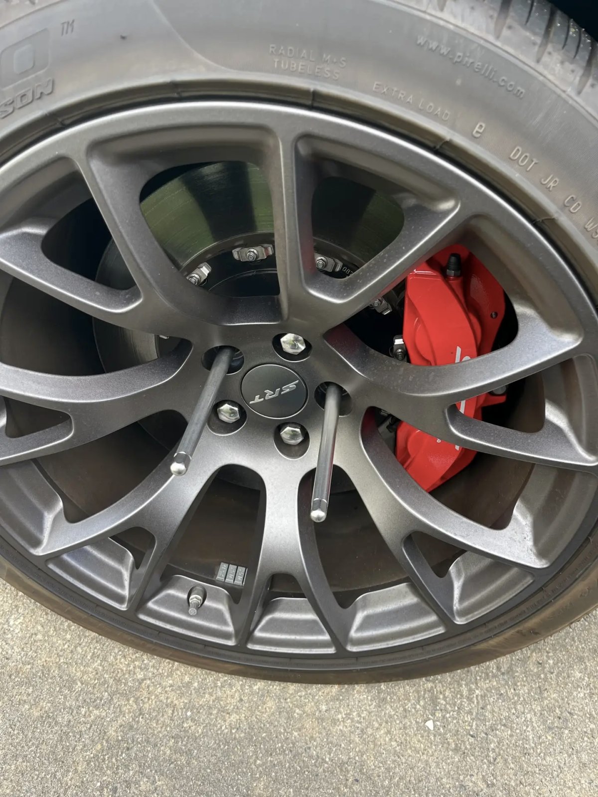

You guys with the big brake kits the barely clear the wheels I’d recommend using stud extenders when changing your wheel. Makes it easy so you don’t knock or scuff the wheels or calipers;
I use them in my car that has brembos and 20”
Wheel that barely clears.
olyelr
Mar 19, 2011
1,896
973
Elk Rapids, MI
Ive never seen those before…great idea !
