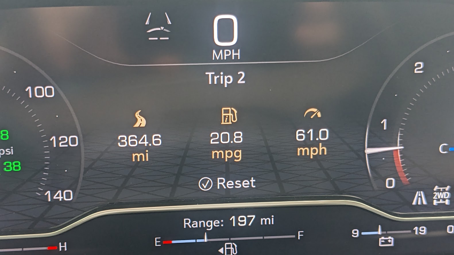

jfoj
Aug 9, 2012
1,227
1,089
I am currently driving on 0-40 oil, I understand that the engine is new, I understand that the oil is thicker, but fuel consumption has increased significantly. 2MPG, is this in the city or in highway mode?
Not sure where anyone came up with a 2 MPG hit running 0W40 vs. 0W20.
This was just one trip with the 0W40 and there was a bit of stop and go driving in this average.
This is also with the Auto Stop/Start and DFM disabled!

jfoj
Aug 9, 2012
1,227
1,089
Post your mileage before the switch if you are implying you didn’t lose 2mpg with the switch.
Here is the problem, 0W20 went out of my engine at 544 miles and I do not have any screen shots from this point in time. I also have had the Auto Stop/Start and DFM disabled since 275 miles.
The 20.8 MPG was also with 3 adults and a fairly packed cargo section. The route I took was fairly flat with some decline in altitude because I ended up at Sea Level, so there clearly is an advantage due to the terrain. It is also a function on how aggressively I drive with my right foot and how many trucks and rolling roadblocks I need to dispatch.
The EPA Highway rating of my 6000 brick is 18 MPG, 14 MPG City and 16 MPG Combined.
Assuming 2 MPG hit for 0W40 oil and disabling the Auto Stop/Start and DFM, I guess I should be getting close to 26 MPG on the highway based on the way some people think around here. Not going to happen in one of these vehicles.
There is absolutely NO 2 MPG hit running 0W40 vs 0W20, might be 0.1-0.2 MPG at the highest. Someone here posted this 2 MPG non-sense, they just pulled that number out of their backside.
The EPA and manufacturers would have been running 0W20 25 years ago it they could get 2 MPG with just a oil viscosity change.
Not sure where people dream up these ideas.
I really do not care what my fuel economy is, I am not trying to for the highest fuel economy, I am trying to get my engine to last more than 50k miles. Durability and reliability is far more of a concern that what is spent on fuel. Regardless of what I drive with an ICE power plant, I will be spending money on fuel.
Here is a shot of me Hypermiling in town with a slight decline in grade going no faster than 45 MPH. 9 minutes, distance 4.9 miles. This truely was a bit of Hypermiling because I was spending a fair amount of time in DFCO (Decel with Fuel Cut Off). 24 MPG, gotta love this, but the moment I need to climb a grade, this story is over!

Vladimir2306
May 18, 2023
1,064
1,251
I have already realized that you are the most important specialist here on the forum, and your opinion is the most important. My consumption on oil 0-40 has increased. Where I used to drive on oil 0-20 with a consumption of 14 liters per 100 km, according to the American it is 16.8 mpg, now I have 15.4 liters per 100 km, or 15.3 mpg on oil 0-40

jfoj
Aug 9, 2012
1,227
1,089
Put 0W20 back in your engine and see what happens.
But also understand, your vehicle just went thru a complete heart transplant so you have a few more variables than just a different oil viscosity.
Also realize that your engine assembly is basically new, it will loosen up over time and your fuel economy will increase.
Scarey
Oct 15, 2024
310
270
The only variable change is the oil?
Vladimir2306
May 18, 2023
1,064
1,251
That's exactly what he said my engine was new. Why do you repeat my own words? Of course, I will fill 0-20. I have another 500 km to run-in, after which I will return again to 0-20 oil
