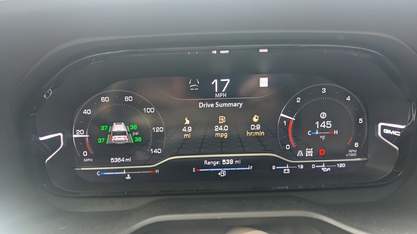

Here is the problem, 0W20 went out of my engine at 544 miles and I do not have any screen shots from this point in time. I also have had the Auto Stop/Start and DFM disabled since 275 miles.
The 20.8 MPG was also with 3 adults and a fairly packed cargo section. The route I took was fairly flat with some decline in altitude because I ended up at Sea Level, so there clearly is an advantage due to the terrain. It is also a function on how aggressively I drive with my right foot and how many trucks and rolling roadblocks I need to dispatch.
The EPA Highway rating of my 6000 brick is 18 MPG, 14 MPG City and 16 MPG Combined.
Assuming 2 MPG hit for 0W40 oil and disabling the Auto Stop/Start and DFM, I guess I should be getting close to 26 MPG on the highway based on the way some people think around here. Not going to happen in one of these vehicles.
There is absolutely NO 2 MPG hit running 0W40 vs 0W20, might be 0.1-0.2 MPG at the highest. Someone here posted this 2 MPG non-sense, they just pulled that number out of their backside.
The EPA and manufacturers would have been running 0W20 25 years ago it they could get 2 MPG with just a oil viscosity change.
Not sure where people dream up these ideas.
I really do not care what my fuel economy is, I am not trying to for the highest fuel economy, I am trying to get my engine to last more than 50k miles. Durability and reliability is far more of a concern that what is spent on fuel. Regardless of what I drive with an ICE power plant, I will be spending money on fuel.
Here is a shot of me Hypermiling in town with a slight decline in grade going no faster than 45 MPH. 9 minutes, distance 4.9 miles. This truely was a bit of Hypermiling because I was spending a fair amount of time in DFCO (Decel with Fuel Cut Off). 24 MPG, gotta love this, but the moment I need to climb a grade, this story is over!
Lmao. Dude if we wanted fabricated results I could show you a crazy mpg screenshot of my diesel going downhill. But that would be disingenuous.

I have already realized that you are the most important specialist here on the forum, and your opinion is the most important. My consumption on oil 0-40 has increased. Where I used to drive on oil 0-20 with a consumption of 14 liters per 100 km, according to the American it is 16.8 mpg, now I have 15.4 liters per 100 km, or 15.3 mpg on oil 0-40

I did not fabricate results, I showed results of a very ideal situation where I even claimed I was Hypermiling. Nothing wrong there. As I mentioned "24 MPG, gotta love this, but the moment I need to climb a grade, this story is over!".

Give it a shot, would like to see how much the Diesel do on a Hypermile route.
My route was a fairly flat road with minimal throttle input, no stop lights and an approximate overall elevation drop of around 250 feet, but I may need to verify just to be sure.
I did this to bust my buddies chops that had an Acura MDX and was planning on getting a 2025 Yukon Denali XL, which he finally did get, but he only has 174 miles on it and he has had it 6 weeks! He spends more time sitting in it in his garage with the Battery Tender connected playing with the big screen TV in the dash.

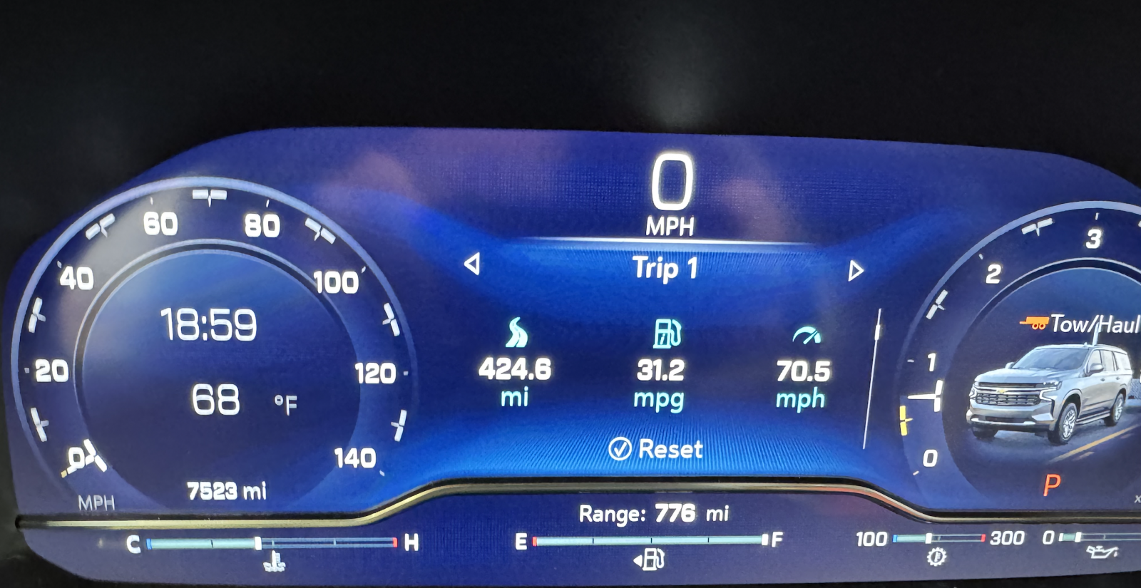

No hypermiling but 31.2 mpg from Lino Lakes MN to Oacoma SD (hand calc was a couple of tenths higher). Not much wind, temps in the 70s and going the speed limit (80 mph for most of South Dakota). Pic was taken right after filling the tank.

@Jay P Wy
Definitely a Durmax with the Range showing as 776 miles!
We need to start a Hypermile thread to post the dash fuel economy display to see how much variation there may be. I am sure some winners could be coming down off some higher elevations as long as the roads and traffic do not slow the vehicle too much.
I have the Fuel Economy #1 display almost for the vehicle life, I reset it at about 600 miles then decided to leave it. I think I am around 17.4 MPG for the majority of my 8000 miles to this point.
