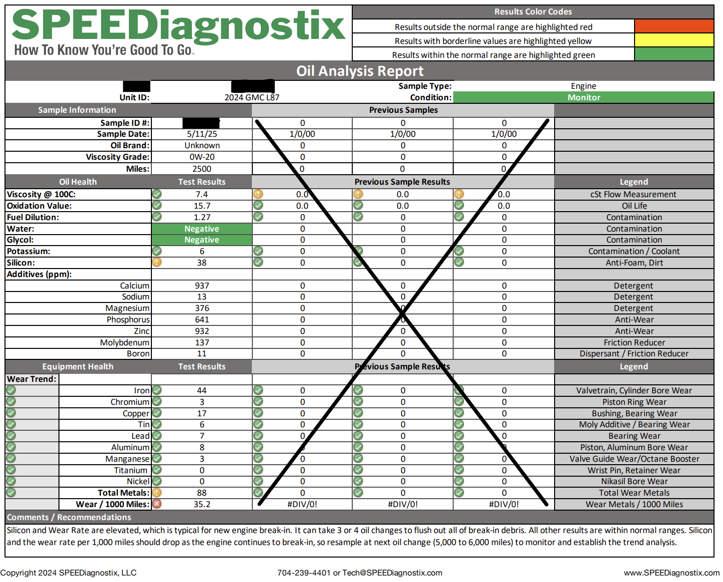

OK here is the first oil analysis I've done on this truck. I use this service on both my race cars and never thought I would need it on the tow vehicle :mad:
This sample was from after removing the dealer changed 0w-20 that was put in around 7000 miles during it's "first scheduled service". It came out around 9500 miles after learning about the recall.
I swapped it out for 0w-40 M1. Lake suggested running 2 more changes through it before sending in the next sample (0w-40) to analyze. So I will do this after two 3000 mile intervals. Truck now has about 10.5k on it, so that will be at around 16-18k miles.
Lake says they see that it typically takes 3 to 4 oil changes to finally remove all of the break-in debris and for the wear rate to drop into the normal level. More frequent oil changes early on gets this process completed sooner. So that is the plan to keep the oil pressure up and the blood pressure low.
PS - I have zero affiliation with Lake other than being a happy customer. I particularly appreciate the time he takes to provide answers to specific questions. ymmv.
See his notes at the bottom of the graphic.

Yea, same company I use. I had a specific problem and he called me and I texted back with answers and now have his personal phone number. Cool guy and great videos at you tube.
Pretty much what I would expect at that mileage. Too bad you didn't go 5000 miles, would have been interesting to see.
