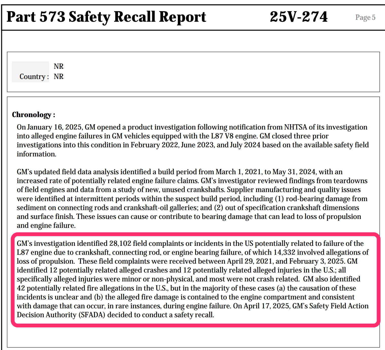

28,102 "Field Complaints"
14,322 Involved Allegations Of Loss Of Propulsion
"On April 27, 2025 GM's Safety Field Action Division Authority (SFADA) decided to conduct a safety recall."
Ironically this was AFTER NHTSA sent GM a Preliminary Evaluation request and required GM to respond back I believe with a A LOT of documentation.

Yes, that is the point...NHTSA got after them.

Like i said it's hardly anything. I've fixed thousands of wave plates and transmissions of the same type at one dealer.
You fail to realize that there is a lot of vehicles out there and this is such a small number it actually is insignificant.
Now there's a recall. And now there's a fix. And that's that.

Manufacturers would recall much quicker these days because it preserves brand reputation.
You would think so, its a double edged sword and I must admit the very best of us could wait until the last moment to see if we can get lucky... recall too early and you can risk brand reputation over something really small, and recall too late and you can risk brand reputation as well.... here this time, I'd say it was a bit too late for GM's own good.
"On January 16, 2025, GM opened a product investigation following notification from NHTSA of its investigation into alleged engine failures in GM vehicles equipped with the L87 V8 engine. GM closed three prior investigations into this condition in February 2022, June 2023, and July 2024 based on the available safety field information."
"A series of crankshaft and connecting rod manufacturing improvements implemented on or before June 1, 2024, addressed contamination and quality issues."
GM knew something was wrong since about 2022, but they likely waited it out to see if the "early field failures" already happened and if the "intrinsic failure rate" would be low enough to just warranty as needed... but it does look like they found a 'fix' and still chose to be quiet.... but when the NHTSA investigation opened up the cat was out of the bag.
This isn't like most other recalls as it took them 4 different investigations to close on the root cause, and to be honest do we really think they have actually fixed the problem now?
The FAQs on this recall said the 0W-40 oil will offer an "increased further level of protection"... and given that no one has explained to me yet why the 6.2s on the truck can live with 0W-20 when the C7 corvettes need the 0W-40, I am still very perplexed. Are the bearing clearances different ? A truck weighs twice as much as a corvette so the engine is more likely to be lugged. The only differences I know of between the truck and the corvette 6.2s is in the top end (intake manifold, maybe cam, lifters, valve springs).

Millions of current gen 5.3's are out there without these issues running on 0W20. This is not an oil issue, but a manufacturing defect. 0W40 looks to be nothing more than a holy grail fix to marginal engines. Corvettes use 0W40 because of the high rpm's and possible track use.
