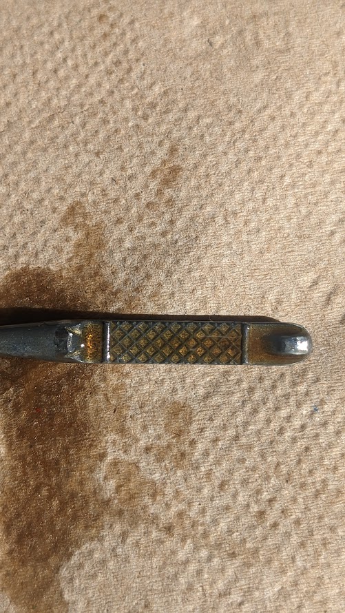

You are the original owner of a 2023 and have around 12k miles and have sludge in the engine?? Something is wrong here. If your oil is coming out black especially, if you are changing the oil 2x a year something is wrong. Maybe you are driving VERY short distances. With the large oil capacity of these engines, if the ambient temperature is below 50F, it typically takes close to 30 minutes of driving to being the oil up to the engine coolant temperature. Also allowing the engine to warm up at idle, does not warm the oil up nearly as fast as starting the engine and driving the vehicle. If you start the engine, allow the RPM to drop and stabilize then drive he vehicle. Do not cold start and allow the engine to warm up for 10-15 minutes, it will not warm the oil up, it will likely fuel contaminate the oil.
Given you have so few miles on a 2023 model, you either drive very short distances, to the store, church or locally or only drive on longer trips. When I start my truck, more often than not the trip will take between 2 1/2 - 6 hours. I do not make many short in town trips and even if I do, these trips are typically 30+ minutes of driving given where I live and where many of the stores are located.
Picture of my dipstick with 1500 miles on current oil as well as the same oil on the towel.

I'm 2021 Yukon 6.2L with 67K miles. Had recall/oil-change (0-w40) about 2K miles ago. Here's a pic - the oil looks OK to me. I'm not an expert but I have seen 'dark' oil in earlier years (other vehicles) and this color doesn't seem alarming - seems OK.

Your oil looks good for 67k miles on the engine and after 2k miles. Keep in mind probably at least 1 quart or more of dirty oil is left in the oil cooler, oil cooler lines and in the engine when changing the oil so it is hard even immediately after and oil change to have pristine looking oil, but it should not look black by any means.
If the oil is black in any of these 6.2l engines, I would be worried the oil is getting cooked by a bearing ready to go!
