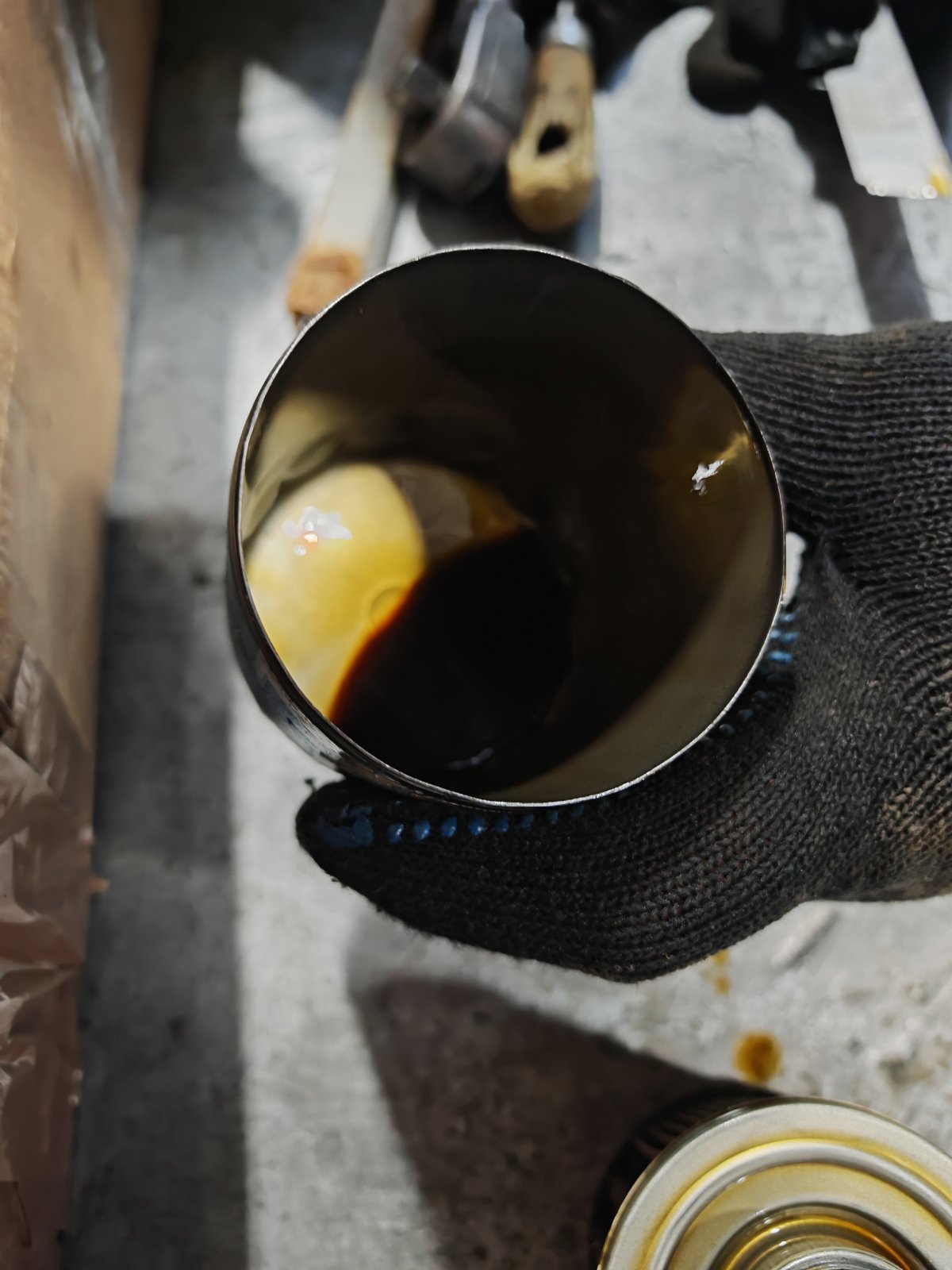

From the 2025 first oil filters I have cut open, the 2025's did not look promising for long term survival with the amount of metal and debris in the filter elements. The oil analysis did not look bad, but at 500 miles, you get a lot of wear in metals in the oil samples anyway. I will have a 4500 mile oil sample to review here soon on one of the 2025 that I have inspected the oil filter on and I have to get the 2nd oil filter and cut it open and inspect it as well.
This is not on my vehicle, but someone I know quite well.

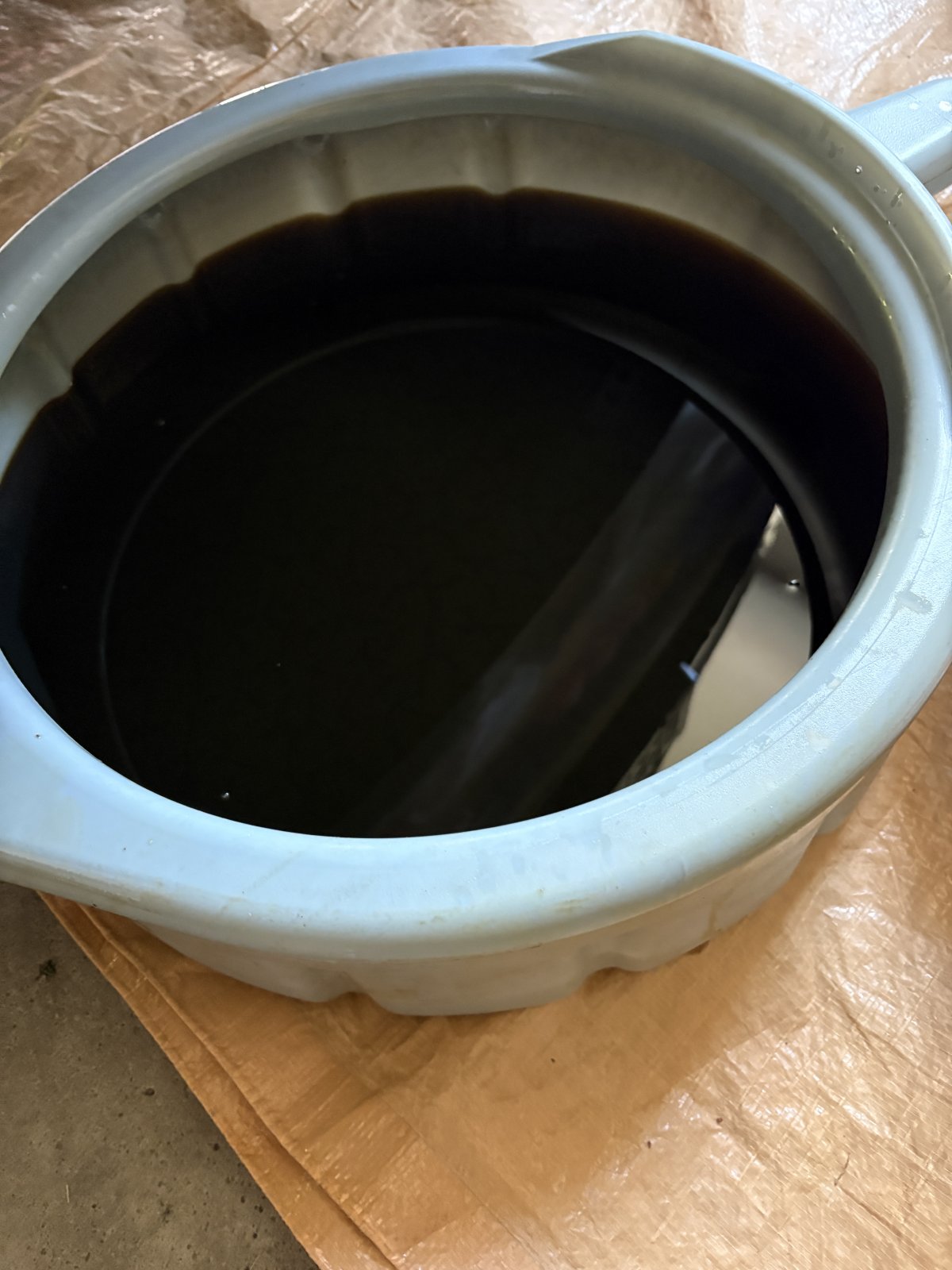

IMG_1434.JPGDid a quick oil change at 300 miles after I got my replacement L87. This was how dark my oil was. Just 300 miles. Sorry didn't do analysis this time.
jfoj
Aug 9, 2012
1,206
1,064
Ouch! Something clearly does not add up. The dealer either did not replace the radiator and oil cooler lines and/or something is cooking the oil IMHO. But again, the oil may look darker in the drain pan than it really is and/or drain pan had other dirty oil in it. Who knows???

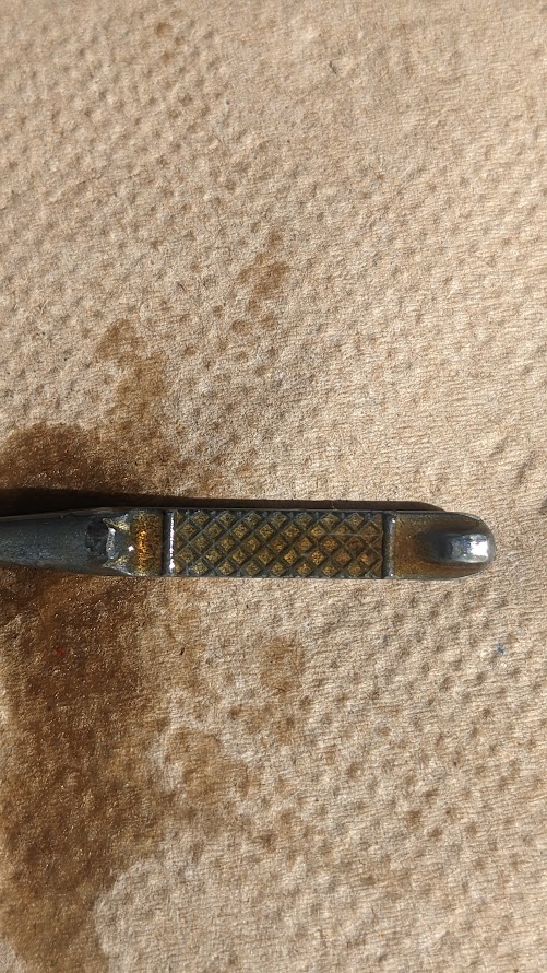

This is what the oil color on the dipstick looks like on my 2024 6.2l after around 1500 since the last oil change and a total mileage on the engine of around 11,500 miles. But caveat I changed the oil 4 times in under 11k miles. Oil changed at the following mileages: 540 miles, 3,484 miles, 5,923 miles and 10,093 miles. So my engine/crankcase/oil cooler and lines are probably cleaner than the typical 7,500 mile oil change. But also understand what the filter does not catch, stays in the crankcase and will only be removed with oil drains and frequent oil drains.

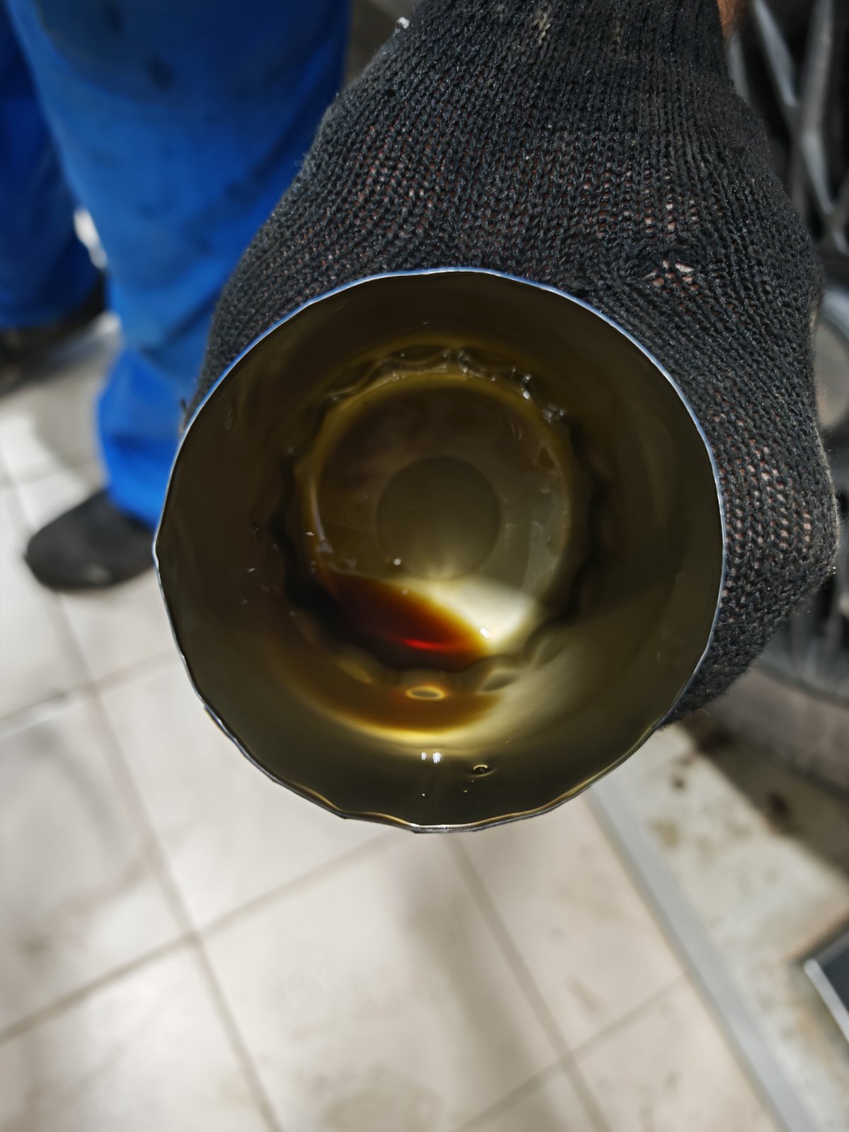

View attachment 470864Did a quick oil change at 300 miles after I got my replacement L87. This was how dark my oil was. Just 300 miles. Sorry didn't do analysis this time.
And this oil after 1500 miles, after replacing and the engine is new, it has a mileage of 2000 miles)
