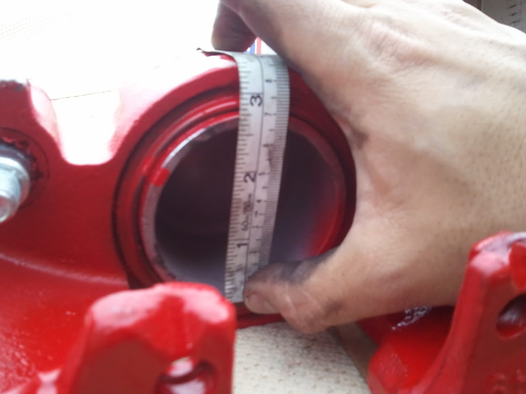

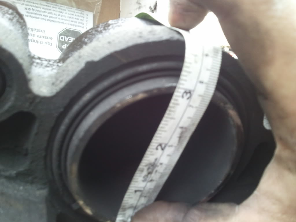

Looks good. why do the 3/4 ton calipers look smaller then the 1/2 ton ones??
and do you 3/4ton or 1/2ton pads with the 3/4ton calipers?

You do 1/2 ton pads with the 3/4 ton calipers. The 3/4 pads are too big and rub the rotor/hub area. They may be smaller, the piston is bigger though.

thats what i thought when you first put up pictures.. i was like hmm maybe the old looking like calipers are the new ones. lol wth.. whats so good about them then

Im not sure... I kno my Limited does have bigger brakes but I always thought that refered 2 the 11 inch drums... My stock calipers r definately bigger im thinking about switching back 2 see if it is goin 2 make a difference...

Don't the 2wd Limited had the bigger calipers from the factory? Same as the police package and the higher GVW 3/4 tons?
Looks like they might've given you the calipers from the light duty or 7200 GVW 3/4 ton instead.
7200 GVW = same as the 1/2 ton stuff
From what I understand the 2wd guys don't have issues with the pads hitting the hat section of the rotor, but the 4wd trucks have to go about it a different way.

Steamroller- I just confirmed wit rockauto and that exactly wat happen... So looks like I did this 1 ass backwards... Hahaha... I thought the bigger brakes just refered 2 the 11 inch drums...

2wd front
Get parts for a 2wd Limited (like Monster_e87 had originally) or Police package Tahoe
4wd front
3/4 ton GVW 8600 calipers and use half ton pads (what I did) or grind down the 3/4 ton brake pad backing plate so it doesn't hit the hat of the rotor. IIRC 99Yuk did this
The rear is either 10" or 11", use a tape measure. Just my opinion but get the stuff locally and save the blingy shit for trailer queens. :)
