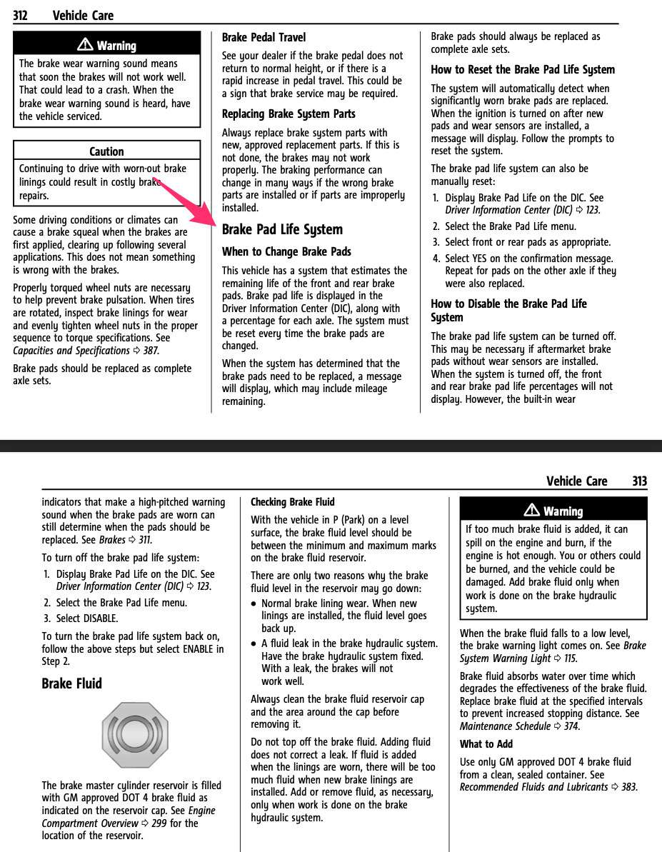

Pg 312/313 of the Owner's Manual Describes The system:

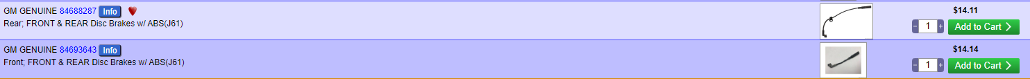

Thanks everyone! That is what I was looking for, the mechanics of it. I wonder if non dealers can replace the sensor
As long as they can source the parts it shouldn't be difficult to replace the wear sensor.
The big question is if you need a Tech 2 to reset the display, if it resets automatically with a new sensor, you can reset it like you would your tripometer, or an advanced ODB II tool would be needed.
See excerpt in post 2, system is supposed to reset; and it does imply the sensor needs replacement.
Don’t understand what you’re asking? You replace the sensor with the pads.. it wears right along with the pads. You don’t ever replace it independently.
they work by wearing out a layer of material and the vehicle monitors the change in material lost to estimate pad life.
