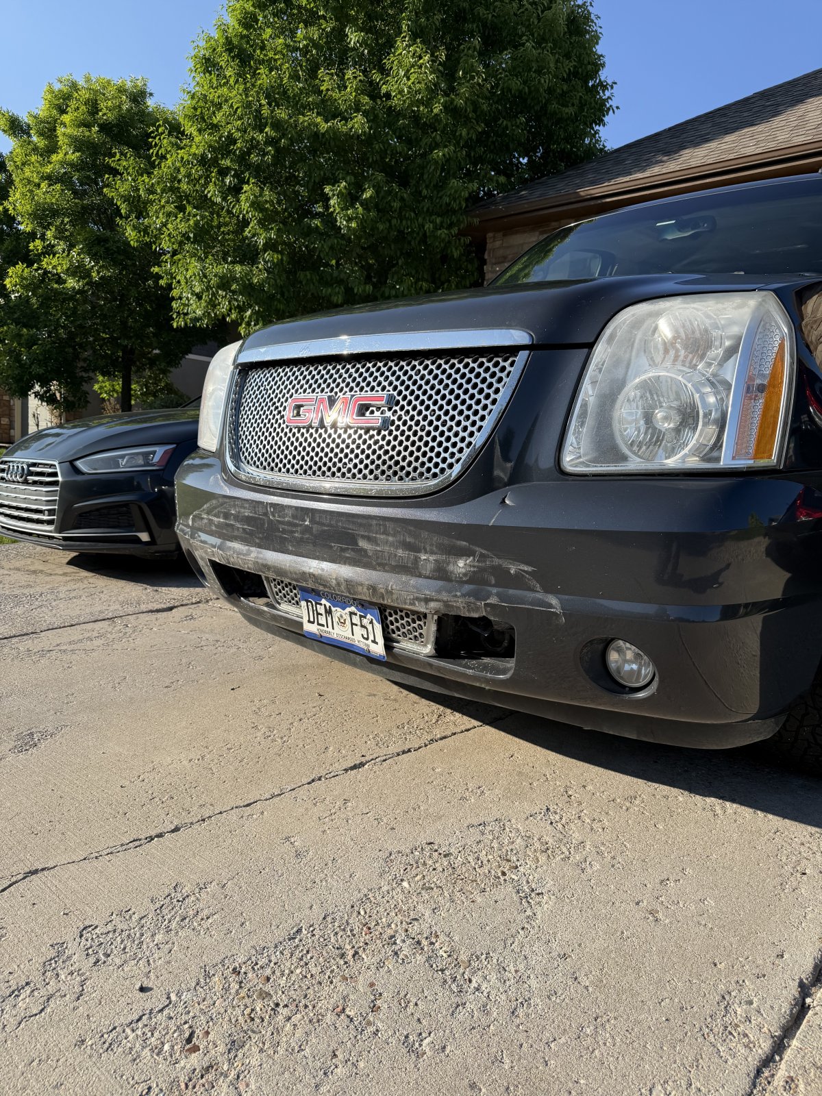

Unfortunately I rear ended a little Mazda HB the other day. Yukon is ok, but I have brake issues (was absolutely standing on them when we hit). When running the pedal stays about half way down and the brakes act like the pedal is being pushed. I can lift the pedal with my left foot while driving and it’s fine(only drove it 7mi home like this, been parked since).
I can hear a vacuum leak under the dash, but can’t pinpoint it.
Throwing 2 codes C0299-5A brake booster large vacuum leak detected
C0161 antilock braking circuit brake switch circuit
Thanks in advance for any insight
