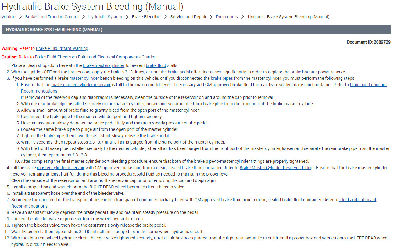

OK, but it's confusing because it says..
