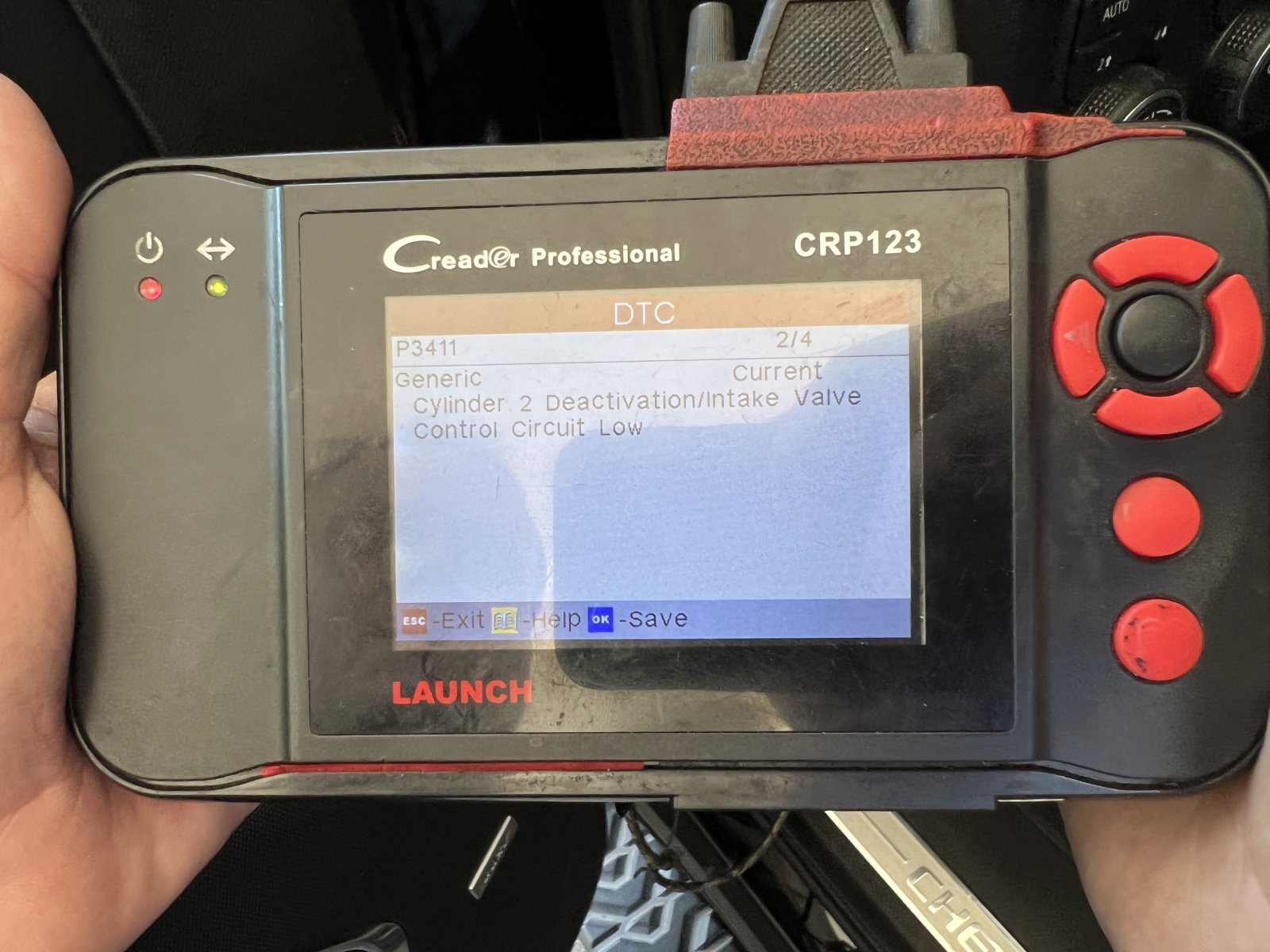

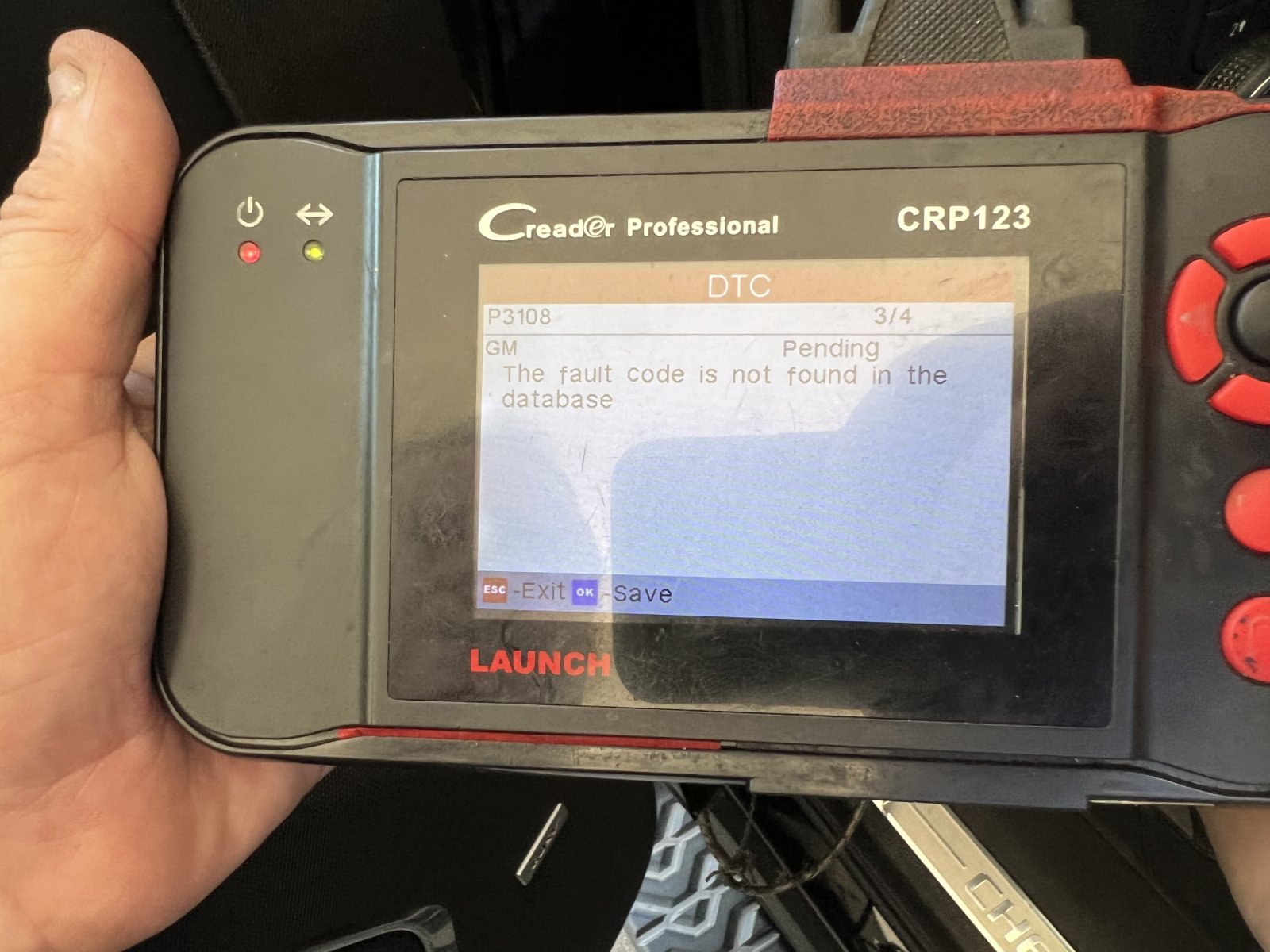

2021 Z71 Suburban that had lifter collapse, bending pushrod in cylinder 7 at 21K miles. Both sides were replaced. Check engine light just came on about 300 miles later with following codes: P3108 and P3411.
Any ideas? I am losing confidence in this truck rapidly…my fifth yukon/suburban.

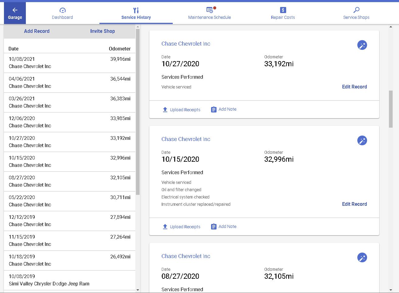

Wondering if these repairs show up on a Carfax which would devalue the selling price.

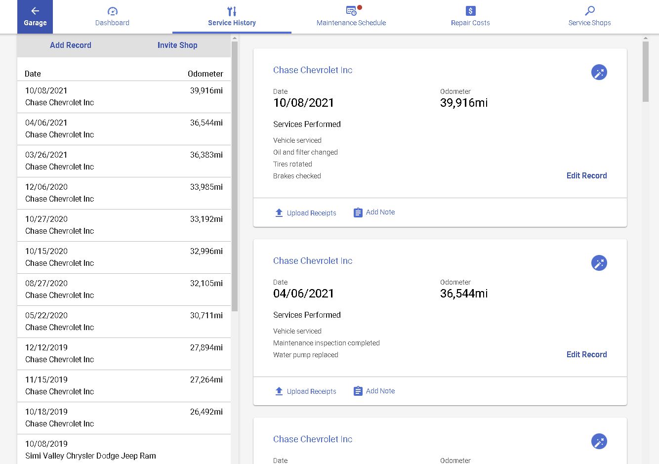

some times and other times it just says "vehicle serviced" and as the owner if you have a carfax account on it then carfax gives you the option of inputting what service was done.
for instance, it shows I had some electrical issue's so it was in & out a few times because we couldn't figure out what was going on, turned out to be a bad alternator, then the water pump failed at 36k, otherwise it would just be normal oil changes every 3k, right now I am overdue for a oil change (per my schedule). I have the option to edit the fields.
If I seen a vehicle that had been at the dealers as much as this one, I'd run like the wind even if all visits were something "semi normal". With this many visits you better start reading between the lines.....

well it has had oil changes every 3k, I don't wait 10k or whatever every one else seems to think is "ok" and I keep it maintained.
other than that it had a bad alternator and was causing a lot of electrical havoc, I could not find the cause and the dealer could not find the cause. In order to have it checked under warranty I had to bring it in while it was doing this strange behavior, the problem would happen and then not happen, so I could start it up and it would do it and then stop maybe 10 minutes later or it might do it for an hour, each time I took it in it would of course not do it, then 1 time they finally witnessed the instrument cluster being erratic so they replaced the cluster, yet it kept on doing it, over and over. After several times of taking it in and them not finding the issue I asked for a deep diagnostic (that I had to pay for) and they put there best tech on it and after a deep dive with a oscilloscope on the electrical system they finally found the cause was the alternator was sending 800mv spikes to the bcm and making it think the ignition was being turned on&off in milliseconds, if you know anything about these vehicles and how the modules "handshake" when you start the vehicle it causes all kind of problems when that handshake is not good. So that is the reading between the lines.

OP here. Dealer diagnosed it initially as a wiring harness that was not fully connected. The same error codes keep returning. Most common post fueling, which could be completely coincidental. Vehicle is back at dealer for fourth time with no clear fix.

They thought initially it was one of three wiring harnesses. All were checked and one seemed a little loose. Check engine light returned, went away, and has come back. At dealer now again for fourth time.
