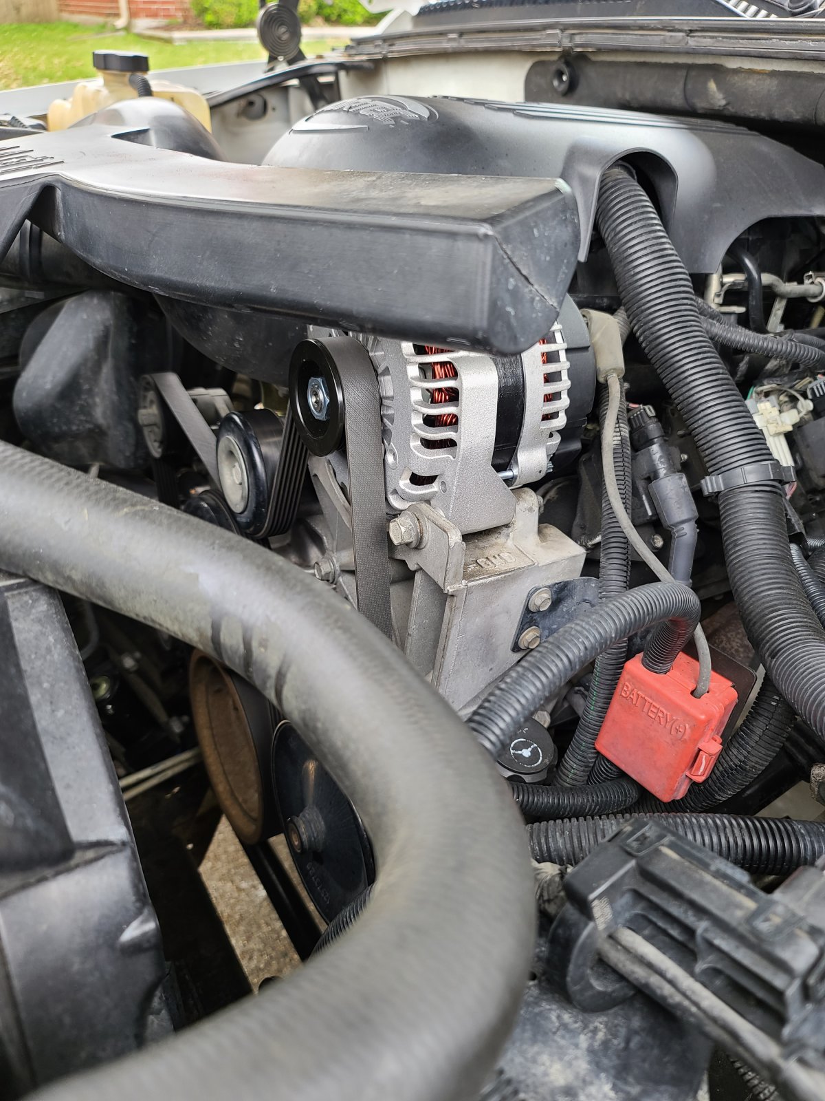

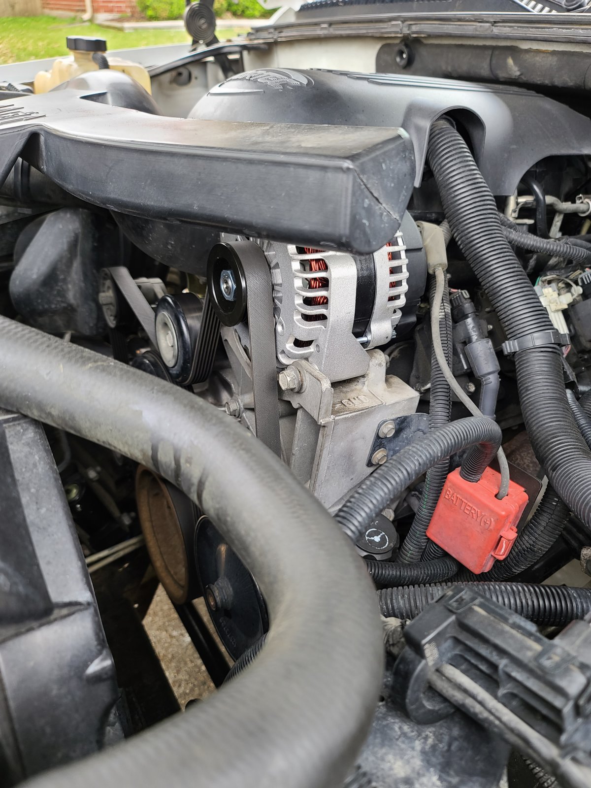

2005 Tahoe. Been chasing intermittent battery drain issue last two weeks. My girlfriend has been driving my truck. Todsy it was hooked up to my friends Snap On Zeus with his amp meter tester. We measured a drain of .05-.08 Milliamps across 4-5 hours of observation. Going home I noticed the battery gauge below 14 volts got home and multimeter read 12.5-13.5 at idle. Never went above 14 volts. So I'm leaning towards bad alternator. Might go back to my buddies house tomorrow to see what he can check with his scanner.

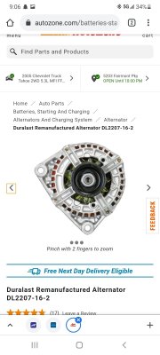

Question is: What is the difference on the Bosh 160 alternator besides the obvious case? I'm trying to buy a replacement one tomorrow from Autozone but don't want Reman.
The new one looks like this but notes indicate it's for Bosch equipped trucks.
https://www.autozone.com/batteries-...t-gold-new-alternator-dlg2207-16-2/224305_0_0

He had some probe connected around the negative battery cable and that was exactly what the snap on reader was seeing. We tried several things. Drove it parked it, blasted radio for 30 mins and turned it off, let it idle in his driveway and turned it off. All results lead to those readings after 15-20 mins of being off and scanner reading.
My main question for this thread was the alternator appearance. Mine looks like the rebuilt unit from AZ. I want a new one so I have the Gold NEW unit in the garage which has same plug for regulator but different case. It's notes say for Bosch 160 amp . Any comments on using the new unit?

About the alternators, then, it looks to me like the connector clocking is different. One is on the back of the case and the other is on the side, at somewhat different clock positions relative to the main mounting ear. No idea if they're interchangeable.

Well. I have never seen the voltage below 14 as long as I have had the truck now. That bulletin is interesting.
I also have already installed a NEW alternator from AZ and took it for a 30 min drive. Voltage was right at 14 on gauge and multimeter showed a steady 14.6-14.7 at idle.
Also when I reconnected my negative with new alternator installed there was no spark like before with old alternator. I had disconnected negative cable several times when I removed starter, took battery for a recharge, etc. Something internally wrong with old alternator maybe.
