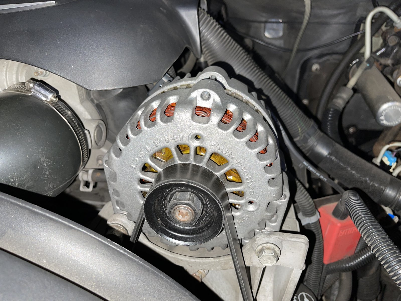

So what replacement alternator is everyone going with.Im noticing my lights flickering slightly and gauge fluctuating at idle and sometime dragging down idle when fluctuating.Leading me to think alternator is going out.Oe price was 393.00 delco 200 and car quest 177.Im leaning towards the ac delco reman.145 amp-alt on it now says delphi.Battery is 3 months old so im leaning towards alt even though it showing 13.5 volts when it drags down idle goes to 12.5-12.8 then back up.Grounds look good JUst called my local chevy dealer they said only reman ac delco and price is 575.00 f that.

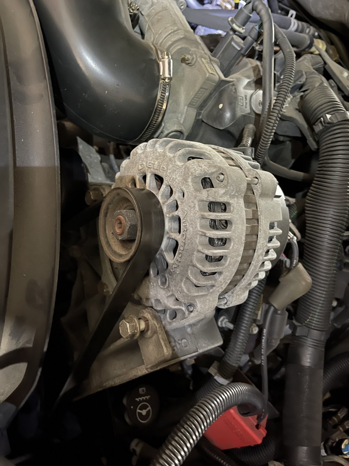

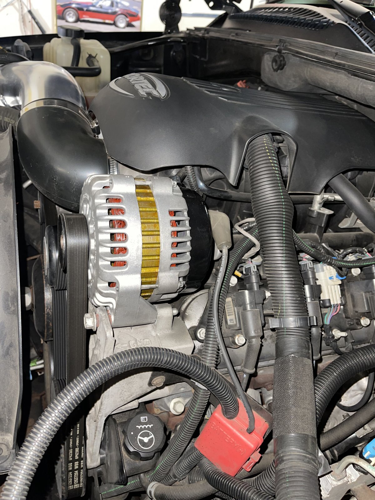

So i remembered a place close by that has been in business for over 30 yrs-that used to do my alternators and starters.He said bring it by.He guted it replace every part inside and new bearings.Said a bearing was bad and took out the regulator hitting it.2 yr warranty 120 bucks and it was the original alternator.Also got to marker my fuse box think it looks good and engine cover also.Also ordered a new tensioner and idler for good measure.

What does he use to clean up the case? That looks great!

You lucked out. I havent seen a starter and alternator rebuild shop in decades. They were really common in 70's and 80's. It was a easy and very affordable deal to get one rebuilt back then. Most of the shops would have your unit back to you by the next morning at the latest! Those days are gone it seems. And they actually stocked parts then too!

Yep he moved 1 mile out of the way so i forgot he was still in business.Gave it to him at 11 am called at 3 said come get it.He had 18 to do today very busy.145 amp 120 bucks 220 amp upgrade 200 and some 330-340 amp for super high end radio system for 350.Every part is changed except the case he says.They now powdercoat stuff also- interesting stuff i seen in the shop.https://www.facebook.com/dustysdcelectrical anyone in my area that needs any starter or alternator or about anything electrical these guys are great.

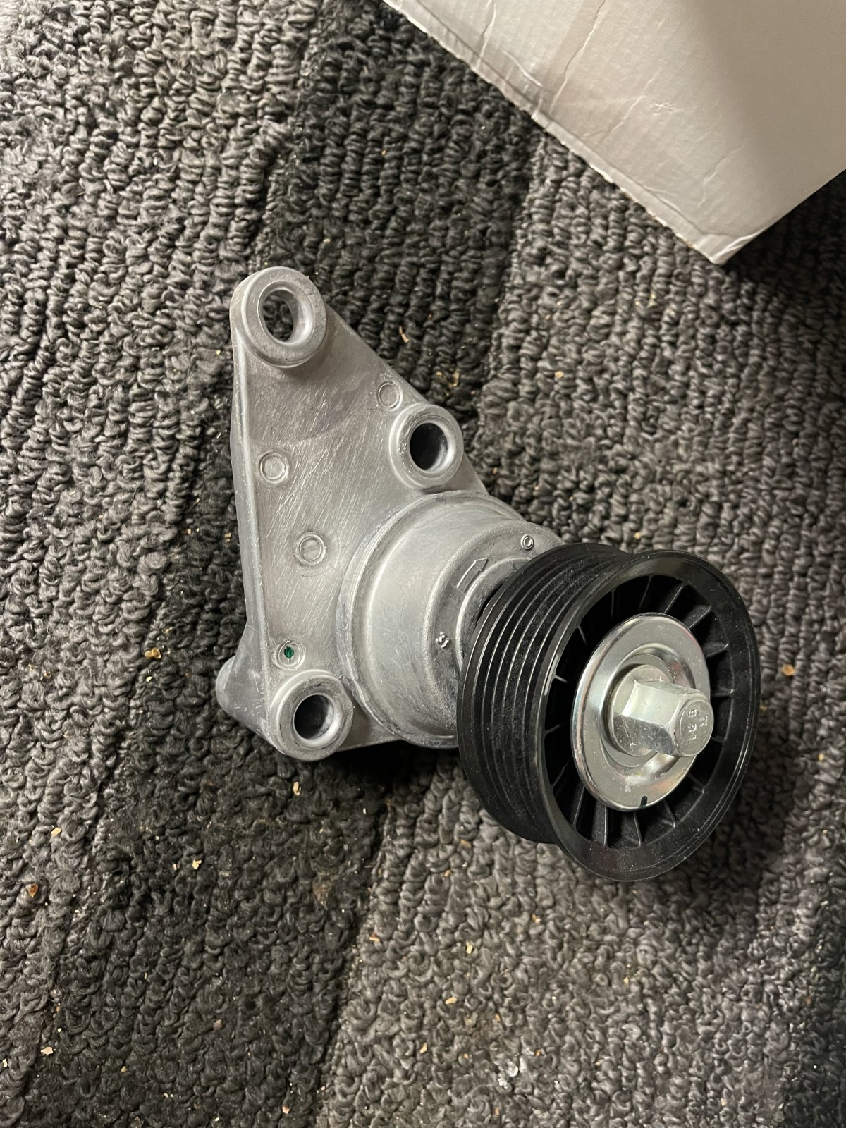

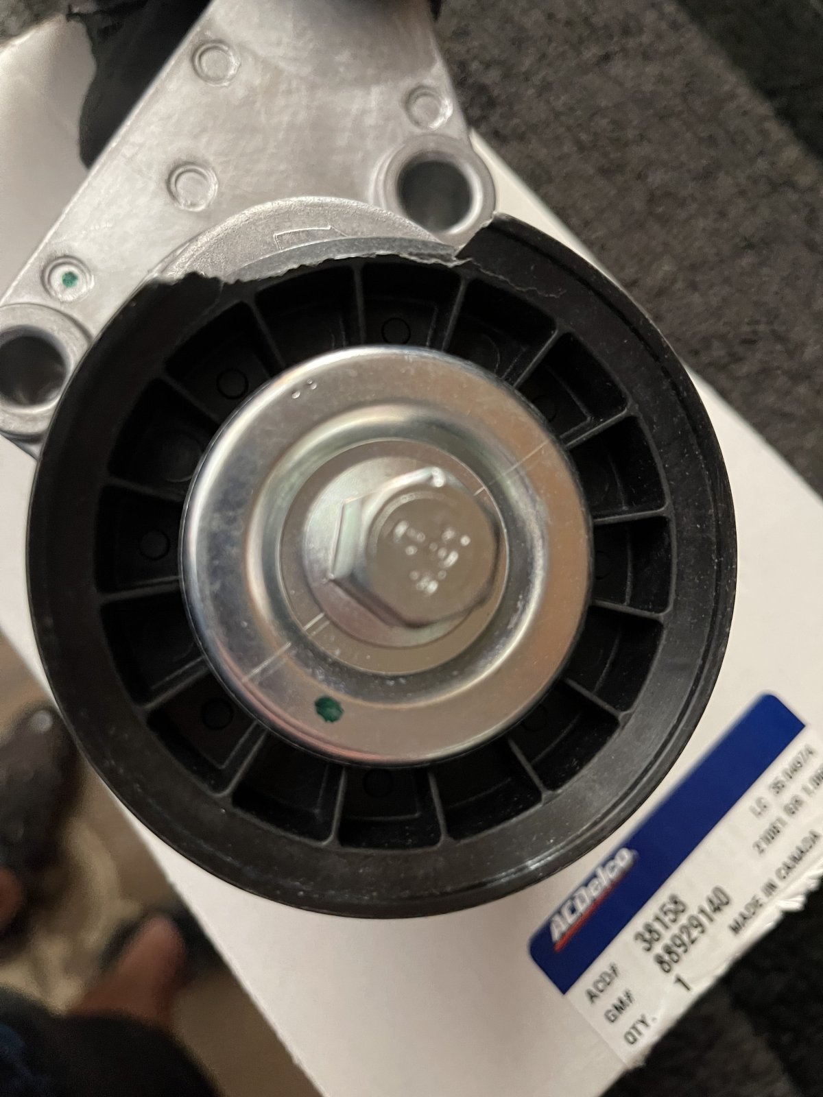

My tensioner and idler came in today was ready to install open the box and wtf.The piece that is broken is not in the box either so it was pkg this way and shipped

Finally got one that wasnt broken all done.Amazon no fuss return policy and they deliver on sundays.Told them part was broken in box friday after noon arrived by noon today.
