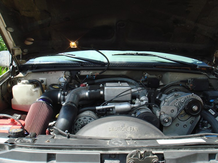

To make room for the Twins, I sold a complete Vortech blower kit, from my 95 Tahoe, for $500.00.
It only had a couple thousand miles on it and it was in perfect condition.
It helps if you have fabricating skills, if you are going to piece a blower set up together. :)

It is said to expect 400 crank hp to be supported by the L31 injectors. This is consistent with either the poppets or the mini injectors.

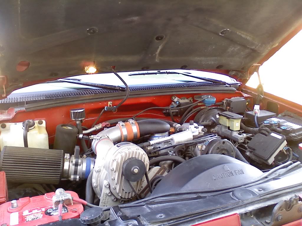

Like mentioned above, why not look for a deal on a used kit? I would think that with the economy in the toilet, a few folks would be selling off toys and they could be had for much cheaper than the original cost... I bought my Powerdyne kit from a buddy for 1800.00 , and it was only a week old :mexsmoke: He needed cash ASAP for an emergency and I made the best of the situation... LOL
