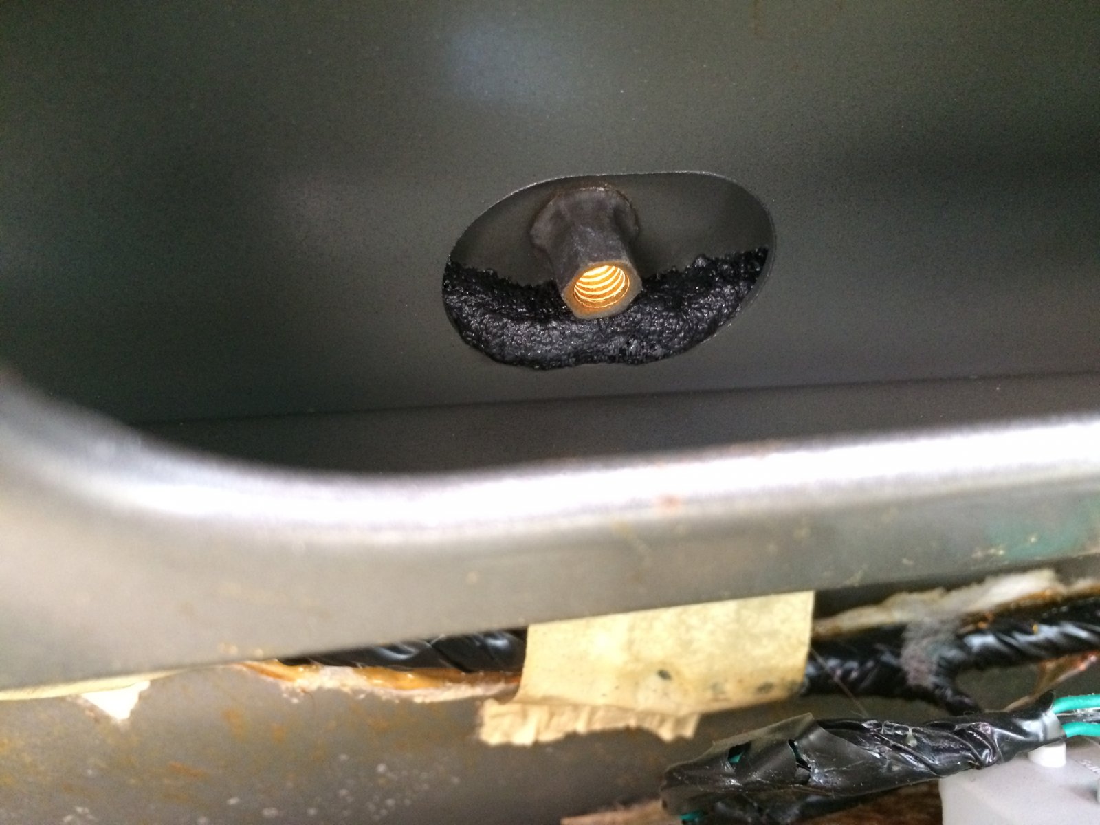

If anyone is wondering, the Nutserts on a NNBS are definitely NOT blind nor do they tie into anything structural.
I found an '07 Avalanche (Graystone, coincidentally) with the roof rack already removed. I pulled down the headliner near the driver's door and this is what I saw:
That's sunlight shining through the surface-rusted threads.

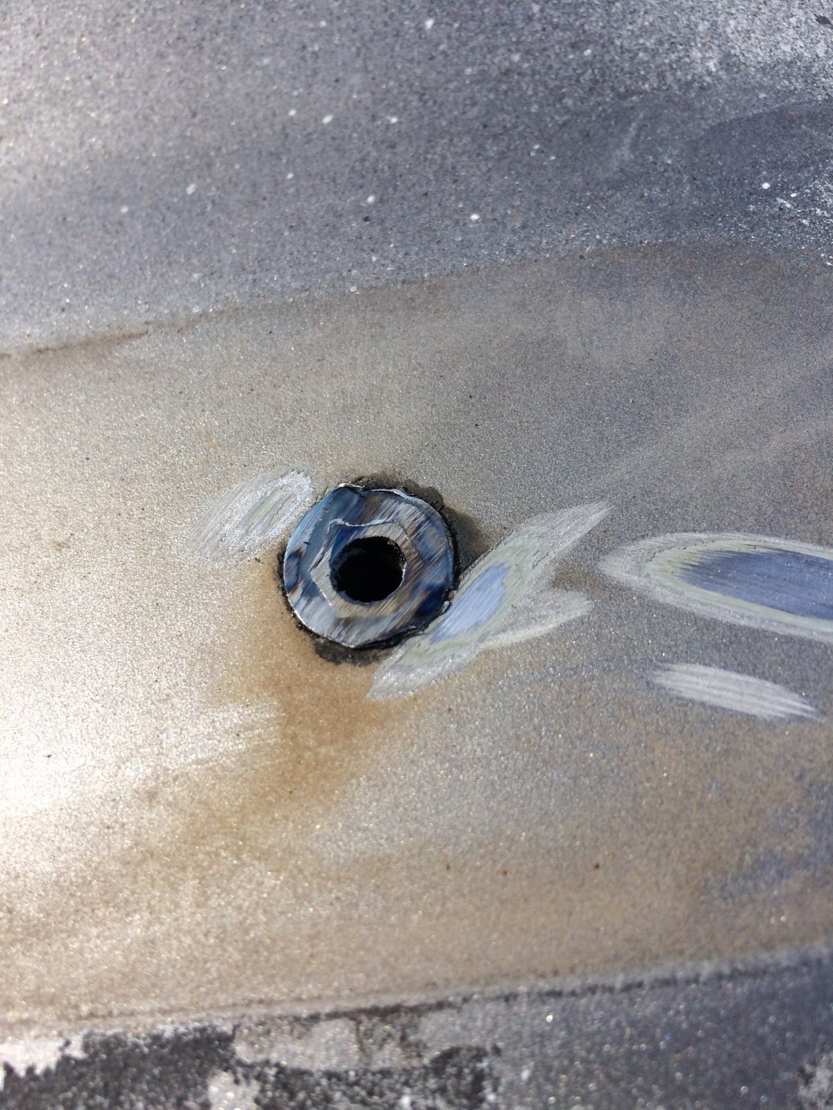

I ground the flange almost all the way through to see if I could do it without damaging the roof metal:

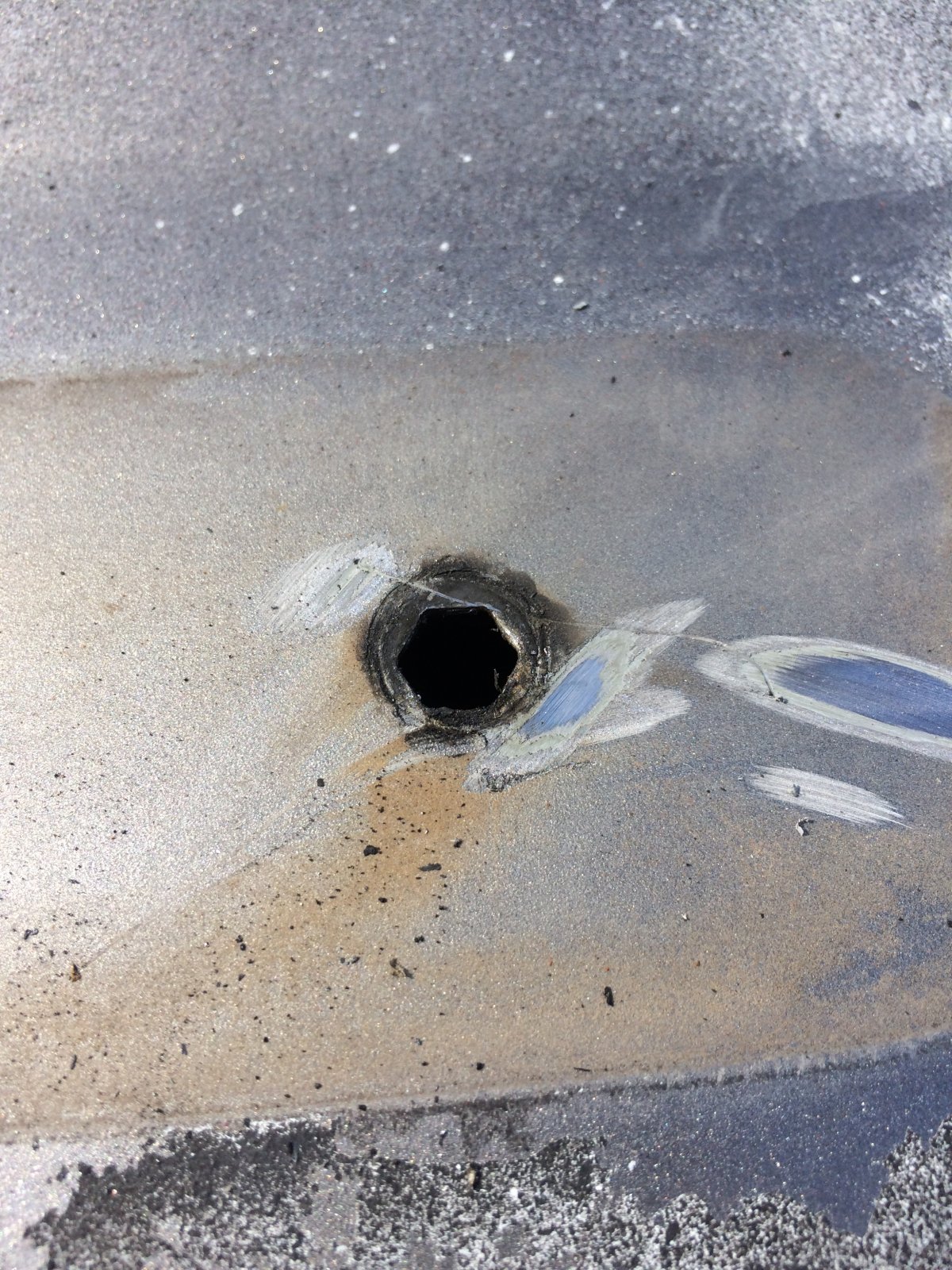

After prying the flange off with a small flathead screwdriver, the rest of the Nutsert fell inside, leaving this hexagonal hole:
So, it's an all or nothing deal. Make the roof rack removal permanent or cover the Nutserts with molding. Looks like I'll be ordering molding in the future.

I was quite surprised as well. The roof skin is adhered to and supported up off of that inner boxed frame with the black foam stuff you see in the first pic. I could flex the roof slightly by pressing on it. Judging by how hard I had to press on that one spot for it to flex enough to be seen, I'd say it could easily support 100 lbs. on that one side if all three points were bearing the load. So, 200 lbs. evenly distributed among the whole rack seems realistic.

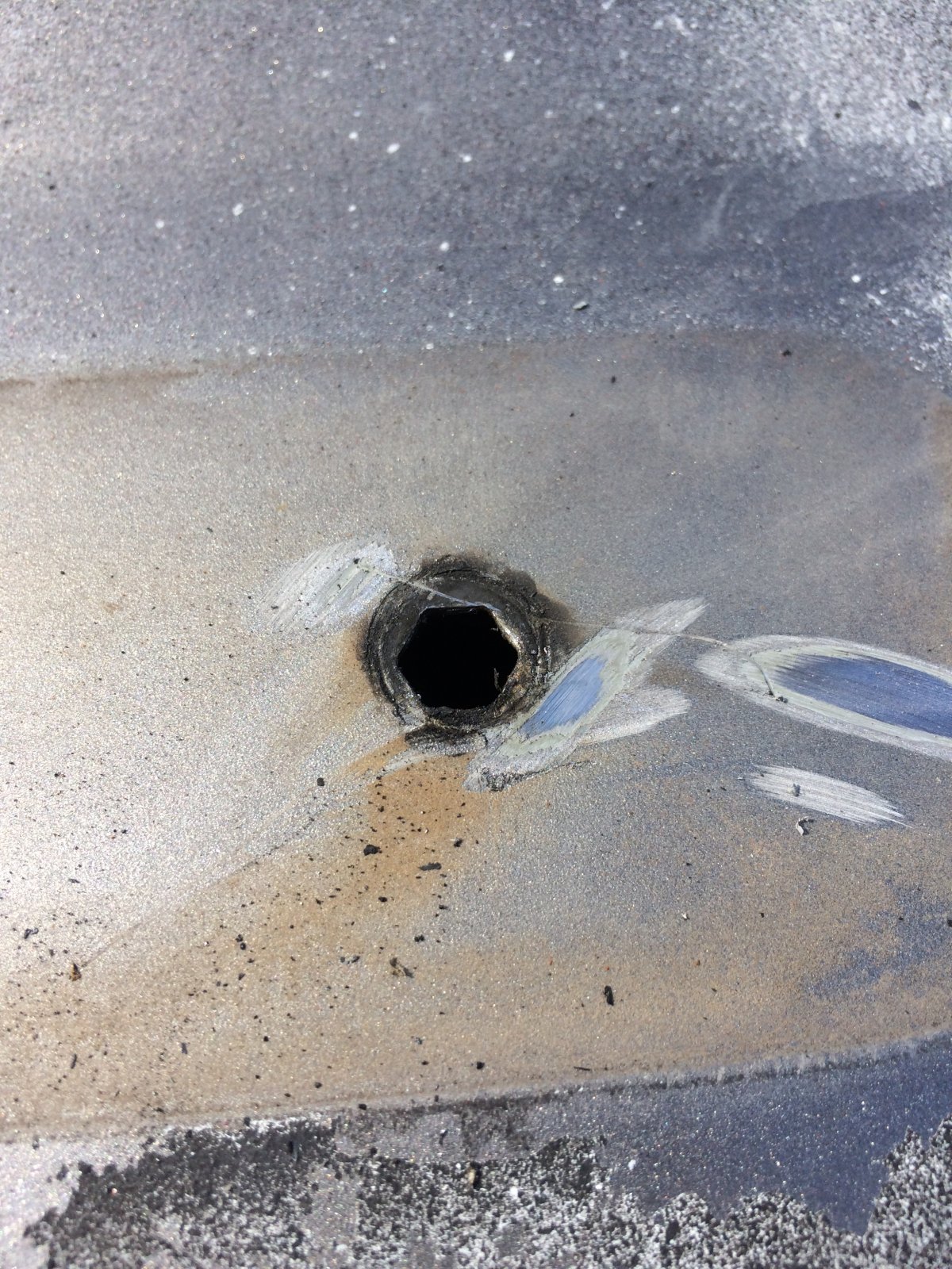

Did you use a grinding wheel or a flap disc?
