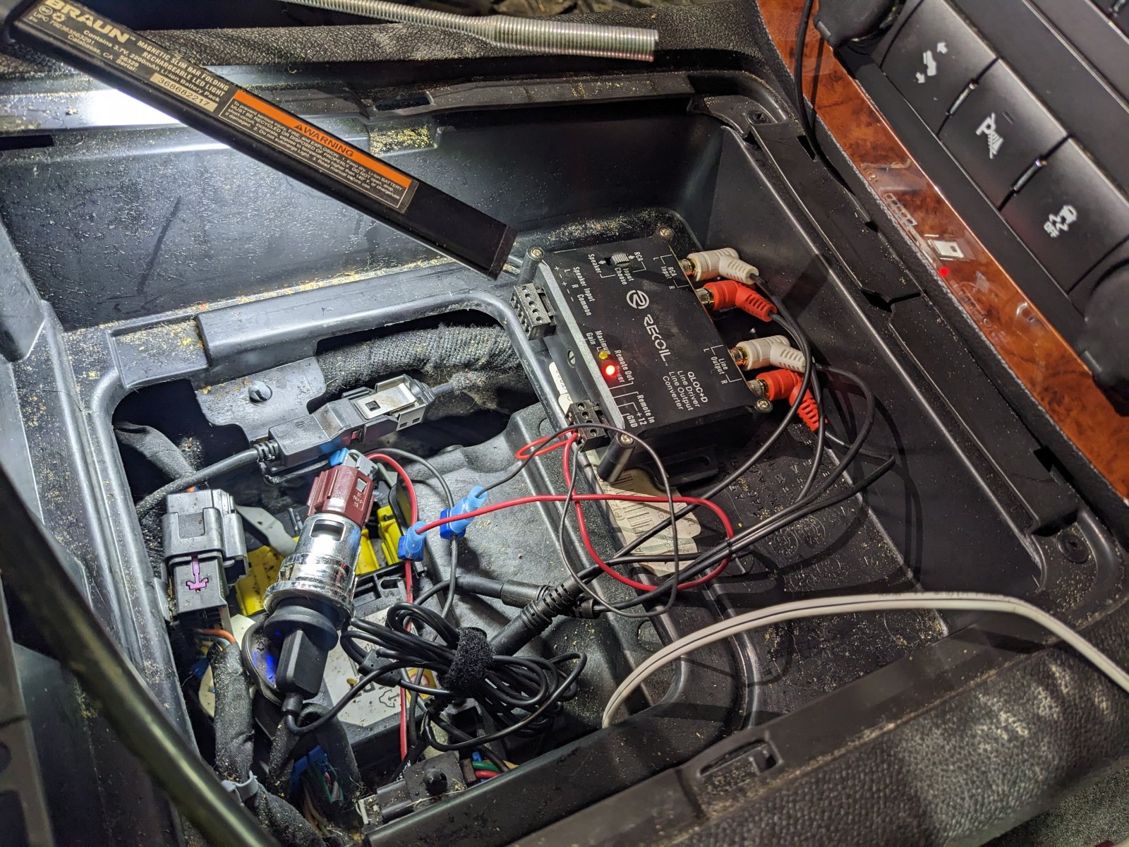

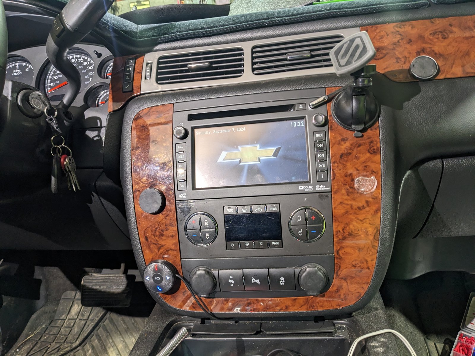

I used this with the appropriate cables. On my 08 I had an RCA cable to the rear audio/video input. My 13 doesn't have RSE so it goes in the front aux with a that right angle cable. Get the appropriate adapters for your application. Set the gain where you want it just be careful not to distort. The clip led on this comes on a bit late.
Coolman1987us
Aug 8, 2022
152
177
Maine
Fits perfect under the center cup holder insert. Just needed to run a 12v outlet under there for power.
