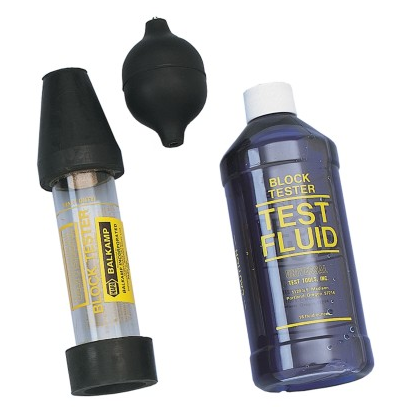

Do you get white smoke on start up? Does your exhaust smell sweet? That would tell you if you're getting coolant into the cylinders. It could still be a head gasket, or even the head, depending on where the head cracked. What casting number do you have, 706?
Moderator
16,633
34,432
People's Republic of Colorado
If you decide to do some testing, buy or rent the tester that will look for combustion gasses in the coolant. Here's one from NAPA, but every decent auto parts store will have one to rent or buy.
