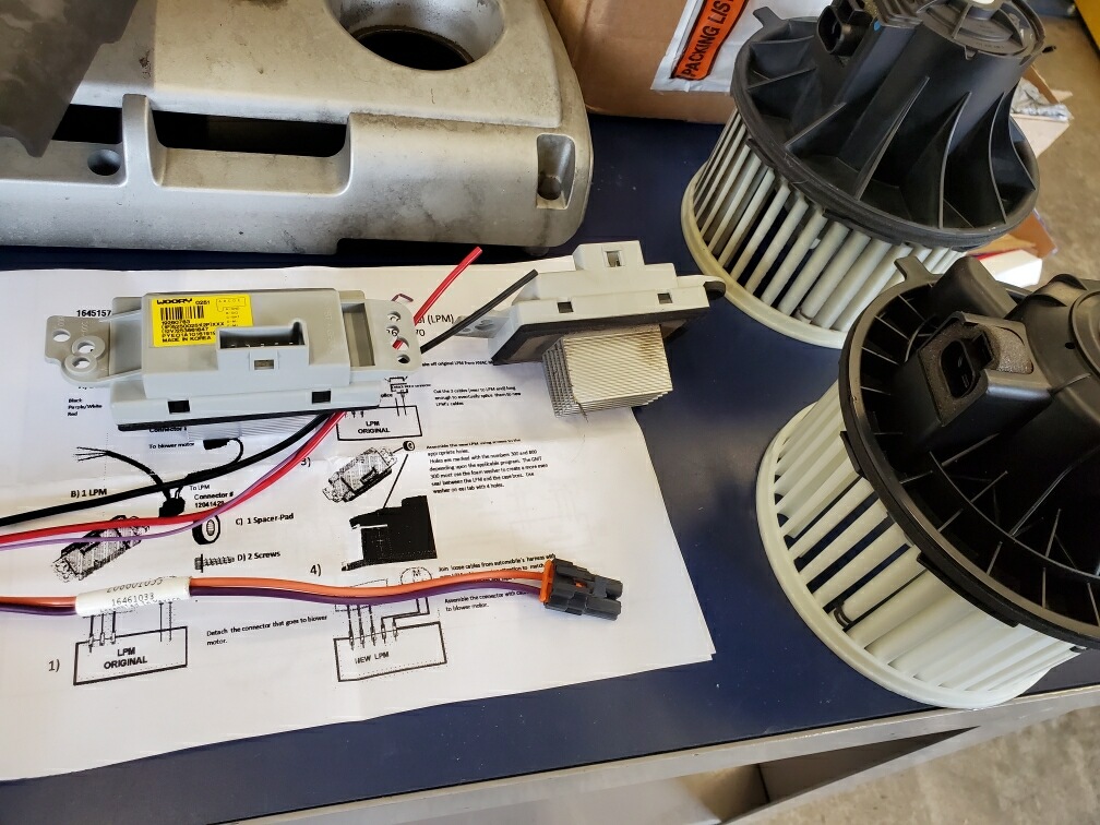

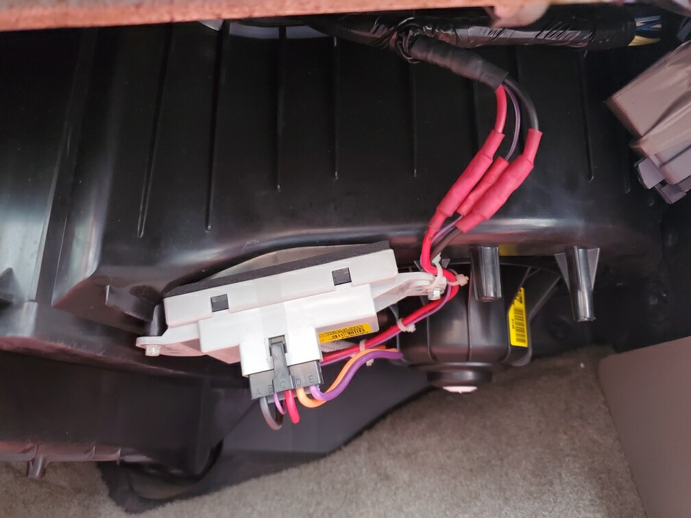

I recently did this replacement on my 05 and did find connection problems that had not caused a failure yet but would have soon.

When you say "relay" do you mean the blower motor resistor by the blower motor, up above the passenger footwell?
Good call, I just assumed that it is the resistor which is a known problem area.
