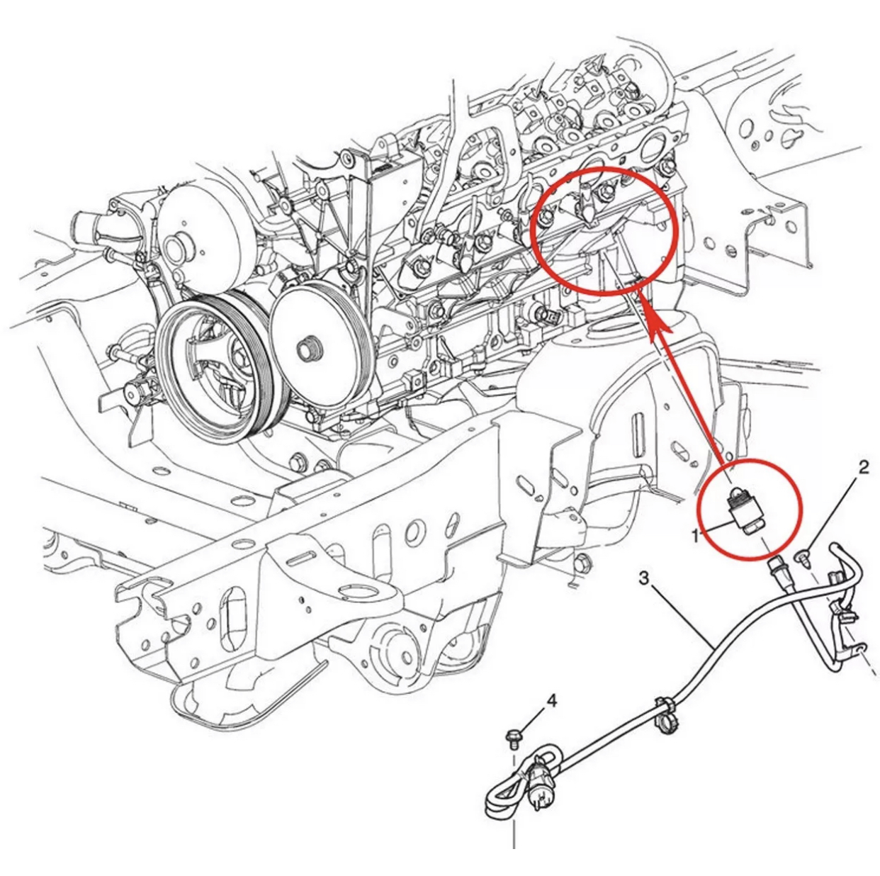

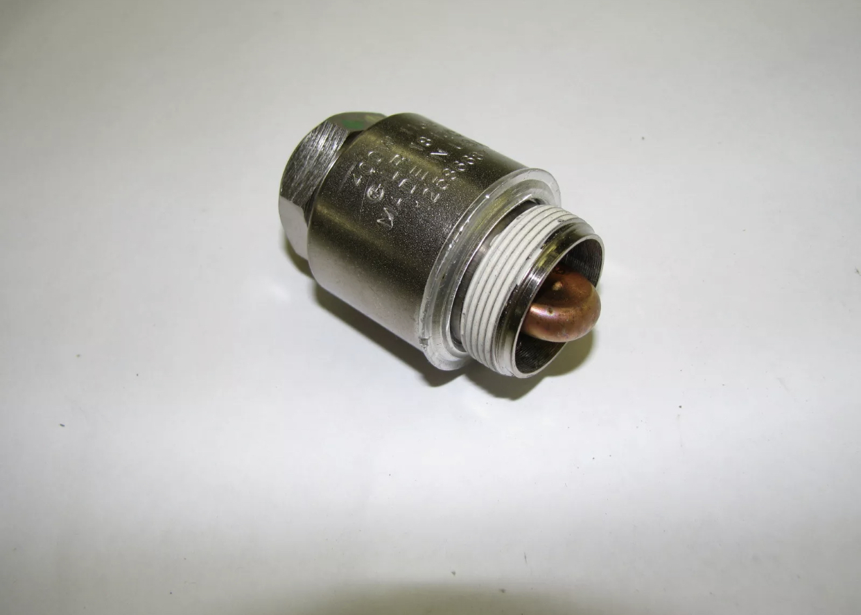

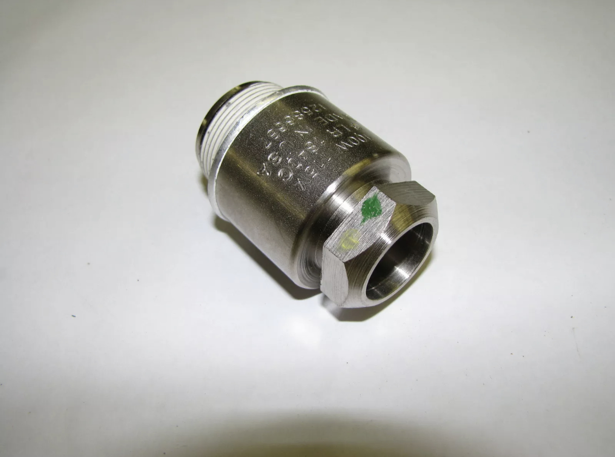

Tired of cold rig. Had a heated garage last 2yrs and forgot how much I hate dealing with the cold and waiting on rig to heat up.
Found these parts and looks like it’s a simple plug n play install. Can someone confirm?
Block heater element
Part #12586687
$32

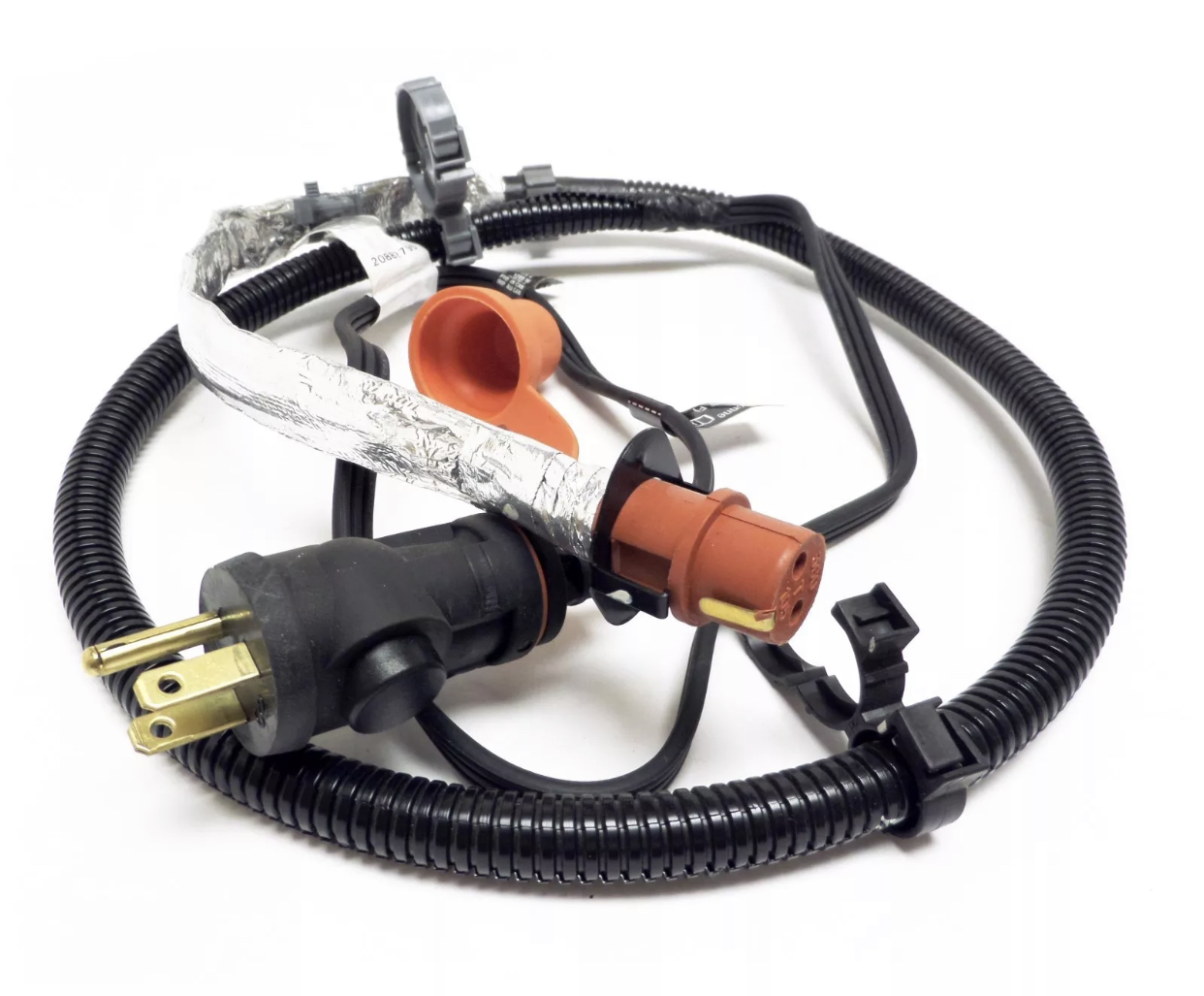

Block heater cord
Part #23242087
$25
For <$60 I feel this is a very worthwhile addition. As long as I get the correct parts and it truly plugs right up.
30,744
48,427
yes just plug-n-play, sometimes if your lucky it's already there, they just hide the wire and you have to look down there in that location and see if it is there already or not.

Yep it's PnP
Though I think it's worth noting: This doesn't preheat your block. Only stops it from getting too chilly. You won't have instant heat. If you want that, you'll need to look into a circulating preheater, which will typically splice into your heater core hoses
